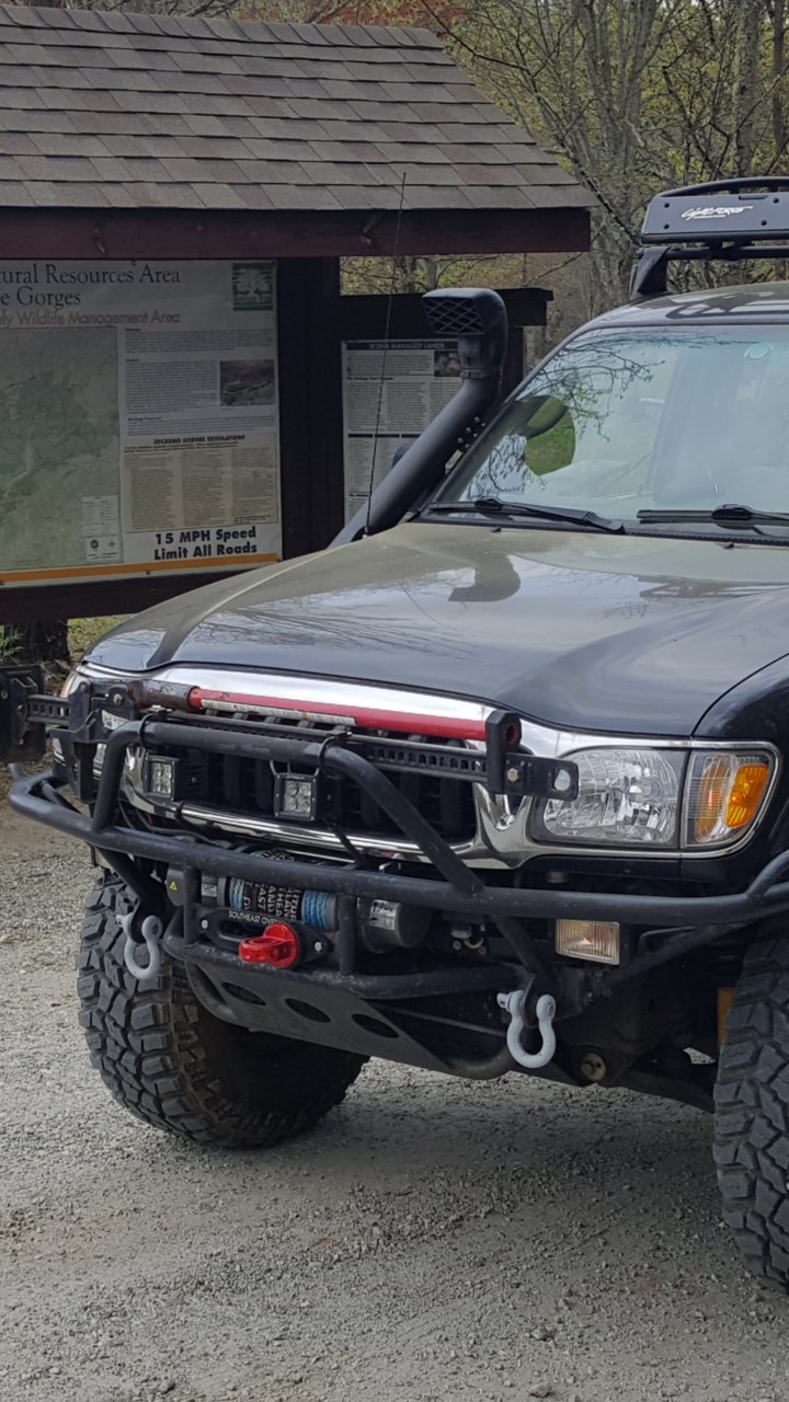

    Why don’t you just cut the rope and splice on Factor 55’s Splicer or Flat Splicer model?
  7. May 30, 2018 at 10:04 AM
    Matic
    Matic The "OFG" Baby!!!
    Sep 8, 2009
    #22436
    26,681
    Tricky Dick
    Easley, SC
    1 owner 2002 TRD, SR5, DC, 2.7. Full OME suspension, STT pro's.
    OME 881 coils with OME nitrochargers shocks up front. TC UCA's OME Dakars with extra leaf in the rear. Warn 8000 winch with 80ft custom braided synth line. Custom 60ft synth extension. All pro tube bumper, Hi-lift jack, Safari Snorkel, Wilco tiregate. 2019 Jeep JLUR.
    Factor 55 thimble and custom length rope.
    Courtesy of "Southeast Overland".

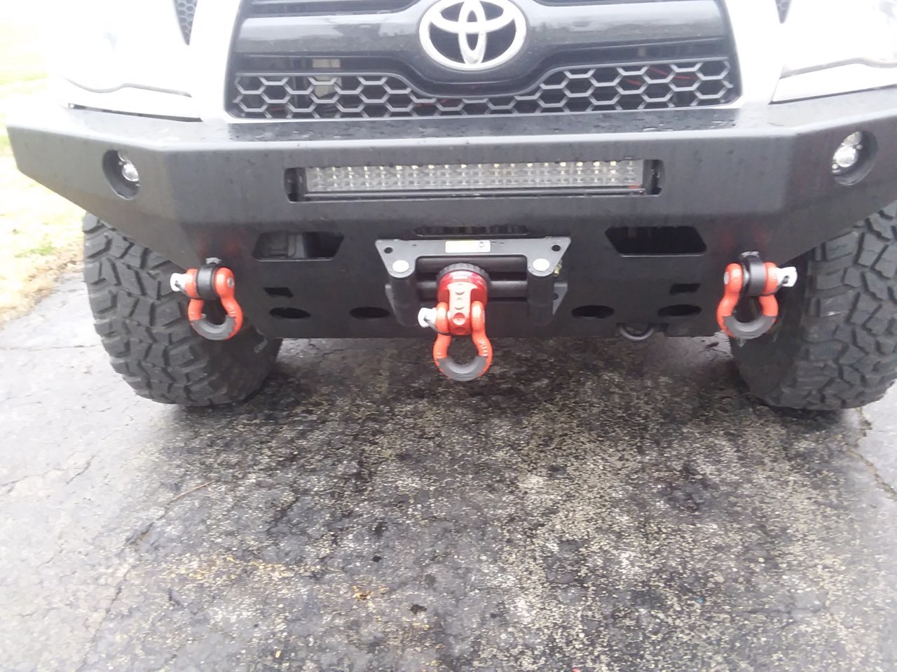

    I tried the F55 thimble. Straight forward enough until I had to use it in -5 degree weather. Hooking up with a shackle and heavy gloves proved more awkward than anticipated. Now using Warn Ultimate hook. Much happier. Not to mention much WARMER!
    Also went to synthetic capable roller fairlead. Less wear and tear on line. 20180306_102609.jpg
