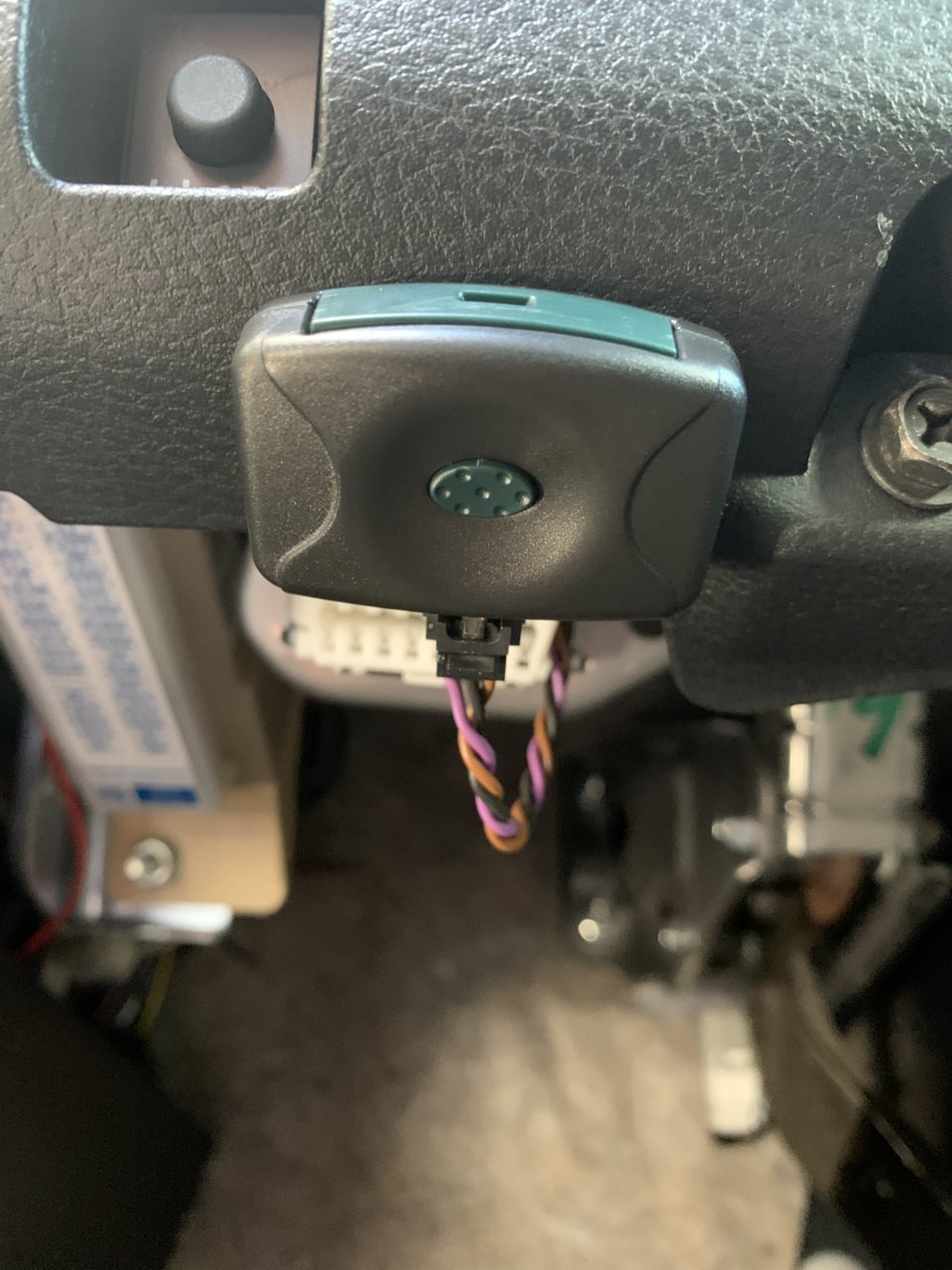

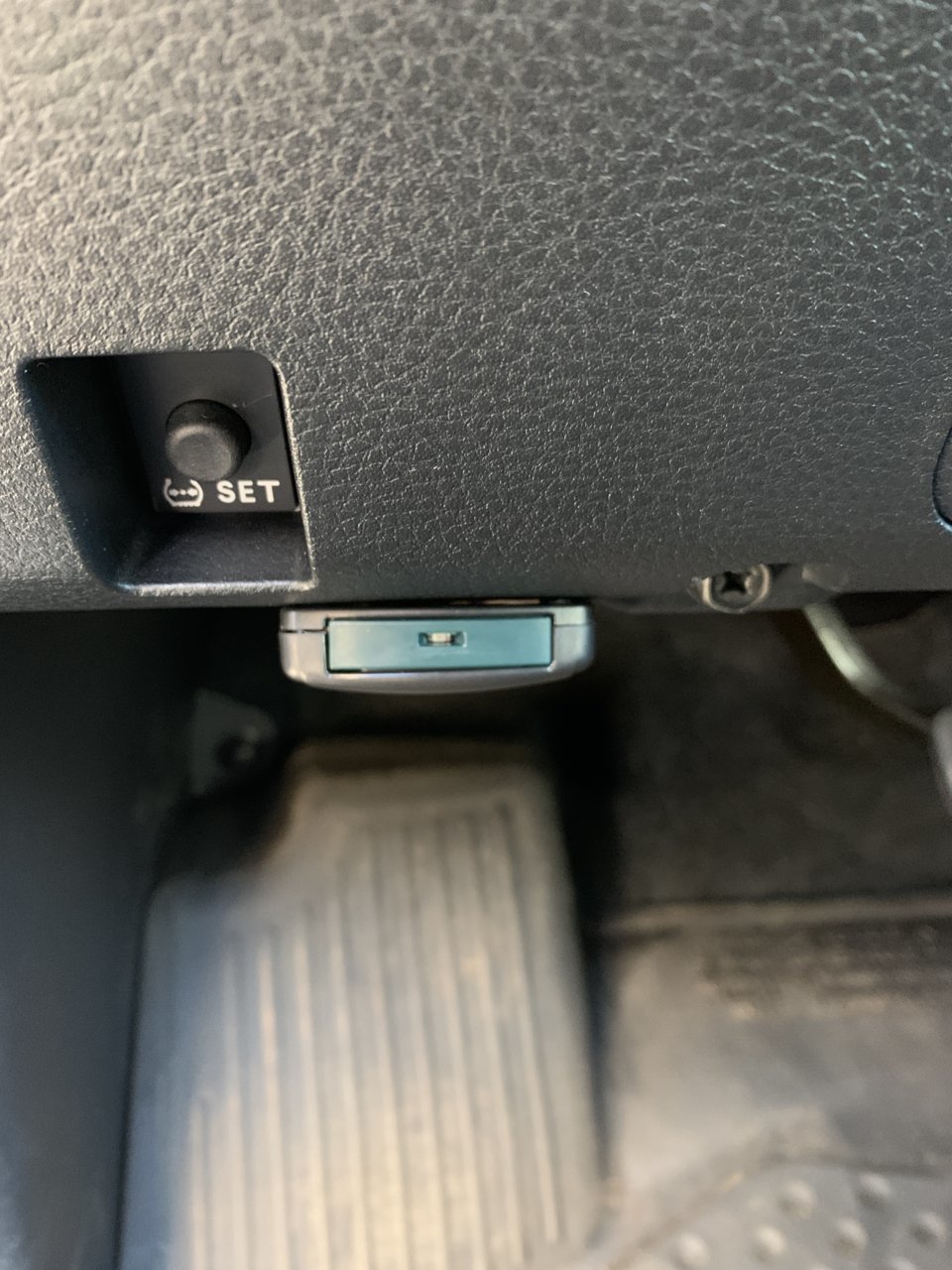

    I've run into this twice now. 1st time was camping, figured the trash bag on the floor shifted or something, kinda shook it off. Then this morning I woke up to the familiar annoyance and realized I was the jerk neighbor that had an alarm going off at 5am! Sorry neighbors!
    I found a contact number for the alarm company (Karr/SWDS) Customer service was awesome, she stayed on the phone with me and walked me through the instructions.
    I did my best to remember them:
    Unlock vehicle
    Open driver door
    get in
    close driver door
    cycle ignition to "on" (2 clicks of key, or 2 pushes of start button)
    Turn ignition off
    open driver door
    close driver door
    hold valet button for 5 seconds. (horn will chirp once)
    number of flashes from green light shows current sensitivity setting (1-10)
    Mine was at 5​
    press valet button equivalent to the sensitivity you want to set (2 pushes for level 2 etc) 1 is low, 10 is high.
    turn ignition off
    open driver door
    close driver door
    *At some point after resetting the sensitivity I got another horn chirp, but I forget when it was... I think after i closed the door to finish the cycle?
    Hopefully this helps!
