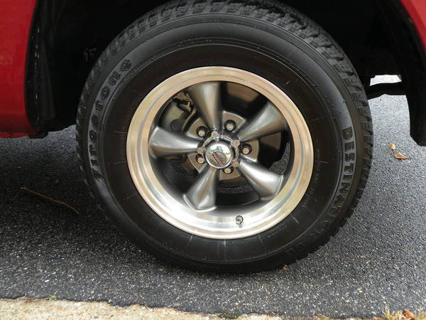

    Take a look at my pictures ... American Racing Classic 100s ...

    What pictures?

    I was on my cell ... click on the little camera next to my name ... or ...
