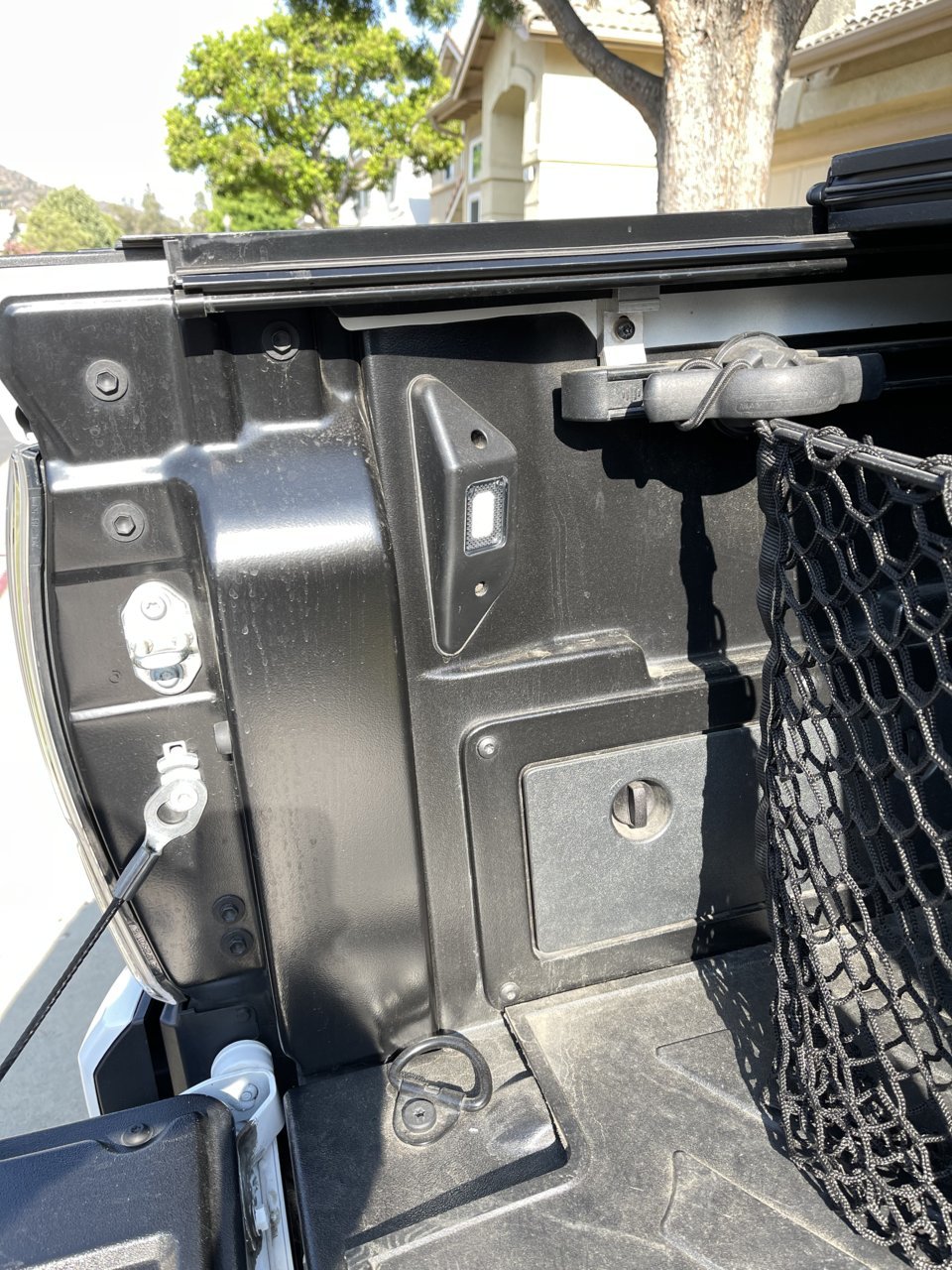

    If you were starting from scratch with an install, then yes. However you'll still need to wire and install a dash switch for the lights, which isn't hard if you're not pre-wired but is a factor.
    If your truck is set-up plug-in-play for the stock bed lights, that's the route I would go. My '20 was pre-wired and install of the lights took less than 30 mins. I've been very impressed by the light they put out as well!
    Below is a shot I took at night with basically other light source other than the lights next to the center taillight and the bed lights:
