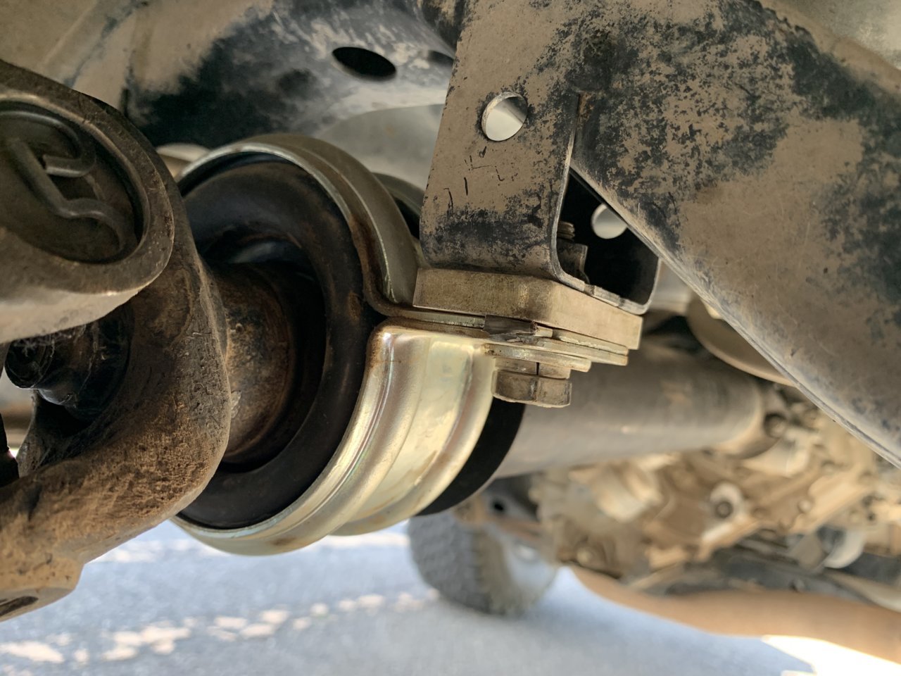

    Does this exist? I honestly don’t remember it being a part of my OME kit, but after a mechanic recommended getting a drop kit to cure some recent driveshaft vibes I took a look underneath and lo and behold…
    So what would you do? Take it out and see how it feels? Add some washers to it? Mix n match until it feels right?

    That is the OME carrier bearing drop kit. Id leave it unless you are having vibes
