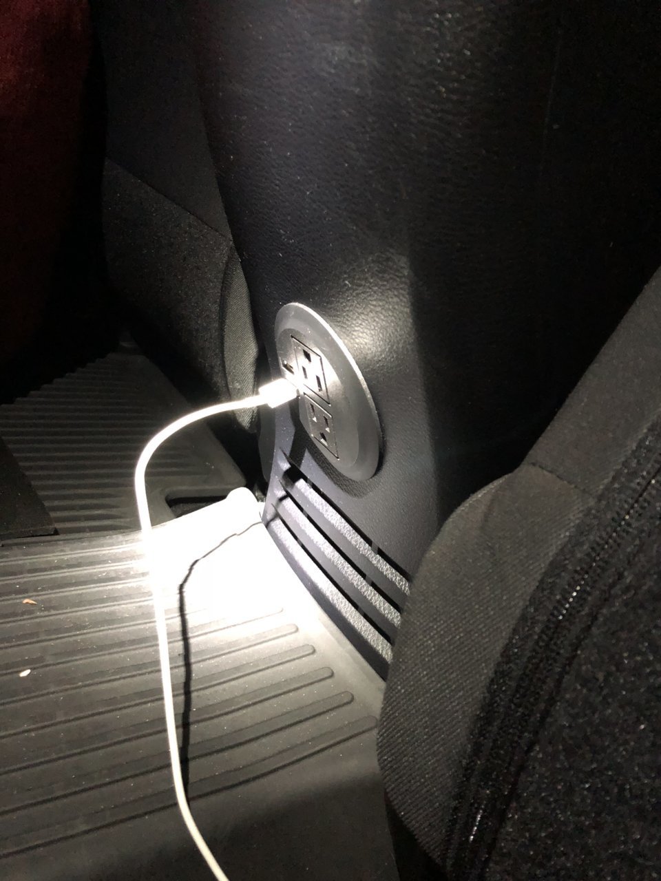

    I see the ones that transform the cigarrete lighter inside the center console, but what I have is 2 usb charging ports in the rear of my center console, facing the passengers.
    Kinda like how people do the 400w ac outlet in cab mod? Or does that only work in the trd sport due to the existing connections?

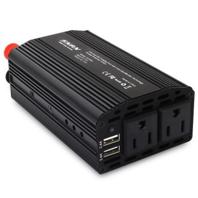

    You can fit a 400W inverter right there under the center console. That’s where Toyota puts them. You’ll need a 10awg wire to the battery with a 40A fuse.

    I don't have the bed outlet sadly, it's an sr5.
    The dual usb from factory is a little bit above the pic you posted.
    I'm guessing I would need some sort of 12v to 120v inverter then can't just use the existing connection.

    The easiest thing to do is get a 400w dc to ac inverter and wire it directly to the battery and run into the cab (with 0/1 ga welding wire). Put a 40amp breaker near the battery.
    It’ll have a couple 20amp fuses already in it, has an on off switch and you don’t have to cut into stock wiring. They’re really inexpensive.
