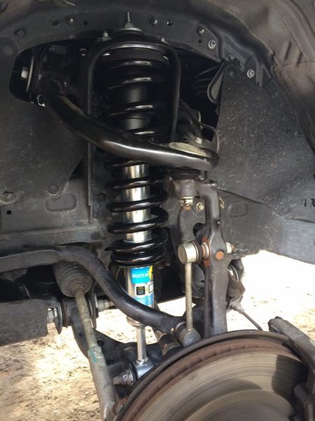

    Since you're already running 5100's, you can purchase OME(884/885/886) springs and set your bilsteins at .0. You'll get about 2.5' lift.

    Jeff is right. I have OME 885x's and 5100's at 0 and I did get 2 1/2.
