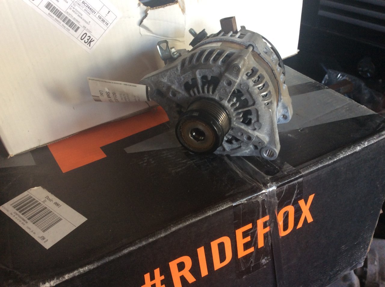

    Pulley info will be deleted shortly! Bad cross reference showed 6 rib on some of the larger alternators. These alternators come with a 7 rib belt.
    Here are the brief early musings of upgrading the 2GR-FKS to a Toyota factory original 180 amp alternator. Several late models of Toyota and Lexus that also utilize the FKS version of the 2GR are equipped with this unit. What makes it appealing is that not only is this available as a brand new OEM built piece, but that the unit is contained in the next larger size alternator series. Everything is larger in order to deal with the increased output, it's not just a hot rodded small body.
    The Highlander and Sienna will likely be the main sources, though there is another I need to look into. The part number for this unit is 27060-0P420. Used units run from $100 - $200, and new can be sourced for a bit above $600. The piece I sourced came with an six rib overrun damper type pulley. It will, obviously, need to be swapped for a 7 rib pulley. I will supply part numbers for OEM and aftermarket pulleys as they are verified. Two other differences exist between this 0P420 and the smaller stock 100/130 units that will prevent a straight bolt in. Fortunately, they both extremely minor. The first is the mounting bosses for the factory wire harness, a small bracket should suffice here... and second is the angle at which the wires connect to the alternator. Stock wires mount straight into the rear, the 0P420 take the wires at 90 degrees. It appears as though the wires have can the insulating tape removed in order to reposition for proper connections.
    More info and pics to come. For now, here is the 0P420.

    Happy to share and glad others can benefit. As far as I'm aware, the NON tow package equipped trucks have the smaller 100 amp unit.

    Food for thought. The 180a sienna alt uses 27415-0P030 for the pulley and has a clutch built in it. Looks like it screws on to the rotor shaft.
    Our pulley 27411-31210 sits on the rotor shaft with a nut on the front holding it in. No clutch built in the pulley.

    I would go with the OD style pulley. It was designed originally with the 180a alt. I think it even has a torsion spring on the inside that is supposed to absorb engine vibrations that help prolong alt. and accessory drive life.
