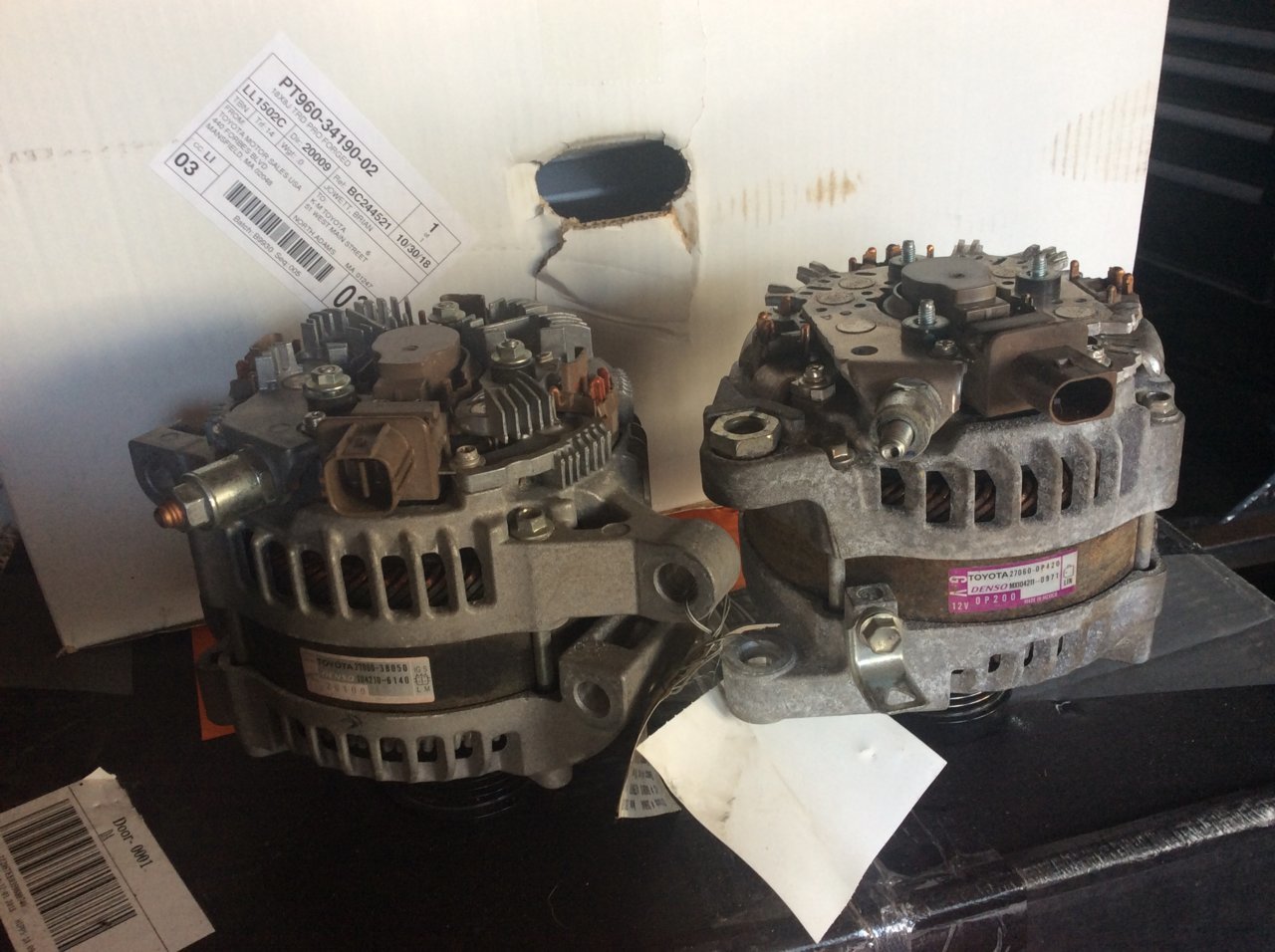

    Finally moving forward on this again. Pricing on the Sienna 27060-OP420 has come down to earth... new units can now be purchased from Toyota for a pinch over $300! Nice. I also have another Japanese built alternator of higher build quality to check out.

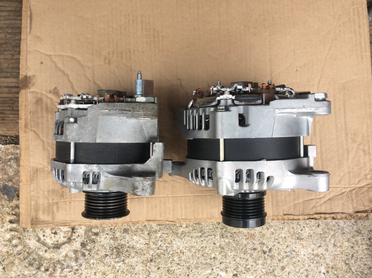

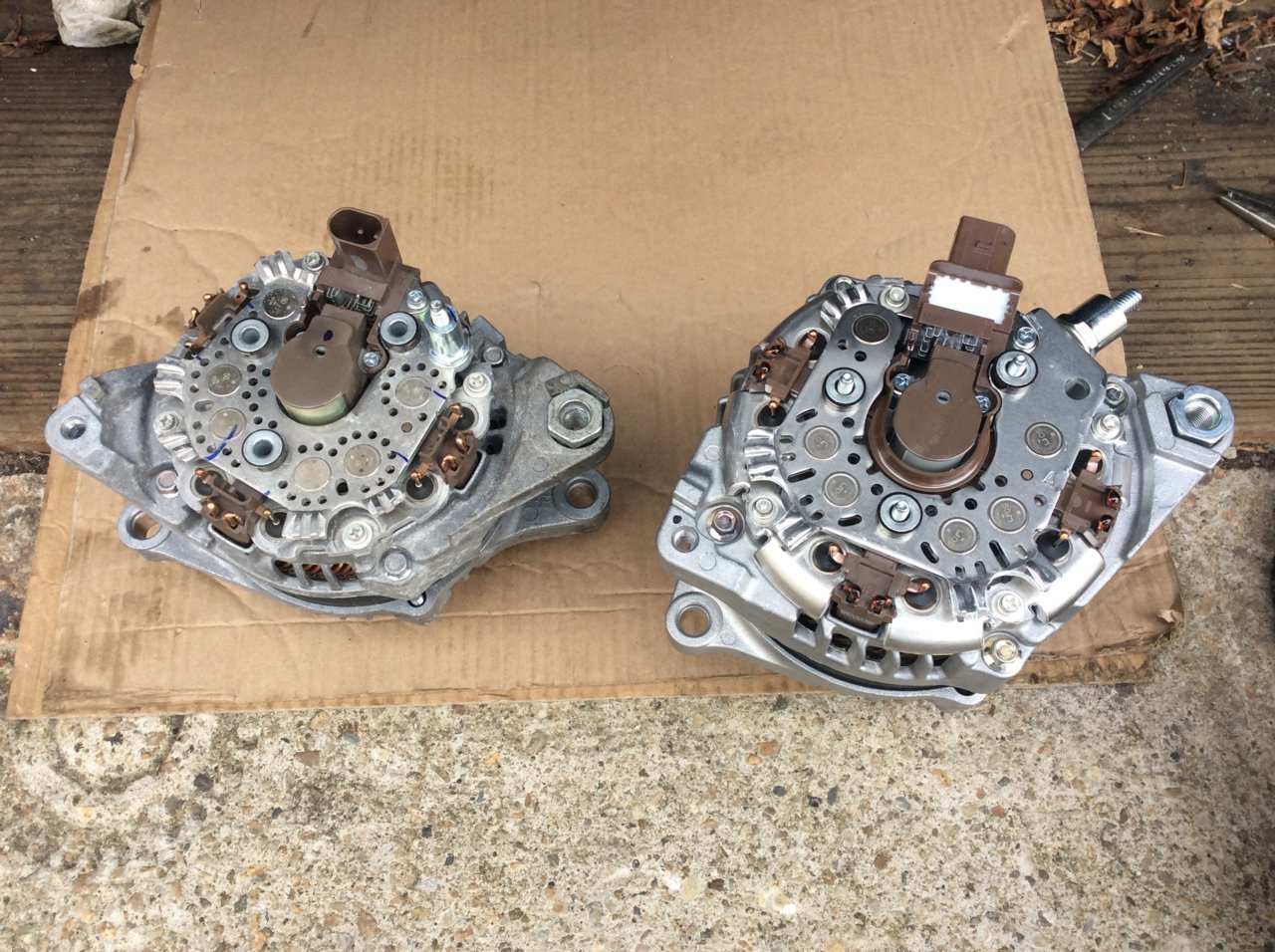

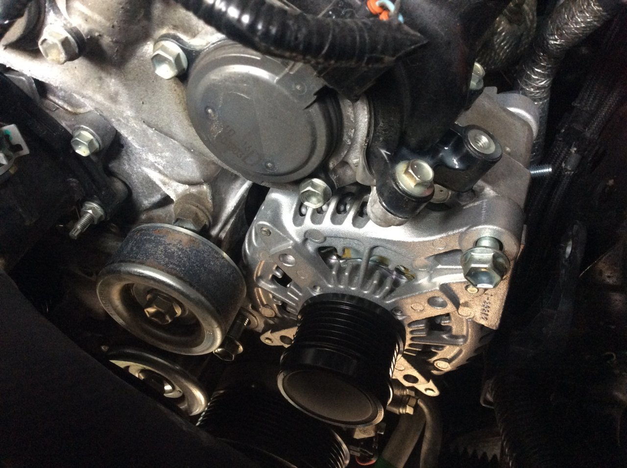

    No surprise, the big body 180 amp alternator bolts right up.
    Here's the stock 120 amp vs the larger 180 amp.

    Sooo... a wiggle and a waggle, and done? Or are the little differences killers...

    There are differences, I do not consider them killers. I will cover them shortly.

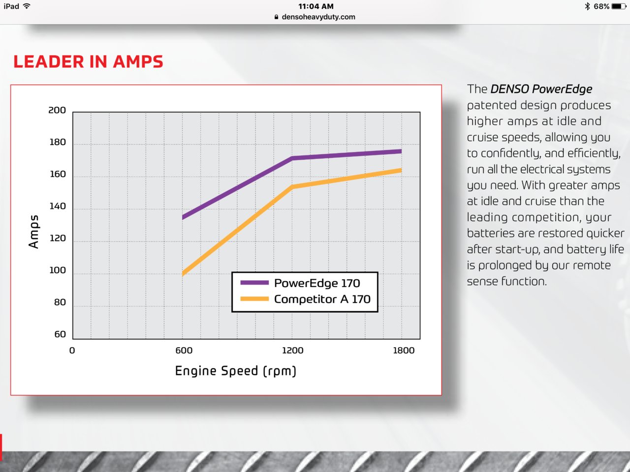

    Nobody has found an amp vs pulley rpm plot or chart for either the original or the bigger alternator, right?

    Really wish we could get some data to know what the current budget is at various rpm (without doing a big test sequence...)

    Denso usually rates their amperage hot. My best guesses on output, at this point, are based mostly on the vehicles in which they are installed. The Mexico produced unit is installed on the top of the line Sienna Mini Van w/ 2GR FKS. The higher priced Japan built unit is for the RX 350 L w/ 2GR FKS, which is the extended length 3 row. Both of these vehicles have large power requirements at lower RPM
    I do have one chart for Denso's Poweredge 170 alternator. It appears to be the same size architecture/chassis, and description of components reads very similar or the same as the Toyota units. FWIW...

    Nice, wow
    Thanks

    Pulley info will be deleted shortly! Bad cross reference showed 6 rib on some of the larger alternators. These alternators should come with a 7 rib belt. NO PULLEY SWAP!
