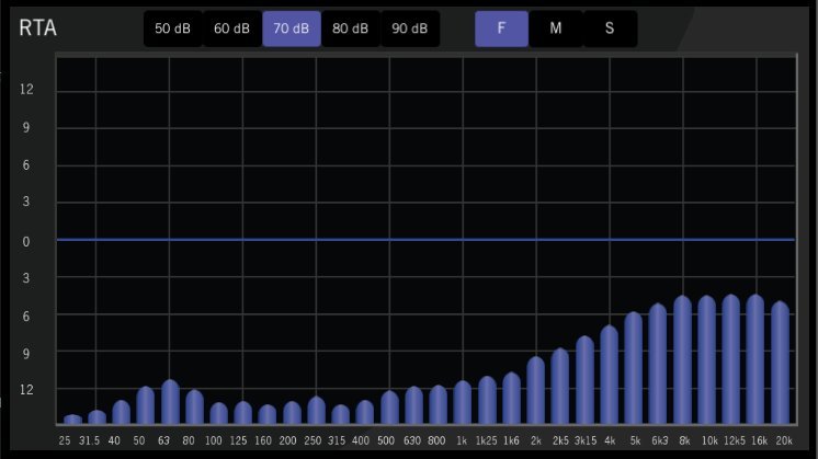

    Hello Tacoworld, I just upgraded from a 2nd Gen Tacoma to a 3rd Gen, a 2021. It is an SR5 factory audio system. The fader portion SUCKS. I took it to the dealer, checked another 2021 on the lot and the same issue. Rear speakers cannot be heard unless the fader is all the way to the rear. I am going to write to Toyota today and complain about the issue, anyone else have this?

    This is just part of the factory system. Rear speakers have always been useless. Toyota knows and they don’t care to improve. Your option is new radio or add an amp

    This is the factory radio’s rear output response. You need something like a JL FiX to remedy this.
    You shouldn’t really be hearing the rear speakers however.

    That’s the problem Jim125, replacing the speakers won’t do anything. There is not enough power to push them from the head unit. So if you want more power, from what I have read, you have to have a separate amplifier to power those speakers.
