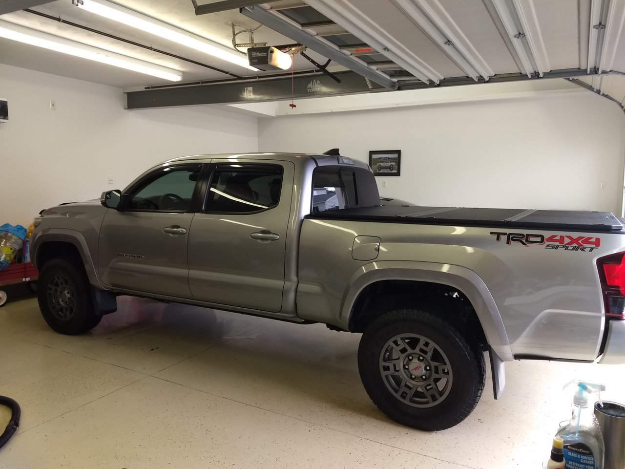

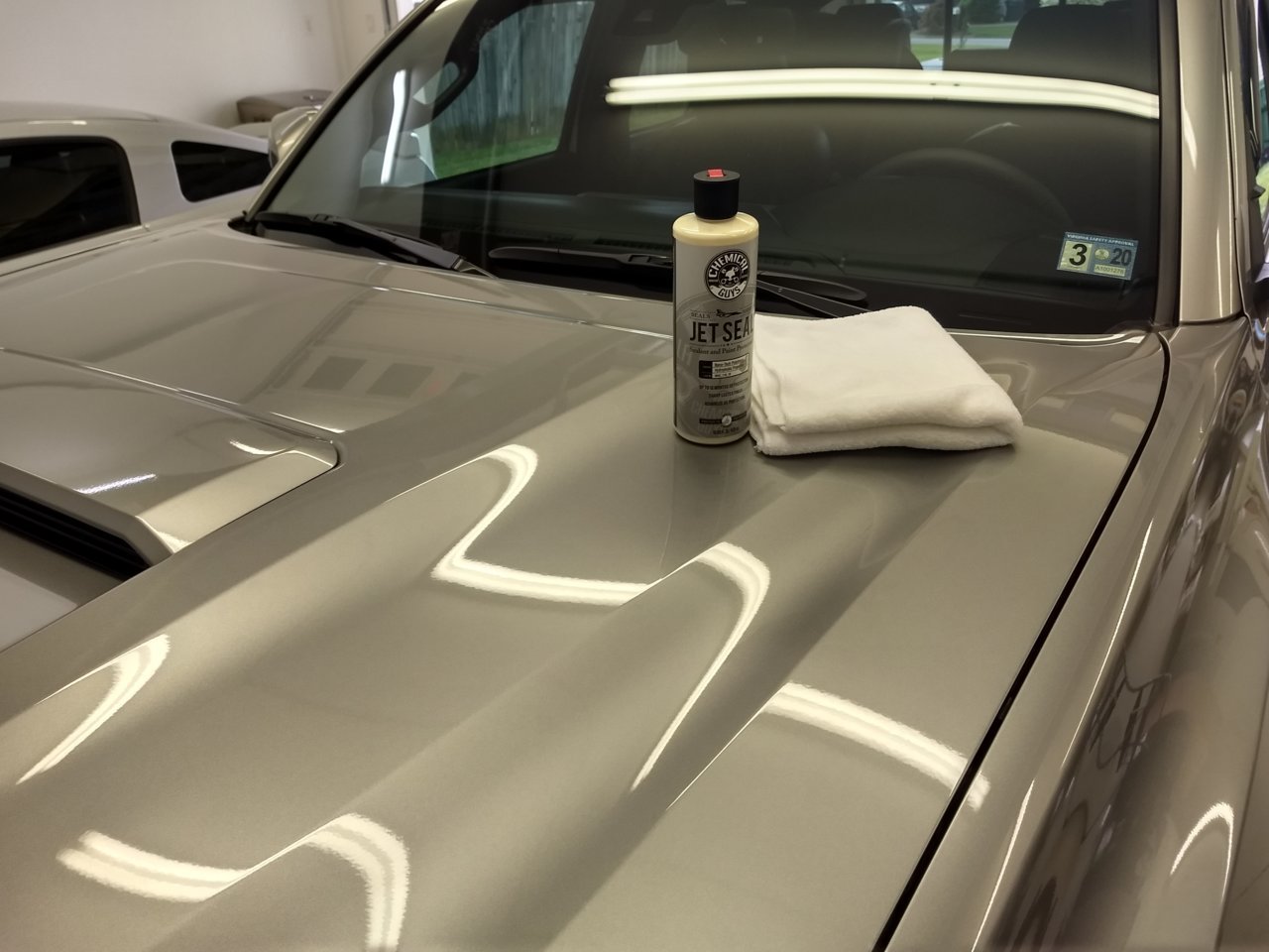

    Looks good. I lightly mywet sanded my finish, polished it with a lambs wool pad and a finesse pad then hand glazed it with 3m imperial hand glaze. Then finished it off with some jet seal. That is real old school paint correction and I did it when the truck was a few months old. I didn't have any issues other than some orange peal.IMG_20190426_154034603_HDR.jpg IMG_20190426_154114053.jpg

    You wet sanded a brand new trucks paint? With what grit? That may be the "real old school paint correction" but factory clear coats these days are extremely thin. I guess if you got away without burn through it could be ok, but now your clear is thinner, some people don't even like to BUFF the factory clear in fear of removing too much material wet sanding seems drastic.

    Yep, done it several times over the last 30 years. There is more paint on the trucks than people think. They read things and then think that it's true. It has some thickness to it. I don't burn paint, all edges were fine lined taped off. Also we measured the with a mill gauge. I have done this enough to know when to stop. I would love to rear clear it one day but probably never will. I will say the finish is pretty hard now, also I have wet sanded fresh paint the very next day and buffed it. I used some 13 micron, high speed buffing and finesse cream. The finish is slick. I ain't scared,it's only paint and can be made to look better. I just don't believe all the hype over this ceramic coating. I'm sure it's good but I have always had great results with a handful of off the shelf waxes and sealers.

    Looks mighty great! Good job! If done right by an experienced detailer - wet sanding followed up with micro buffing just levels the high spots (peel).
