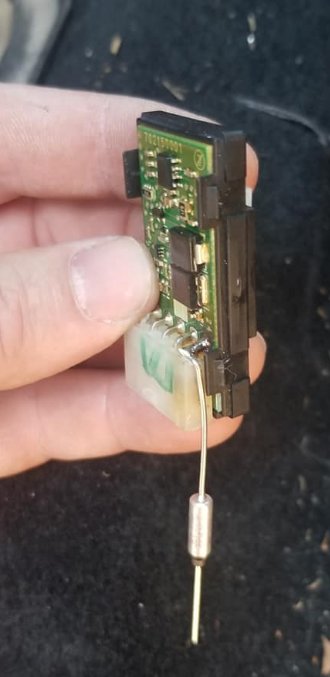

    Hmm..I saw someone with this same problem. They fixed it by fixing the connection and wiring in a thermal limiter. Let me see if I can find it.

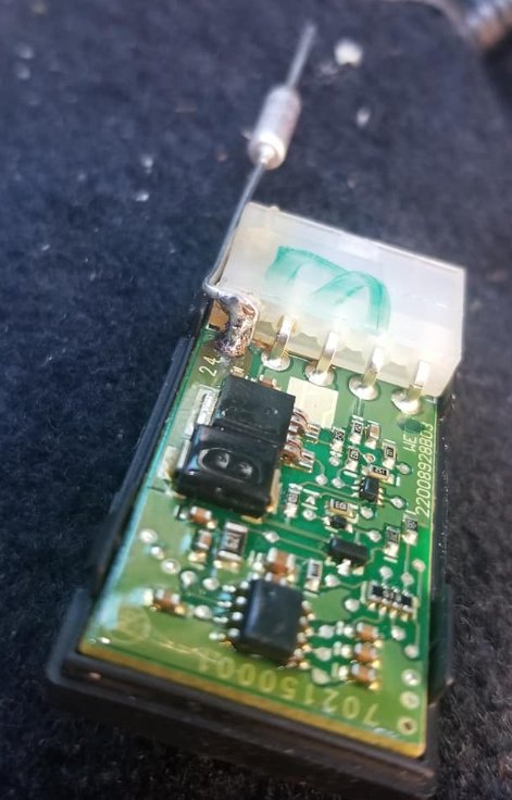

    It does seem the most common issue is at the connector. I’m sure there are electrical repair shops that can repair the controller without too much trouble, possibly install a different/better connector, but even just repairing it should be possible.

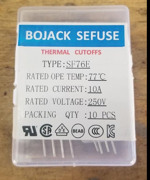

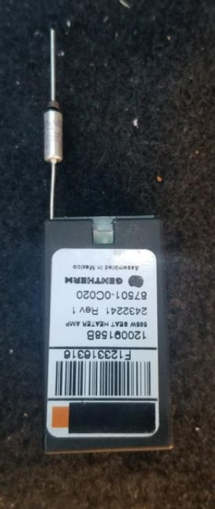

    That's all there is. What else is there to know? Basically, remove that power pin from the connector. Solder a thermal limiter to the rear of the connector to bypass the scorched pin. Solder the other end of the thermal connector to the power wire you removed from the connector. Plug the connector back into the amp. May need to modify the plastic casing slightly. Make sure things are cleaned up/heatshrinked, etc. blah blah.

    Yeah assuming the board is good and it's just the connector that's problematic, easy fix and prevent it happening again.

    i tried and this didnt work for me... mine did look a little bit more fried than yours though. so maybe mine killed some of the components too
