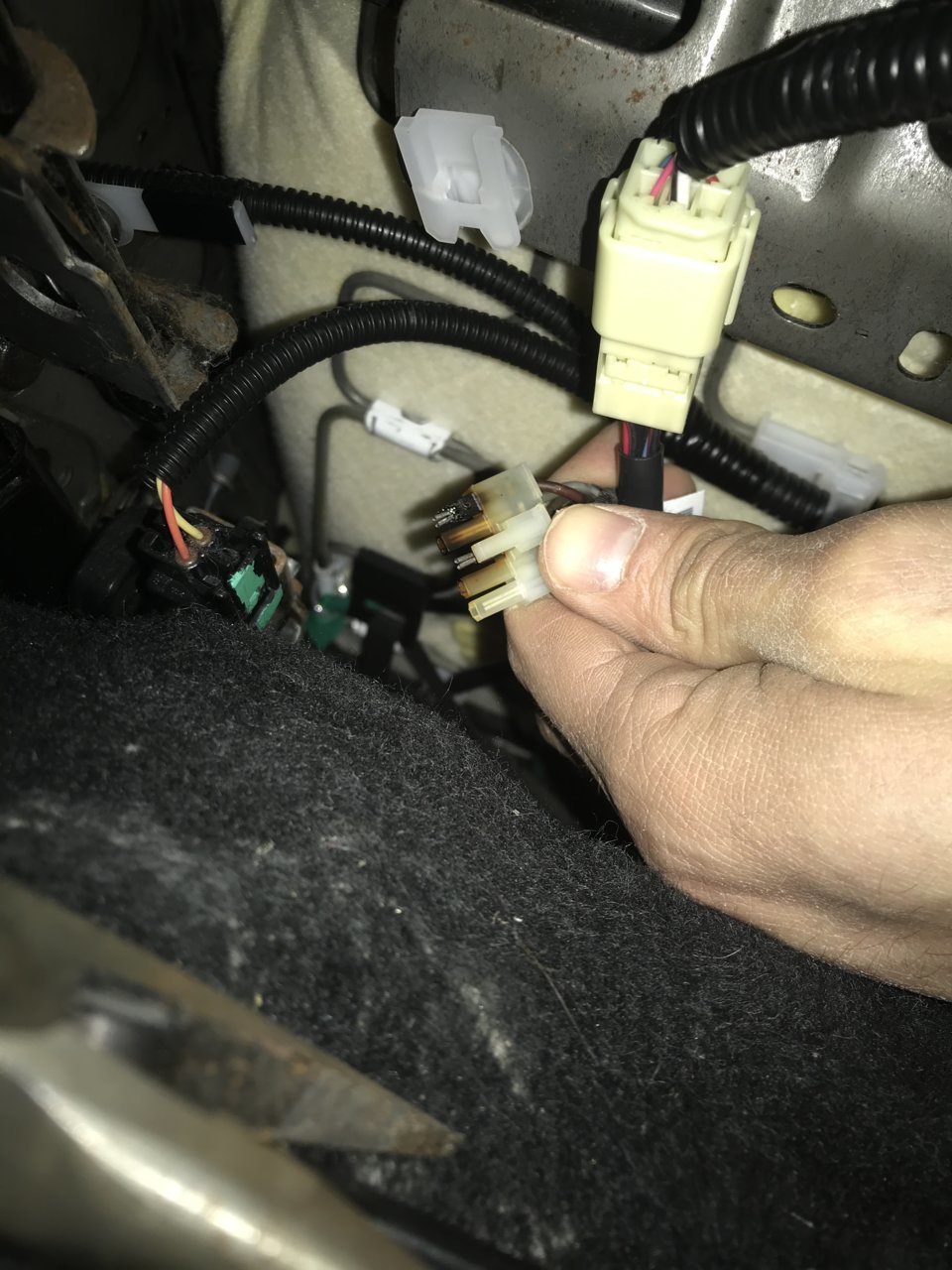

    Not mine, just saw on Facebook. But yeah it might have fried a chip on the board too. It should be ok to test bypassing the pin with wire first to test the board and add the thermal limiter after if so. I don't know what those cost...I expect fairly cheap.

    it was $6 for a 10 pack so it was worth a shot before ordering a new harness assembly... but i just did that

    I just want to share my own issue.
    Had exactly that problem with the power pin melt and i just soldered a wire to the module and make the junction and it's working just like before.
    I'm pretty sure the pin that is inside the connector was loose so it arcked up to the melting point.

    Same issue on a 2016 trd off-road! 50k miles. Does anyone know a good fuse size I could throw in with an inline fuse to possibly stop it from happening again? Also was able to get a new amp from the dealership. Runs ~100$. Will not be needing it however because I was able to get the amp working again by simply cleaning out the connector of melted plastic. Tested the connectivity of the board, then plugged into passenger seat to confirm it was working. Just need a new male connector and some wire soldered in and she should be working like new!
    update: just took a simple repin of the male connector.

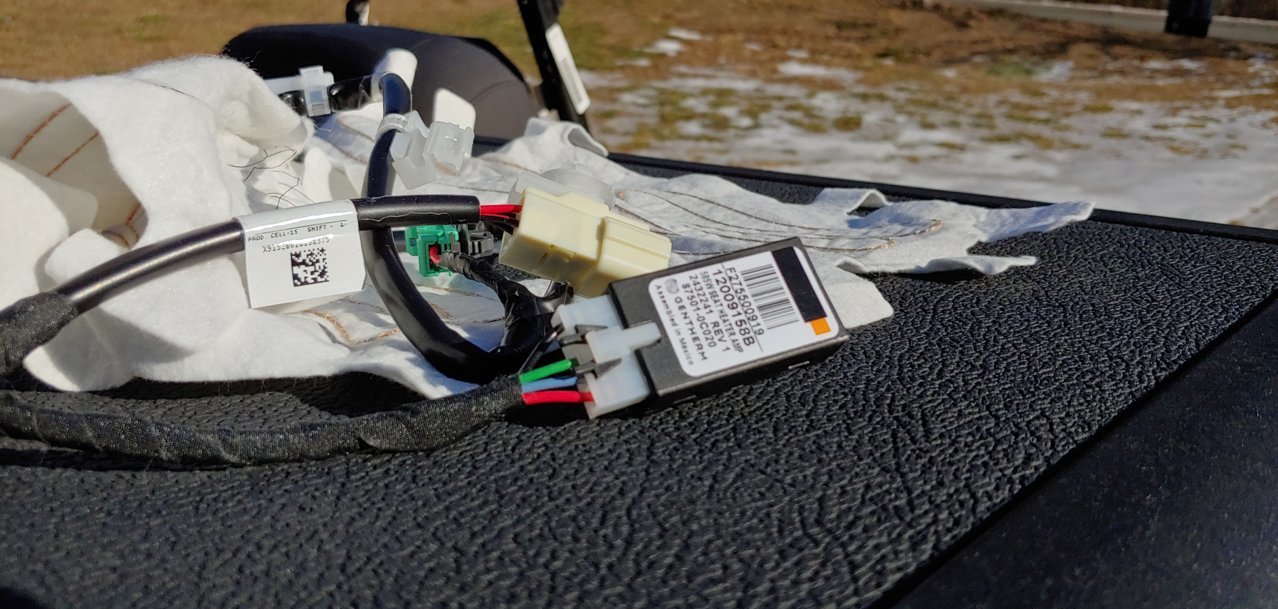

    Im case anyone is wondering, here's a pic of the new harness assembly with the new amp on it. It has a new part number but looks identical. They added a black retaining clip into the connector to try to keep it more stable 20191224_111112_HDR.jpg

    mine had this, still went out.

    Yes someone stated earlier that the problem is the wattage moving through different gauge wires through out the assembly... If that was a true root cause I could see it not making a difference. Or it's probably a combination, and the undersized wires get too hot, and the loose connector sparks out and melts up
