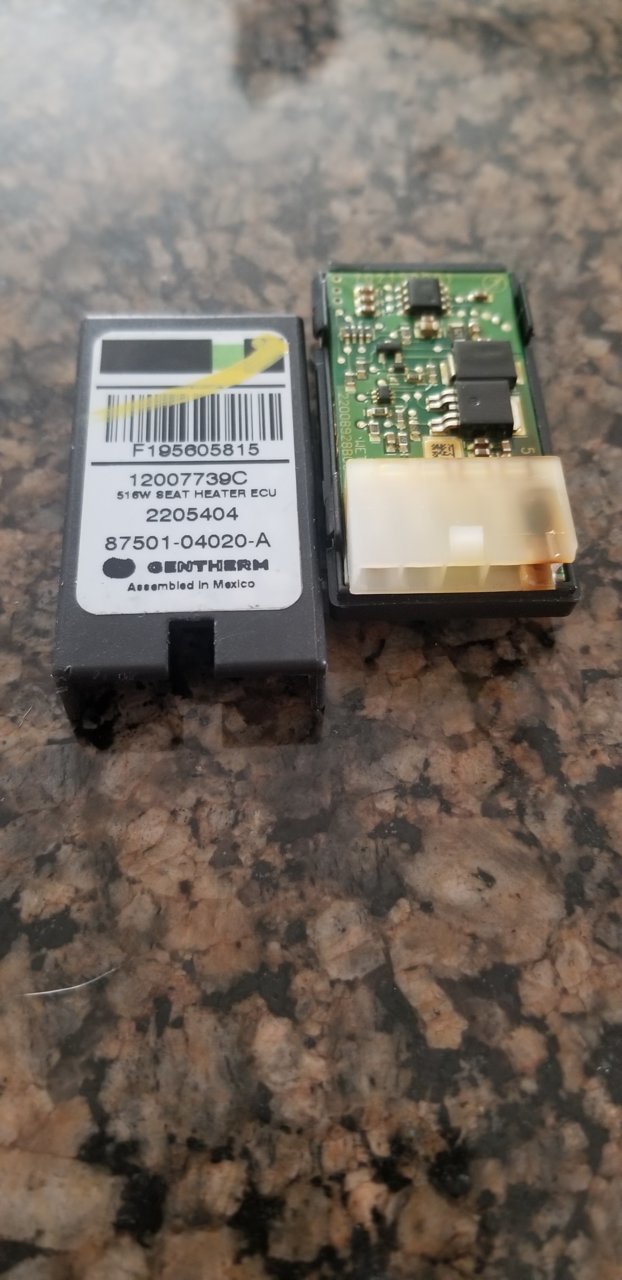

    dyna962007
    dyna962007 Well-Known Member
    Mar 8, 2015
    #150397
    182
    Edwardsville IL near Saint Louis MO
    Tacoma 2016 TRD OffRoad / Previously 2007 4wd
    3" lift kit. 17" wheels and tires, custom grill, full technology package, Early model running boards, Push bar.

    I took my seats out again doing a deep clean last Tuesday. I figured I would take a stab at making mine work again. I popped open my module, took a little screwdriver and broke away the burnt plastic and scraped up the terminal. I was able to bend it up a little. I had the heater blower motor plug I had to cut off and replace so I stole one of the wires from it and slipped it over the terminal. I popped the module back together. I was able to slip the plug back on and use a butt connector to splice it back into where the burnt wire was. So far so good :bananadead:
