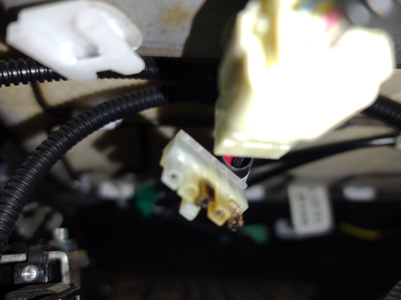

    Mine is now burnt up as well. I have 98,000km on my 2017 TRD Sport. I do however have the Platinum ECP package with extended warranty that ends Feb 2022 or @ 100,000km. HOpefully this will still get covered under such, but this should be a recall.......
    Do we have any updates what Toyota Corporate is doing or the Transportation Board in Canada are doing on this issue?
    Currently on hold with Toyota Canada.....
    IMG_20211026_103307026.jpg IMG_20211026_103157496.jpg IMG_20211026_103153747.jpg
    smugly and shakerhood like this.
  9. Oct 27, 2021 at 10:29 AM
    #289
    Danger97
    Danger97 New Member
    Oct 26, 2021
    #380533
    2
    Dane
    2017 Toyota Tacoma TRD Sport
    Couldn't get through to Toyota Canada yesterday, however spoke to a contact at dealership and they advised they expect it will be fully covered under my extended warranty and are going to make a couple calls and get back to me tomorrow to schedule the repair (which should be 100% covered by warranty), but needs to check on what parts exactly needs to be ordered and ETA before bringing me in.

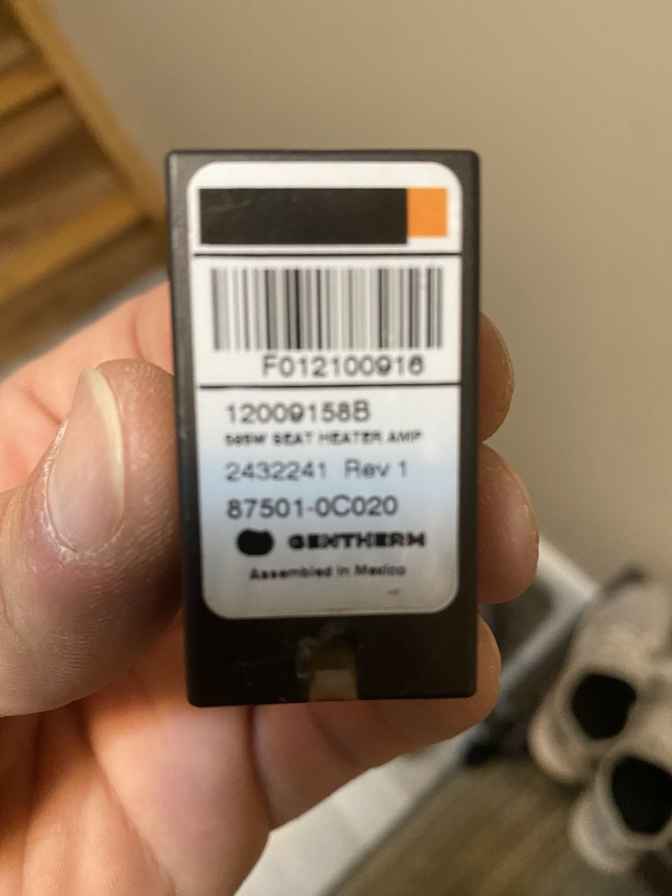

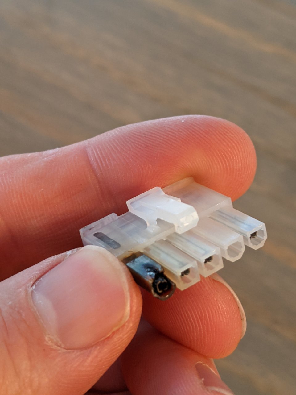

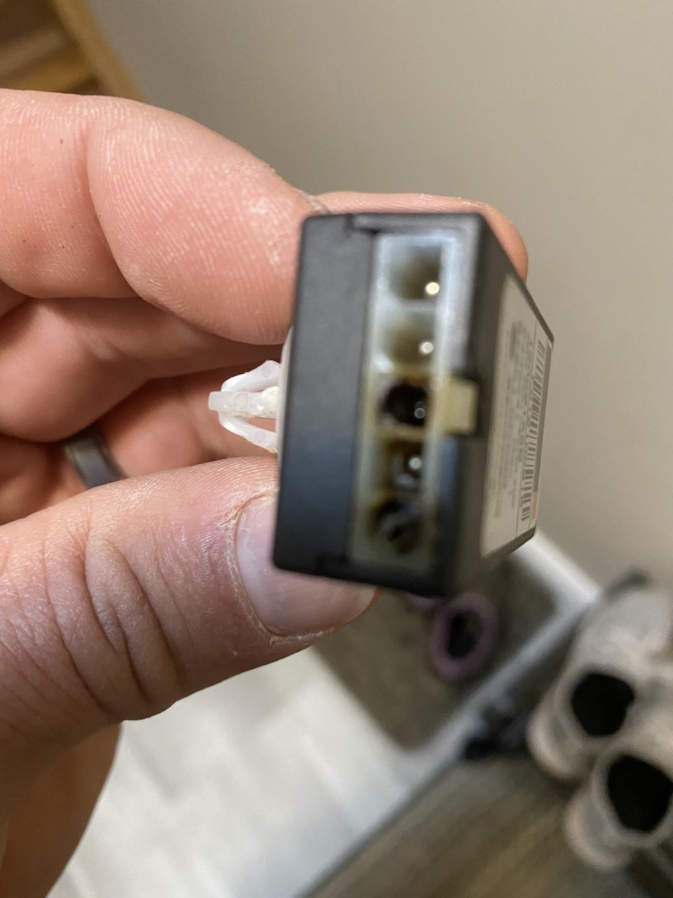

  12. Nov 3, 2021 at 4:41 PM
    #292
    DoggerDave
    DoggerDave Well-Known Member
    Oct 9, 2021
    #379183
    152
    Dave
    2016 Blue TRD Sport 4x4 long bed
    Not much yet. Previous owner put some oversized tires and rims
    I have a 2016 with the same issue. I have 2 burnt wires. It actually looked ok until i got the connector separated. The way you get the connector is to pull the black piece out before trying to "press and release" (pull the pin first). My truck has almost 200,000km but I will be calling toyota tomorrow and reporting the fire hazard to them. I will post pictures in a minute

  13. Nov 3, 2021 at 4:48 PM
    #293
    DoggerDave
    Oct 9, 2021
    #379183
    152
    Dave
    6B80C181-DC47-442B-9303-D7CE24A28658.jpg BE689F78-FE64-48BD-8C28-CAA20B0589F9.jpg
  14. Nov 3, 2021 at 4:50 PM
    #294
    DoggerDave
    Oct 9, 2021
    #379183
    152
    Dave
    I would suggest changing the entire assembly. I do upholstery and removing the material to replace the heating element is not a big job. I will post pictures once I change mine. Hopefully Toyota pays for the new parts.

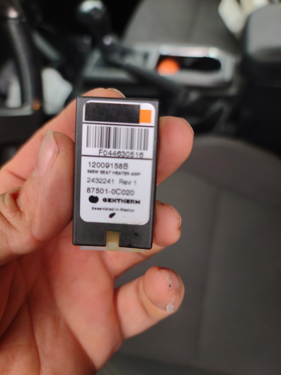

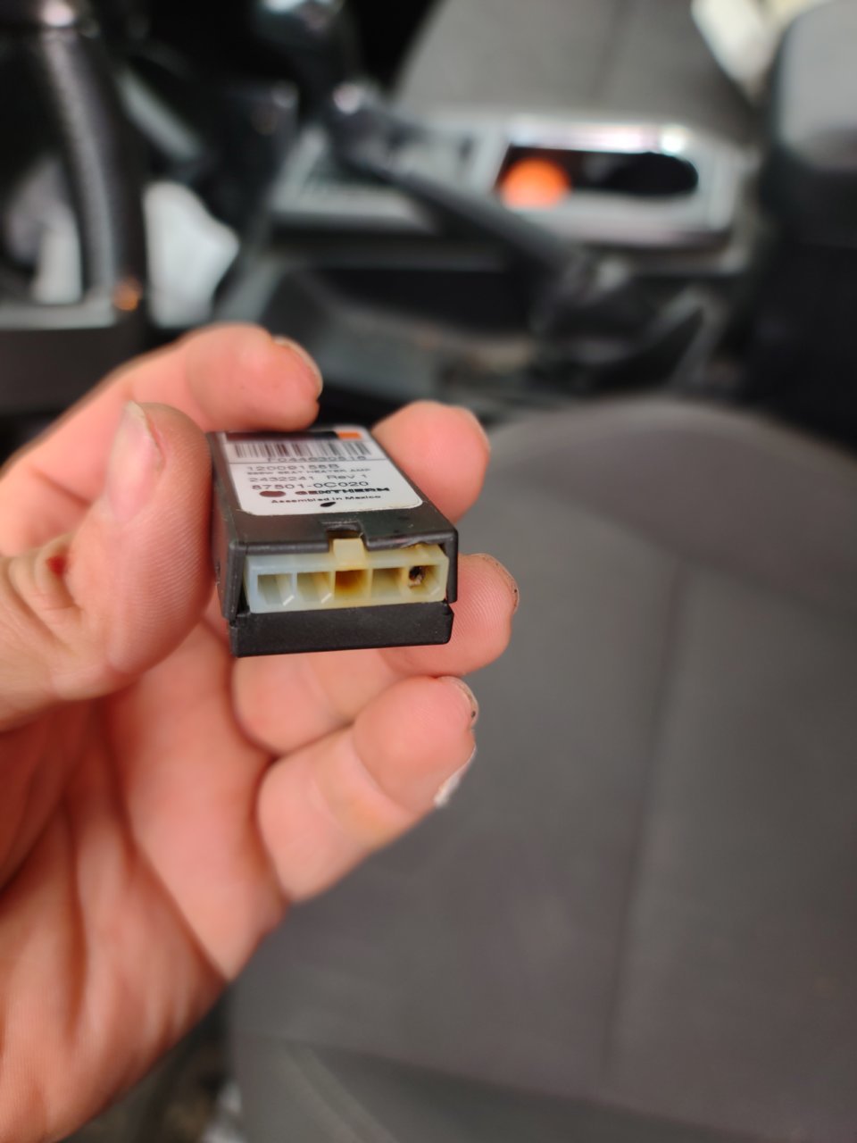

  15. Nov 3, 2021 at 5:24 PM
    #295
    Pdxsteve
    Pdxsteve New Member
    Aug 27, 2019
    #303490
    4
    2016 w/GFC
    Why the elements too? Really hoping to just keep running it rewired. Maybe I'm an idiot but I am able to do basic wiring. Hopefully no
  16. Nov 3, 2021 at 5:30 PM
    #296
    DoggerDave
    Oct 9, 2021
    #379183
    152
    Dave
    If you already did it and it’s working fine, I wouldn’t worry too much, but if I was getting a new part, I would just change the whole thing. It’s not really any more work than cutting wires. All you need is some spray adhesive to glue the new pad in place. The seat cover is probably held in place by Velcro and plastic clips.
  17. Nov 3, 2021 at 5:32 PM
    #297
    Pdxsteve
    Pdxsteve New Member
    Aug 27, 2019
    #303490
    4
    2016 w/GFC
    Nice, good to know. Time will tell for me... but y'all be the first to know if shorts again.
  18. Nov 3, 2021 at 5:56 PM
    #298
    bagleboy
    bagleboy Well-Known Member
    Aug 5, 2017
    #226018
    7,259
    Scott
    Norcal, Santa Rosa
    2014 5-lug AC 2.7L VVTI
    Snug top Rebel, Thule tracks, ditch tracks, Bagged rear suspension, F/R anytime camera, intermittent wiper switch...
    Why, it’s just the module that gets cooked. With FET current control it usually happens on medium/high or medium because too much current is running with enough voltage drop to overheat it. On high there’s no voltage drop and on low the current is too low to generate the heat. The elements are made to both carry the current and dissipate the heat so they don’t fail this way.
  19. Nov 3, 2021 at 6:00 PM
    #299
    DoggerDave
    Oct 9, 2021
    #379183
    152
    Dave
    I’m just pointing out that changing everything is just about the same amount of work and then everything is new. It doesn’t make a lot of sense to me to cut up a brand new part for nothing.
  20. Nov 3, 2021 at 6:04 PM
    #300
    bagleboy
    Aug 5, 2017
    #226018
    7,259
    Scott
    Norcal, Santa Rosa
    You’d have to open up the seats to get at the elements. Replacing the module is a few minutes. Replacing the elements several hours for an upholsterer. A different story for aftermarket elements that are just under some seat covers but not with oem.
