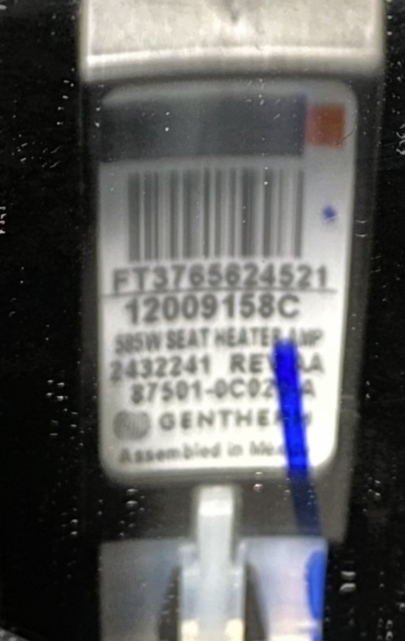

  19. Dec 21, 2021 at 5:15 PM
    #339
    quantumechanic
    quantumechanic Well-Known Member
    May 16, 2018
    #253658
    220
    2022 Tacoma SR5 DCSB 4x4
    The 2018 I had did not have heated seats but the ‘22 I bought last month does.
    It looks from the info shared on here that the problems you guys have had are mostly on trucks from 2016 to 2018, and the TSB that was shared seems to cover those same model years?
    I was curious about whether Toyota had done anything or not to address the issue on newer trucks.
    I took a look at the module on my driver seat and it seems to have a different part number.
    I took a photo using a mirror under the seat, and it’s a little bit hard to make out, but it seems to show a P/N of: “87501-0C020-A” (vs. 87501-0C020).
    It also says “FT3765624521” instead of “F242429815”. And “12009158C” instead of “12009158B”.
    Just thought I’d share in case it’s informative or helpful.
    oliver1539 likes this.
  20. Dec 23, 2021 at 6:11 AM
    #340
    DoggerDave
    DoggerDave Well-Known Member
    Oct 9, 2021
    #379183
    152
    Dave
    2016 Blue TRD Sport 4x4 long bed
    Not much yet. Previous owner put some oversized tires and rims
    It looks like the part is virtually the same according to the picture you posted. Apparently the connector it the main issue. My electronics guy is in the process of repairing my drivers seat heater. Your seats will most likely have the same issue as it looks like Toyota still has not addressed the main problem yet (the poor quality connector)
