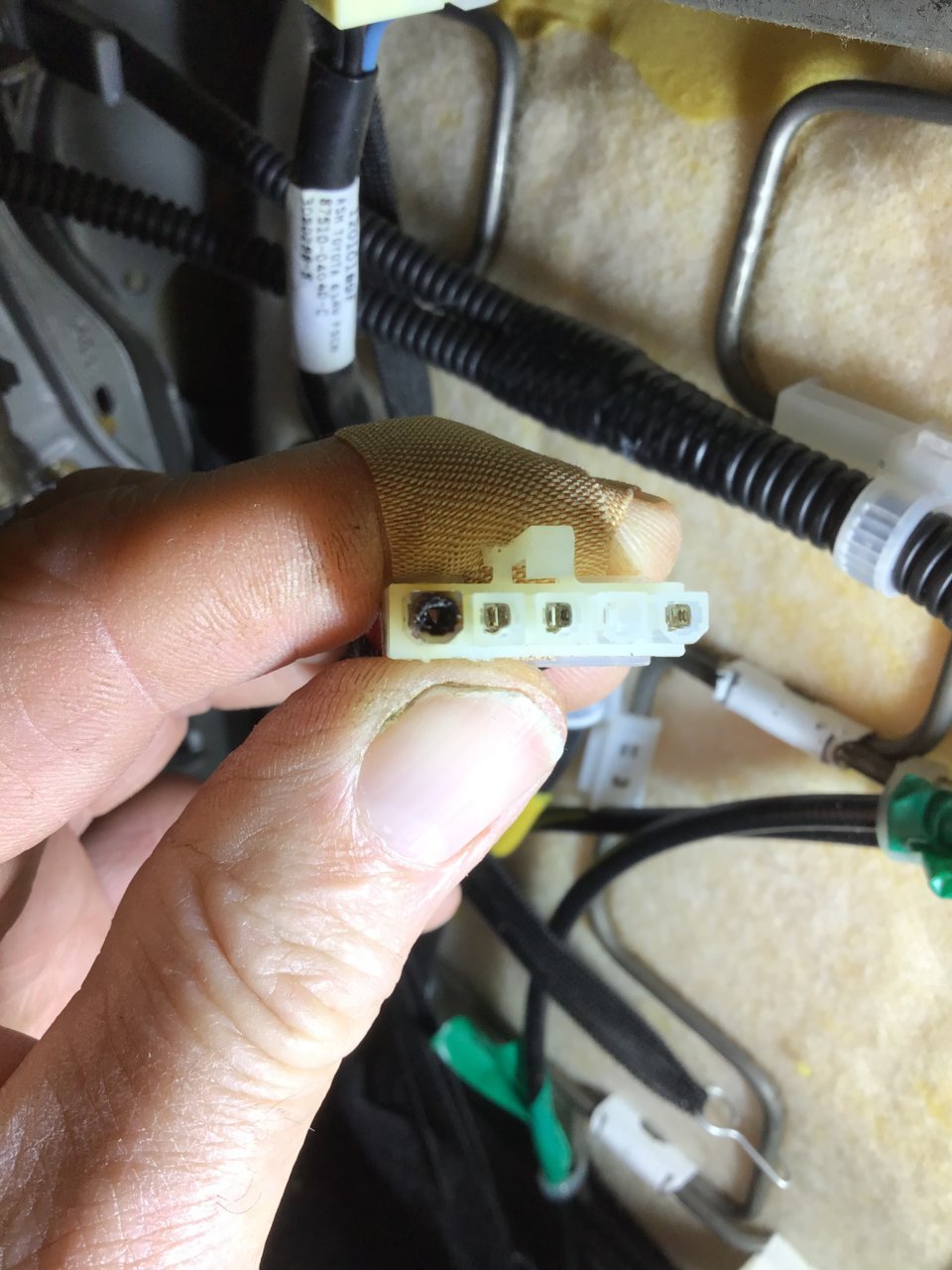

    Toyota has known about this problem for years. They refuse to use a better quality connector or repair the defective parts. They usually last just past the end of the warranty period.

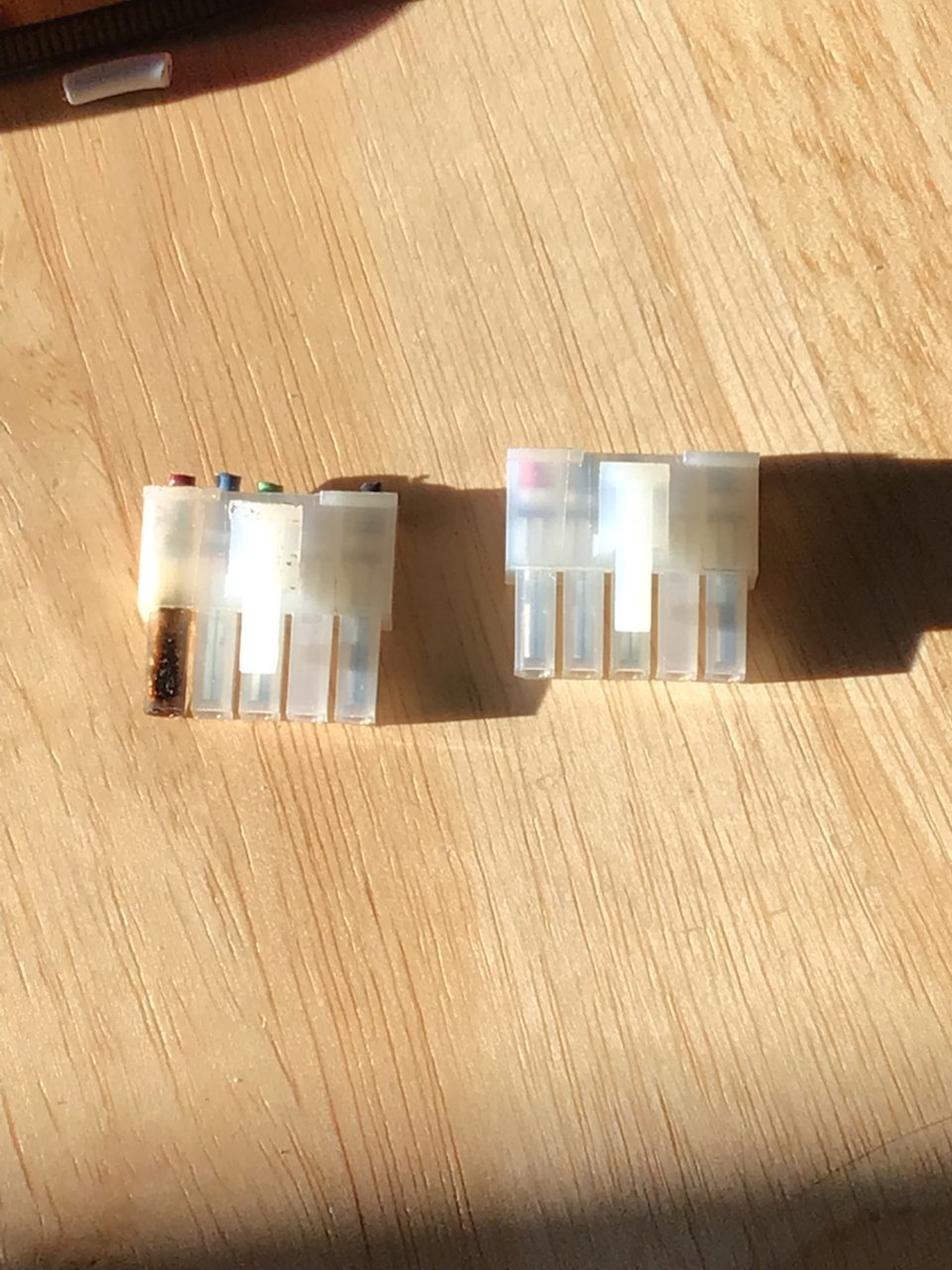

    Yes I cut off the old connector. Only actually 4 wires.

    The picture is of the old and new connectors side by side. I just cut off the old connector and soldiered the old wires to the new connector wires.

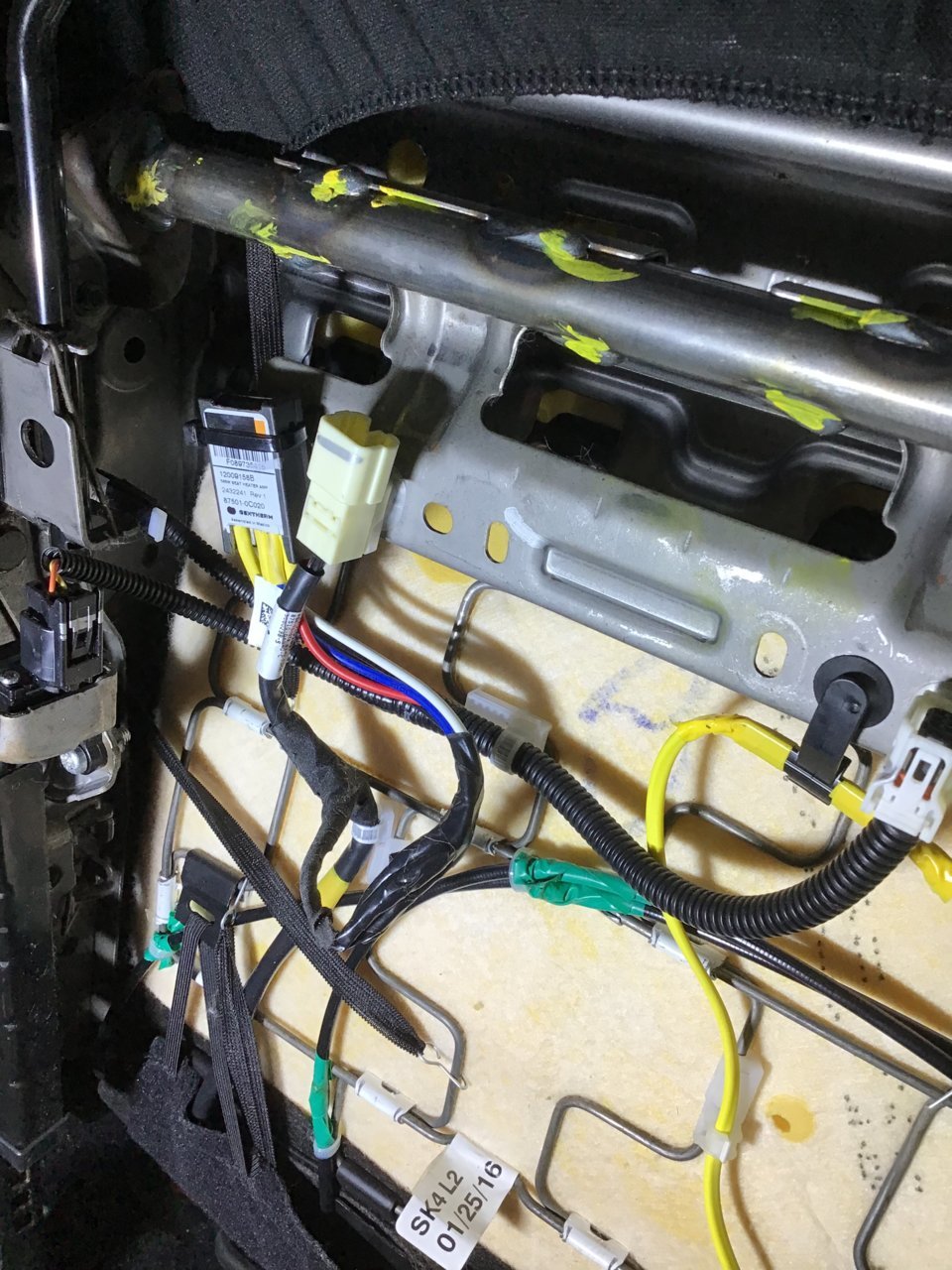

    Yes, they have air bags from 2nd gen on. Disconnect the battery. Remove the rear bolt covers and bolts, then the front bolts. Tilt the seat back forward and then the entire seat backwards including the bottom. Then unplug the yellow air bag connector, heated seat plug, and power seat connectors if you have them. Lift the seat out.

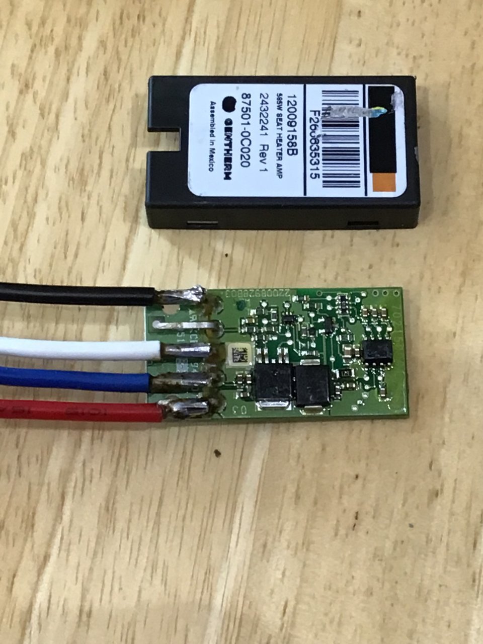

    Im joining the club also.... 2016 sport
    i think I'm just going to solder 6 to 8 inch long wires to it and go directly from harness to board..
    My PCB board looks OK i think...

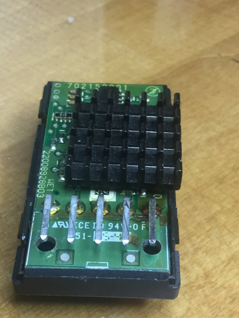

    All the heat gets shared to the 2 big chips connected to the trace with the “20” by the terminal. Those are the ones that usually show heat damage if it goes on for too long. Use over size wires, the extra copper and mass helps dissipate the heat in the absence of any other heat sink.

    Well i was toying with the idea of adding a IC chip cooler to it with thermal tape..
    but yes looking at some bigger wire to pull some off the heat out..

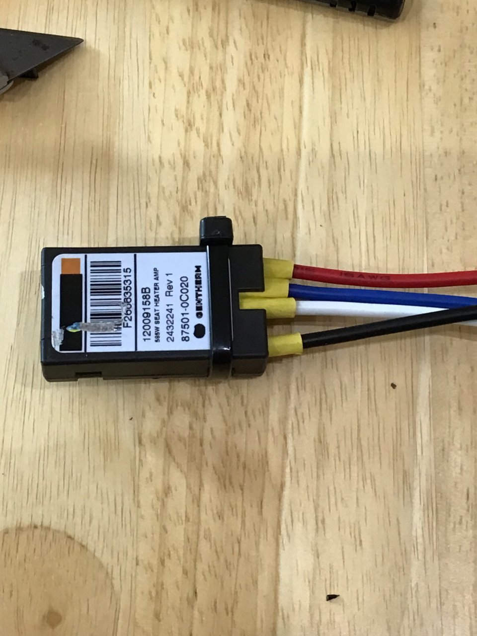

    So update. My butt warmer now works again just by rewiring it.
    Driver side was dead with a burnt out red wire, i did the other side at the same time because i had all the stuff ready to go and the green wire was dark with that seat but still worked (for now) And you KNOW its going to die anyways. :notsure:
    I used some 16AGW wire from a 30amp relay plug i had for both. just took a few hours for both, just screwing around under 1 hour if you had stuff ready for it.
    Just solder it right to the cut off plug as it is burnt anyways.
    unbolt the seat /undo the few plug/ and just tip it back to work on, no need to pull it out
