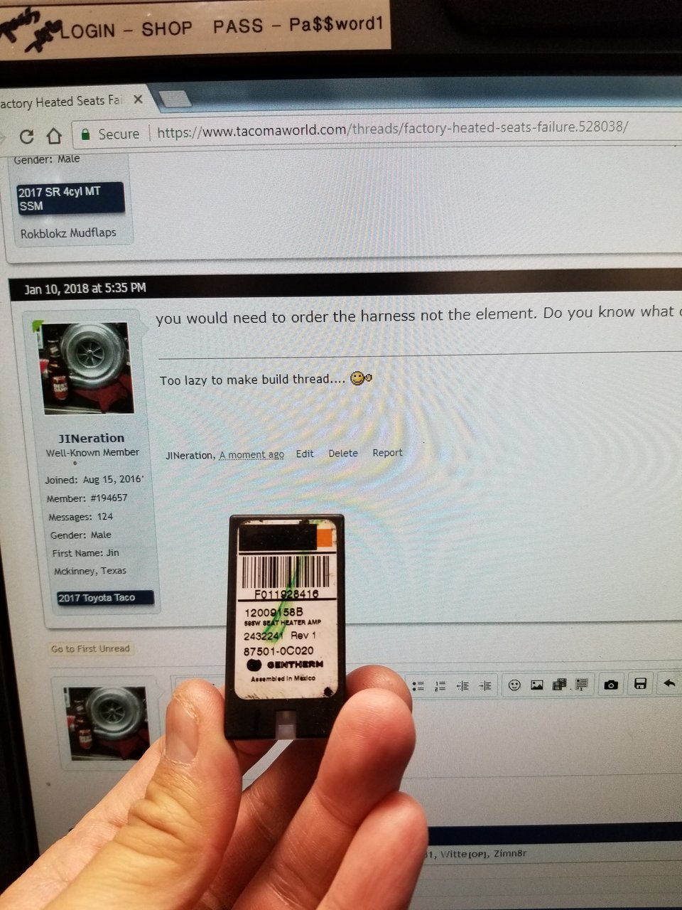

    just to show

    now we have the login and password!!

    I am an electrical engineer, but have little experience with PCB's. I can trace a single layer board, but that's about it. The harness all seemed to be in good shape. No burns, besides the one terminal which is fixable. No melting insulation. When I noticed it wasn't working there was not a surge in heat. No smell of burnt electronics even. I am going to try the dealership on Friday. The actual module is locked into the harness and the clip has a tampering lock that can't be put back on, so hopefully they don't blame me for that because all I did was remove it to try and find a replacement. ***Also I undid the passenger side and made sure the driver said is still functional and it was good to go. Then put it back on the passenger side and it was still functioning. So the only issue is the module I believe.***
    All of these sites I have seen will say they have it, but when you go to order they will tell you its discontinued. I tried like 6 different places today.

    OP - You've got the SKU on the part so Toyota should be able to get the part from the SKU number.
