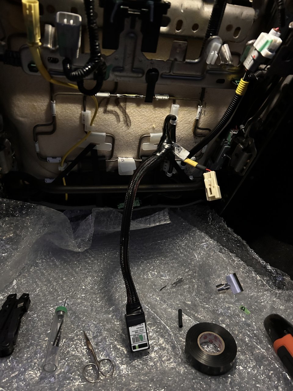

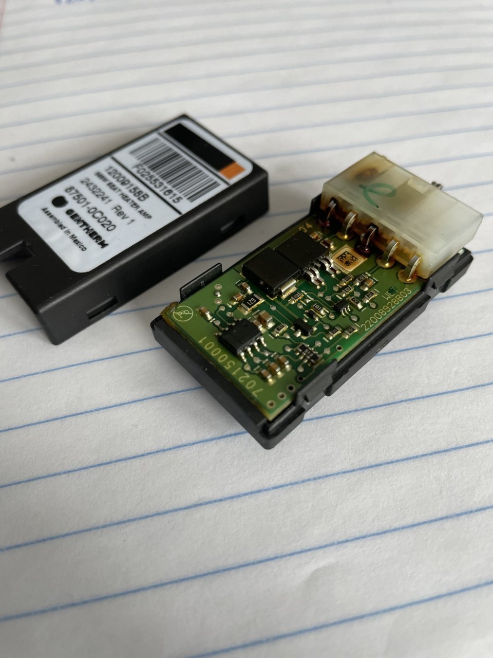

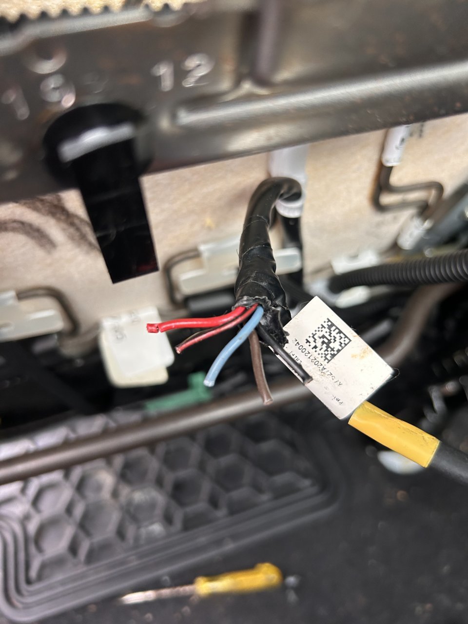

    Tried my hand at the resolder fix to keep wifes seat toasty. Spent way more time on this than I care to admit. Most time spent removing the connector on the board. Cutting, melting, prying and cursing. Took awhile to get the solder joints neat and clean. I used 9inch or so of 14G. The 2013 sport has 5 wires at the connector. Soldered all 5. Used some snake/braid to cover the bundle. Zip tied everything back up under the seat nicely cause I butchered a few of the original harness mounts.:anonymous:
    Thank you Tacomaworld people. This fix was cheap as free and wife is happy with her hot butt again.
    :fingerscrossed:
    upload_2023-1-28_18-51-52.jpgupload_2023-1-28_18-47-41.jpgupload_2023-1-28_18-47-41.jpgupload_2023-1-28_18-47-41.jpg
    only did passenger side for now. Will try keeping heaters under 80%,it might help?

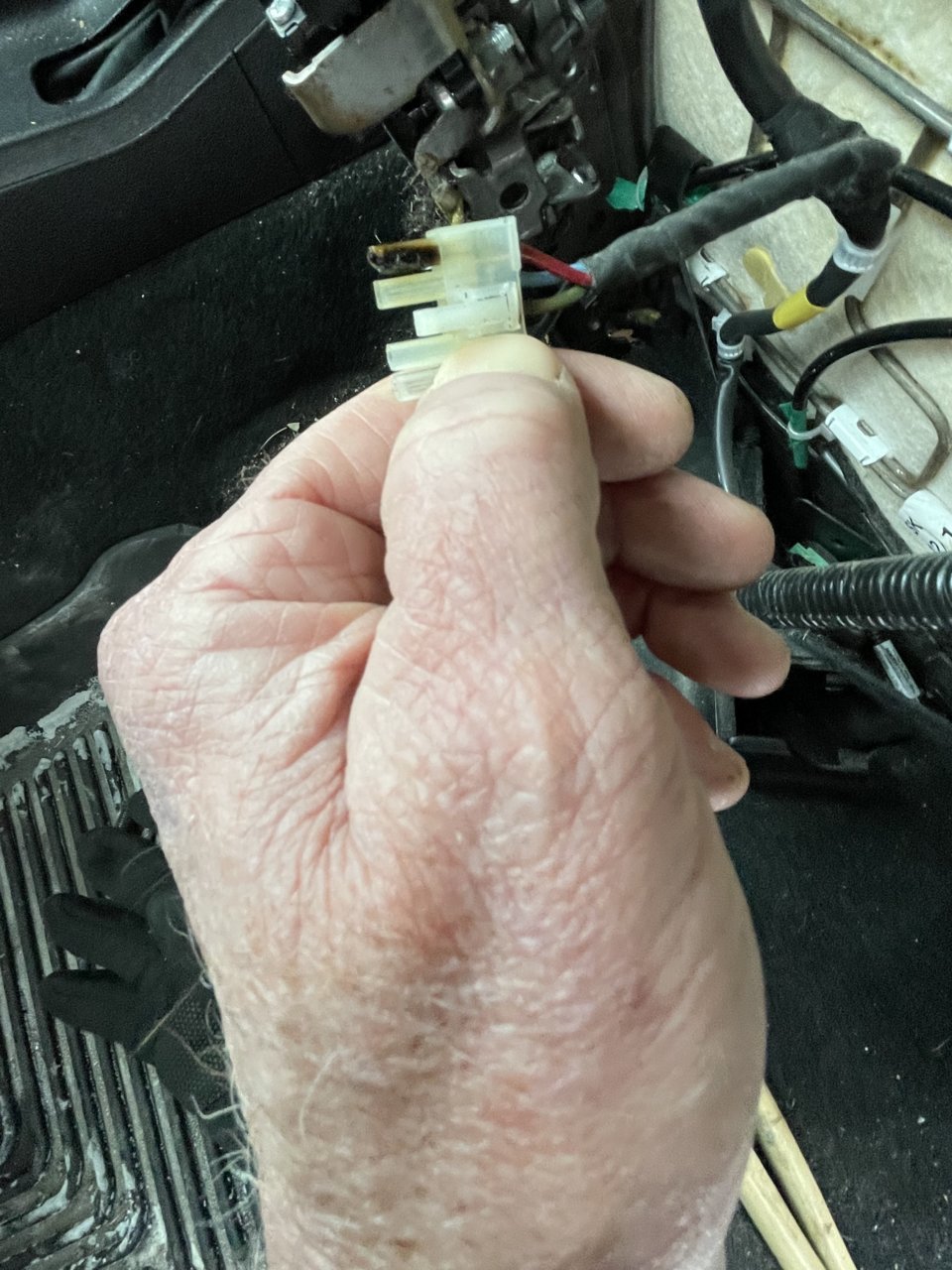

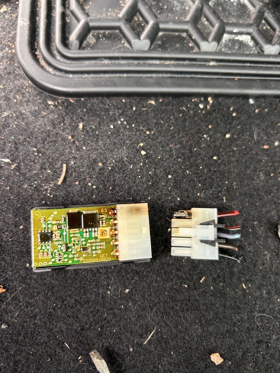

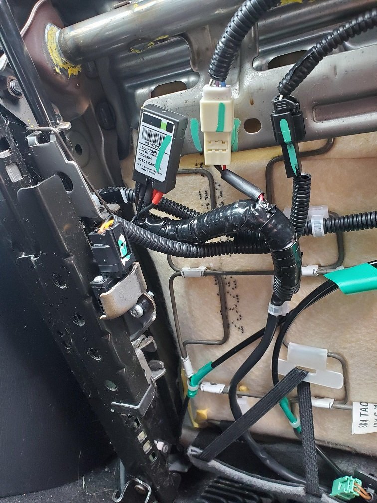

    Add me to the list of driver’s seat heater amp failures. Like others, suddenly stopped working when needed most. Passenger seat works fine, even on hottest setting. No help from stealership but would be happy to repair for normal labor rate plus parts. New Amp about $140 from dealer. Available on line for around $100. Notified NHTSA. Surprised to see a significant percentage of notices are related to heat amp failure. My opinion, this fire hazard should be a recall. I plan to repair amp as detailed in thread first and replace if unsuccessful. Shout out to TW community for education first and keeping money in our pockets second.C790ED76-1F76-4243-91B9-D729BC67C404.jpg 9F99F3D5-20BE-4BB2-9D6F-B62F24AAA20B.jpg

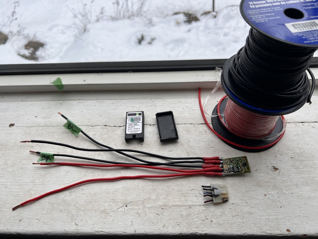

    Welp.. another drivers side heated seat failure to add to the list. This is in a 2nd gen '15. Ended up wiring 16ga leads to the heater amp and so far so good. Passenger side will be next.
