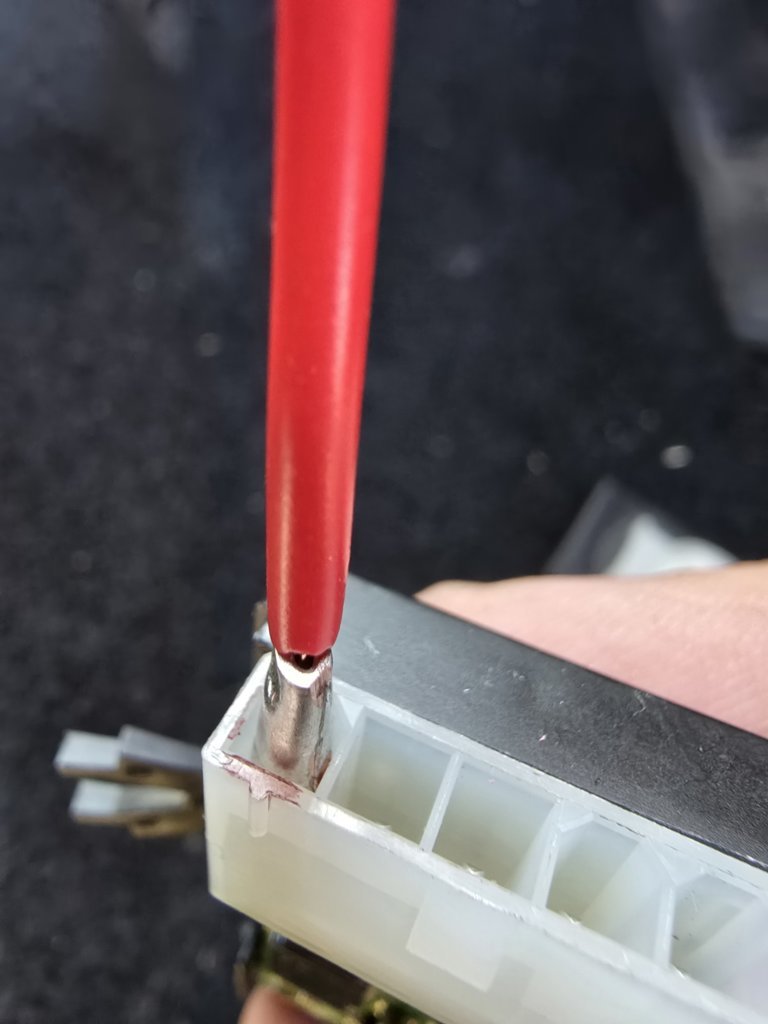

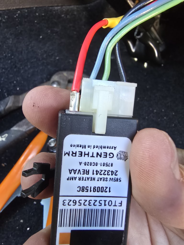

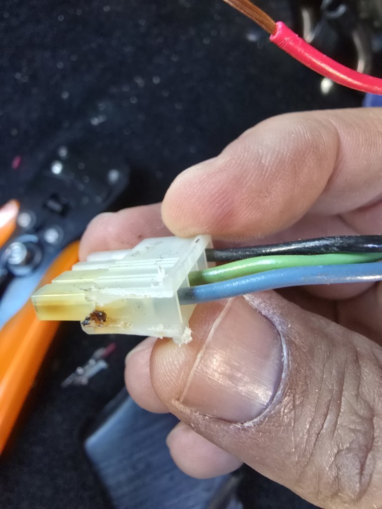

    Update: I now have the correct sized part in hand. The issue is the male connector / wiring harness is also charred and needs a PROPER fix. If using the same type of connection, you get the same results. So I bypassed that connector and made my own, using a heavier gauge wire and thicker connector. It works wonderfully and I feel safer knowing there is a much heavier duty connection now. I shaved off the power receptacle slot that was melted, which made room for my own connector to fit in.

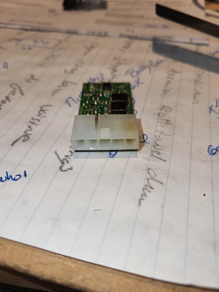

    Anyone has a trick on how to remove the white plastic from the Am ECU chip board?

    I used some like wire cutters and just kept snipping away at the plastic until I could pull it off. Probably an easier way but it got the job done.

    Had my seat fixed today, I was able to get the white plastic connector off the board with a lot of patience. I used a Yellow Olfa utility knife and a ligther to heat the blade and melted the plastic between the pins. Did not want to take the chance to pry it off in fear of ruining the circuit board. The electrical guy who did the soldering used metal rings (like the one in post # 511) that he clamped on both ends of each wire. Then he slid that on the pins of the circuit board and he put a few drops of weld to fix it together. He said that the reason these fail is that that type of connection is not good for heat. As the wires get hot, the connection becomes loose (by the metal expanding over time) and it "arcs" which is the reason it burn & melt the plastic. Probably Toyota are aware of this and they know that it will fail and wont work anymore but don't want to issue a recall since it will cost them a fortune to replace every heating pad in every affected vehicles.

    Once I left the shop I immediately turn the knob on to the max setting and it only took about 10 seconds to feel the heat and it really got hot fast...... very satisfied it only cost me 100$ (1 hour labor and parts) this not counting my time to remove the white plastic of the circuit board. I ended up using a yellow Olfa utility knife and a lighter to heat the blade then I melted the plastic away bit by bit and about 1 hour later boom the plastic was gone.

    I used a dremel tool and ground the plastic away with precision and ease.
