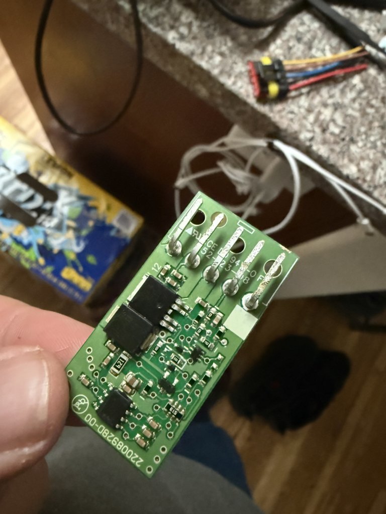

    Two Track Rick
    Two Track Rick Well-Known Member
    Mar 1, 2023
    #419094
    54
    2014 Toyota Tacoma TRD Sport
    I put the board in some "helping hands" [must have if you solder a lot] and then hit the white plastic connector with a small torch flame (being careful not to heat the board) until the plastic was soft - then the white connector pulled right off. Had to heat it once or twice, but it came off clean in under 30 seconds. No damage to the board, pins, pads or traces.

  5. Mar 10, 2025 at 7:54 AM
    #525
    Two Track Rick
    Mar 1, 2023
    #419094
    54
    There are some folks that posted the 5-wire connectors a few pages ago in this thread. That was the method I used and it seems to be working well. The module for the heated seat, while a little "browner" than it used to be, still worked on mine, and I reused it instead of paying the $90 for a replacement. After you disconnect it, just briefly heat up the white plastic on the pins with a SMALL butane torch, and it will slide right off. Then, solder the wires from the new connectors on the pins (use shrink tubing), then solder the new connector on the existing wires under the seat.
    This process is documented a few times in this thread.
  6. Mar 10, 2025 at 8:24 AM
    #526
    littlefish
    littlefish Buzz, your girlfriend...
    Sep 13, 2018
    #266147
    2,021
    Hudson Valley NY
    2016 TRD Off-Road DCSB
    The one who dies with the most stuff wins.
    Ok so you didn't solder the new wires directly to the circuit board, instead you attached them to the pins inside the female connector on the ECU?

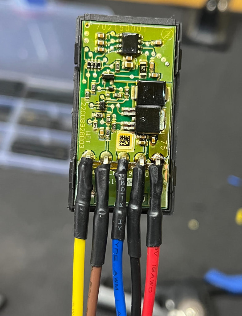

  7. Mar 10, 2025 at 9:45 AM
    #527
    Technique
    Technique Well-Known Member
    Nov 4, 2017
    #235046
    2,928
    Alex
    Utah
    2017 Silver Offroad DCSB
    -285/70/17 Toyo AT3 -Tuned
    That’s what I did. Popped open the new amp housing and soldering directly the pins in the photo.
    I would have tried this on my original “burnt” one but I cut those pins off and was going to try soldering directly to the board but failed miserable. So I just ordered a new one and soldered to the pins.

  9. Mar 10, 2025 at 5:37 PM
    #529
    Two Track Rick
    Mar 1, 2023
    #419094
    54
    Nope. Just make sure you keep the wire order the same from the amp to the new connectors, to the OG wires.
  10. Mar 10, 2025 at 5:49 PM
    #530
    littlefish
    Sep 13, 2018
    #266147
    2,021
    Hudson Valley NY
    Perfect, thank you. If all it costs me is the $15 connector and some time with the soldering gun this could have been way worse.

  14. Mar 12, 2025 at 6:58 PM
    #534
    jerkwithkeyboard
    jerkwithkeyboard Well-Known Member
    Feb 15, 2016
    #178231
    980
    Western suburbs Chicago, ILL
    2016 TRD Sport DCSB Inferno 4x4, loaded /JBL/Tonneau Cover/ Roof Rack
    17" Black TRD rims Tacoma Stainless Steel Rear Tailgate Letter Inserts Brake light flasher Center LED 110v and 2-3amp USB plugs mod in back seat center 400w on all the time mod SSR-610-40 SumoSprings 32 INCH 180W CREE LIGHT BAR (5D ) AUXBEAM BedStep and Pop & Lock Power Tailgate Lock Blue LED glove box light (fix no light) Bed light Blue LED's Wired to turn on when Gate is opened Tempered Glass Center Touch Screen Protector Rear Camera anytime Navigation Bypass ( a must) Rexing V1 3rd Generation Dash Cam hard wired in OXILAM 912 921 LED Reverse Light 2000 Lumens TRD Pro Grill TRD Skid plate
    Yep its not to hard to do, just so you know that the connector may be burnt to and shot, I just cut it off and added thicker wire to it. (an important step to pull heat away!)
    My post is a ways back, a few years now.
    Also do the passenger side while you are at it because mine was melted to.
