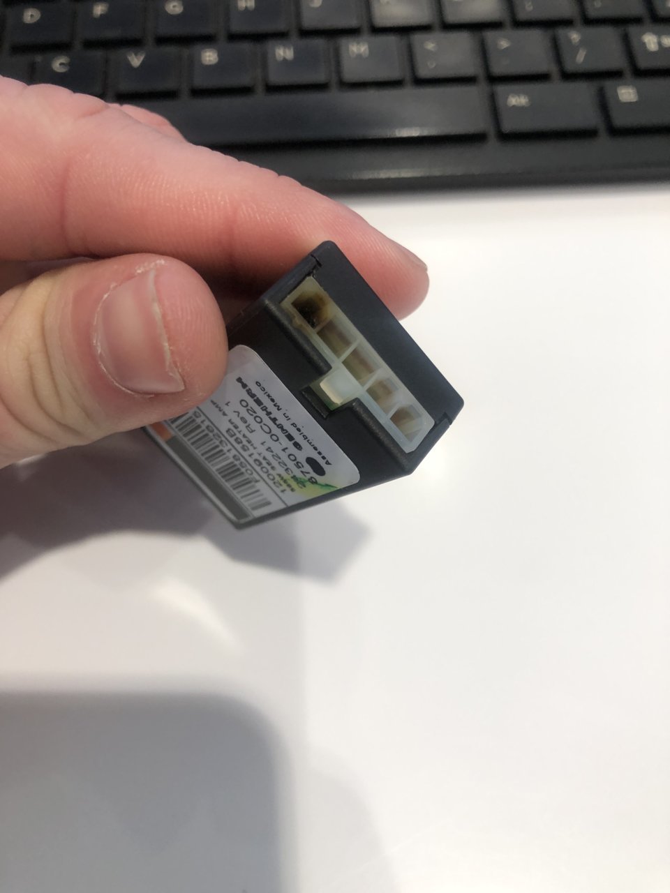

    I'll see if I can pull it up at work tomorrow. Just bought a 16 Trd OR and my amps burned up today going to call the dealer in the morning. I got about 44k on mine hope they'll cover it.

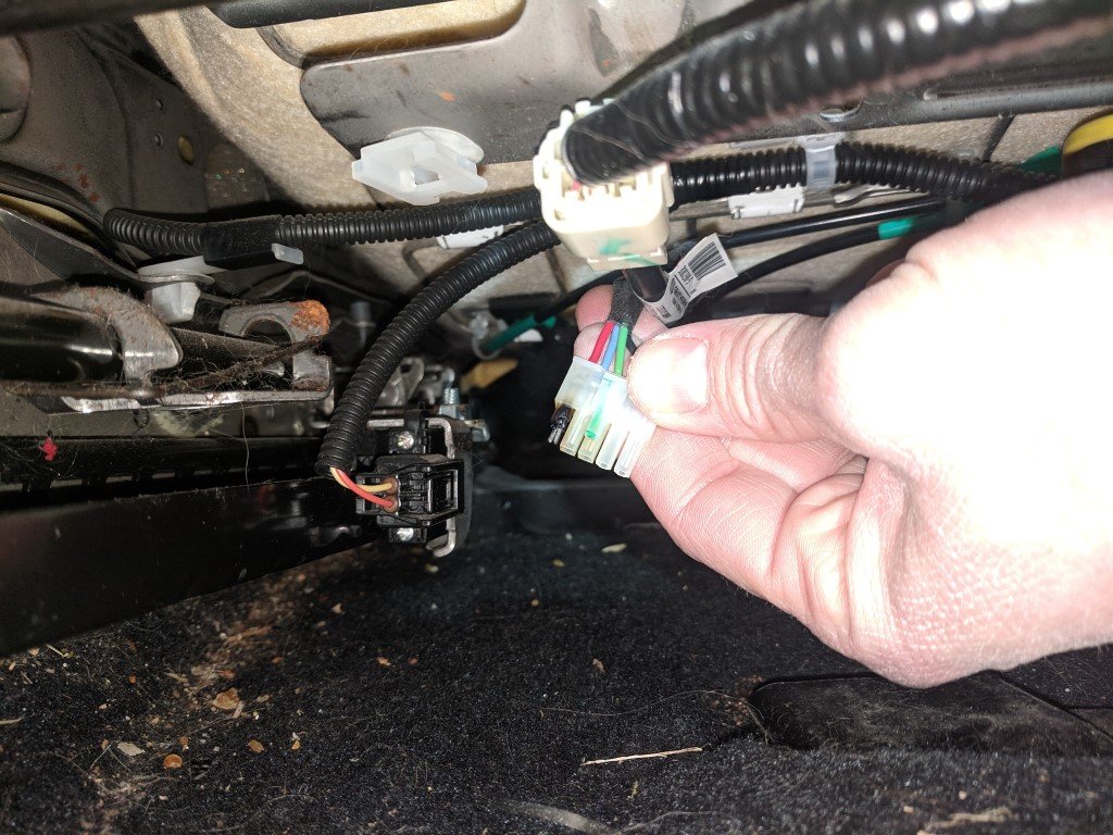

  15. Jan 11, 2019 at 10:08 AM
    #135
    BendTaco
    BendTaco Active Member
    Apr 3, 2016
    #183202
    26
    Justin
    Bend, Oregon
    2016 TRD off road Taco

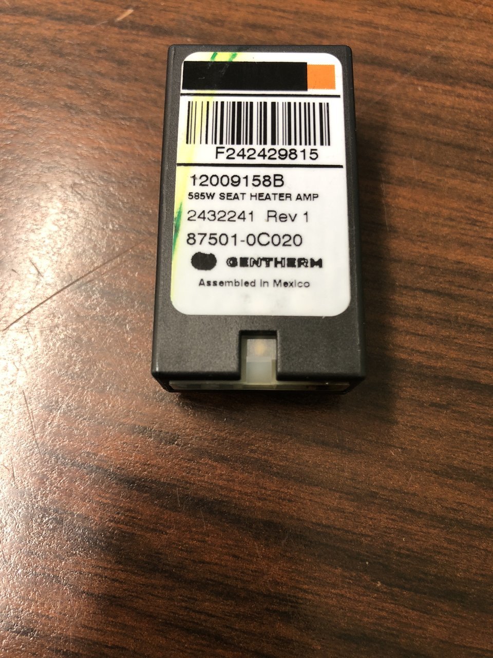

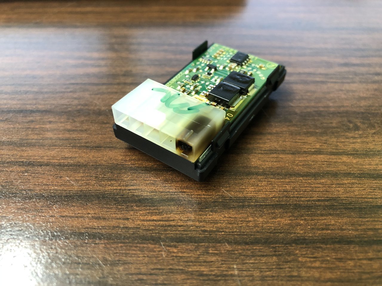

    Here’s an update, mine stopped working
    My drivers side heated seat stopped working as well, and looks to be the exact same failure. Since you can no longer just buy the module itself, I am assuming there is something wrong within the harness itself..... Best part is I have 300 miles and 17 days left of my factory warranty lol

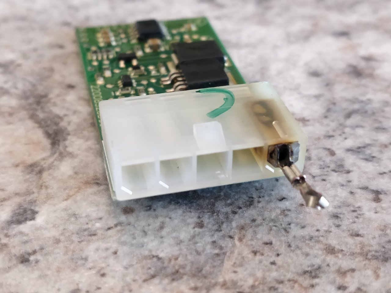

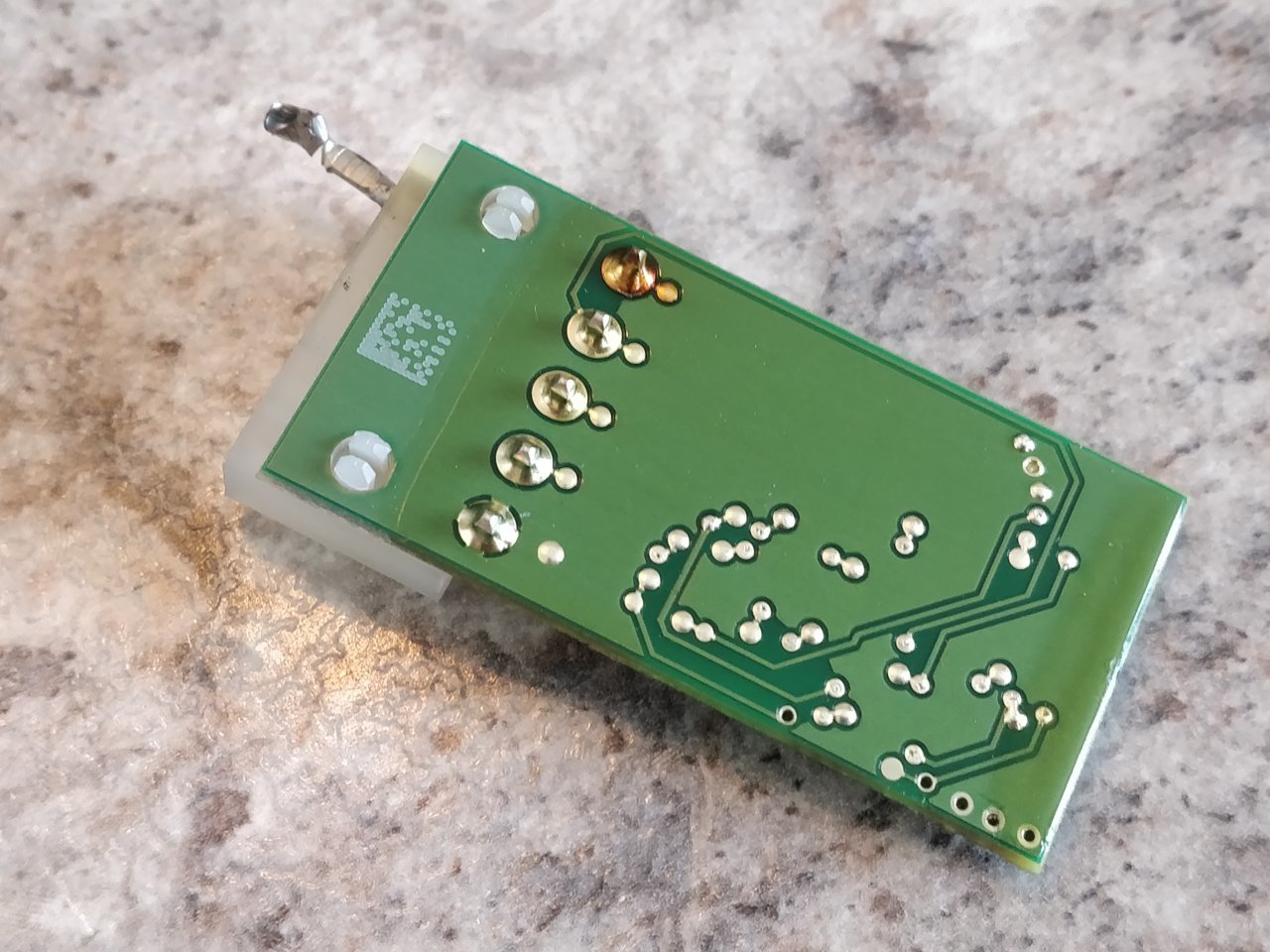

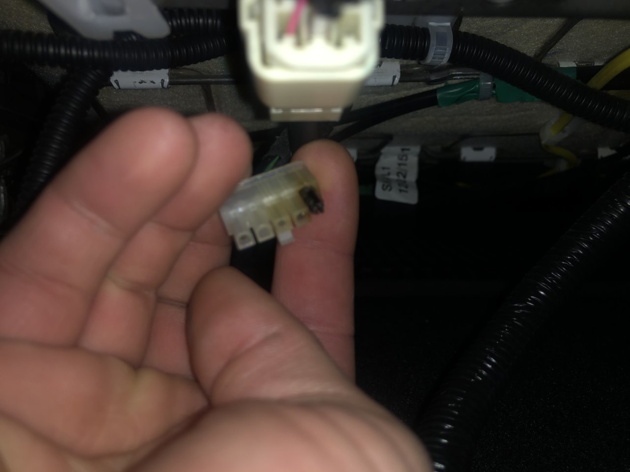

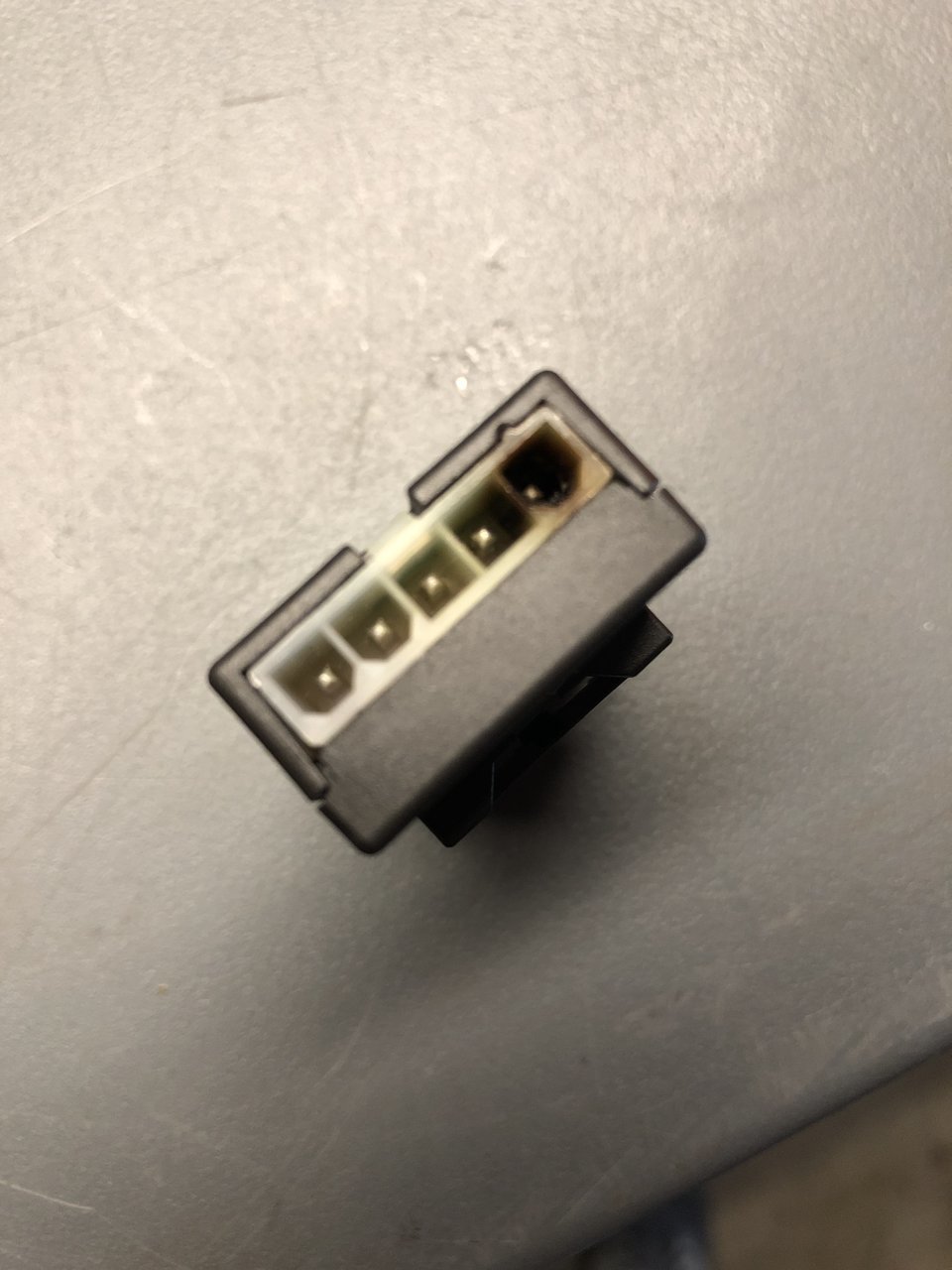

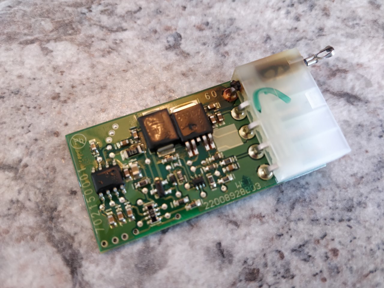

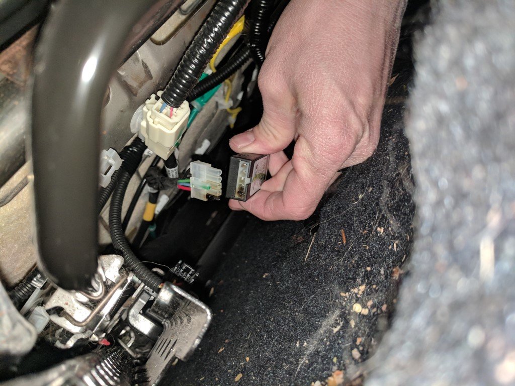

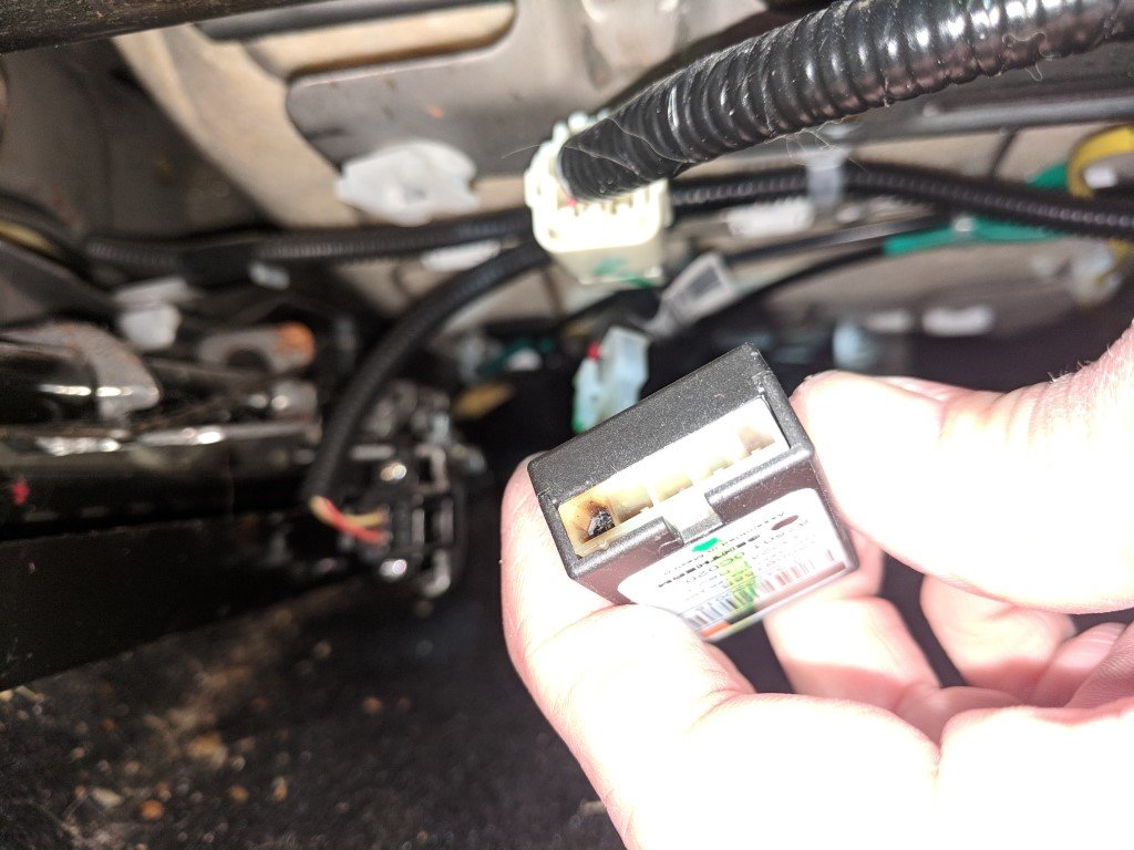

    One more. Just noticed the past couple days that my driver's side seat heater was not working. I checked the amp and it is also melted up on the first pin.
    2016 Limited 4x4 Built at the Mexican plant mid-December 2015 and picked up early January at the dealer. So I am a bit less than 2 months out of my 3 year warranty expiring, although 33,800 miles. So I guess it's time to call the dealer and if necessary Toyota to see what they can do about fixing it.
    The passenger side still works fine, so I unhooked that amp to check and it is completely fine at this point. But maybe I should be worried about that acting up in the future? Could be ok right now since it doesn't get used as often.
