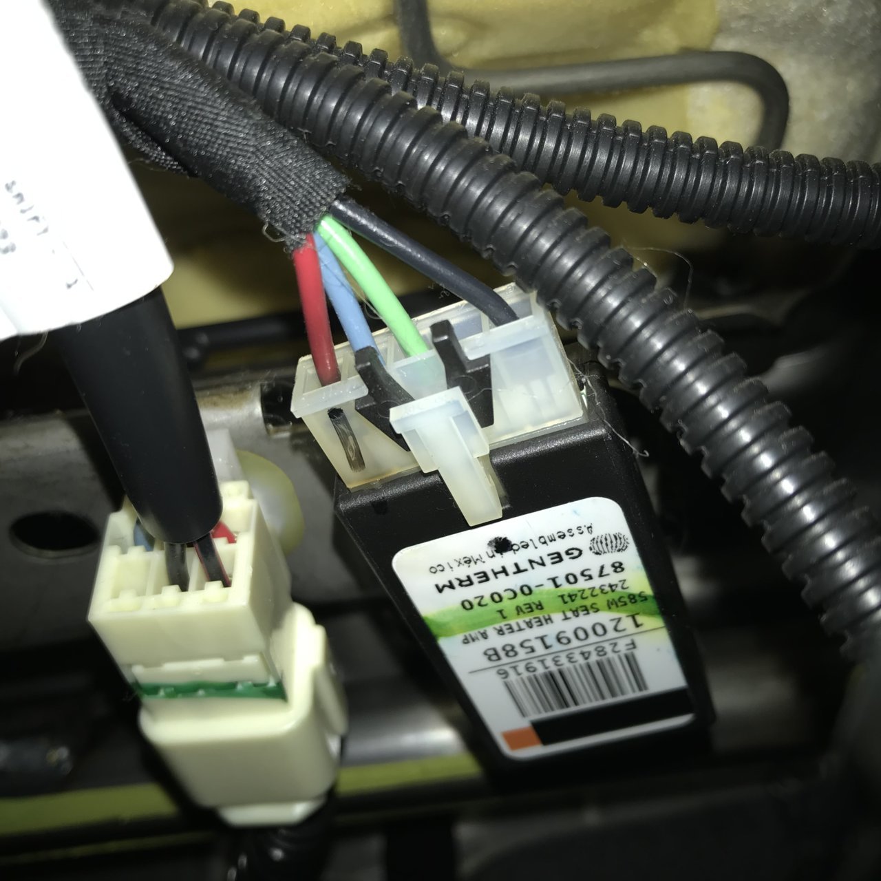

    Update to my failed seat heater. I called the dealer and booked a service appointment. Then I called Toyota to submit the issue. They created a case for me and told me to bring it in to the dealer to get it diagnosed and then call back.
    So I went to the appointment at the dealer, showed the melted part and explained my scenario being just outside of warranty, and that I already started a case with Toyota. They ended up giving me the diagnosis for free in the end, so that was nice. And they quoted me $533 for the repair with the new parts and labor.
    I then called back to Toyota to give them the information including repair price and a few days later they got back to me saying they would cover the repair up to $550. I just need to pay for it first and then send in my invoice. So at this point the repair is all covered for my drivers side.
    I just brought it in today to get it replaced, but unfortunately upon driving home I found it is still not working. I had the heat on high since I know it always gets too hot for me, but that did not happen. I called the service department to tell them and they said the tech had verified it was getting hot when he tested it. So who knows at this point. Hopefully they can find a mistake or something and fix it. Or worst case it ends up being more of a problem elsewhere in the seat? Can't really say I guess. I'm bringing it back in on Monday.
    They replaced it with the same part 87501-OC020. Which I thought was interesting since it seems to be a discontinued part number. All numbers are the same as the original except for the barcode. Except font size, etc of the print on the sticker is a little different than the original. But otherwise seems to be the same. So I suppose the wiring harness is the same part as the old one (that had melted), and they just cut the wires and must have soldered it on and taped them up. Maybe that part of the job was not done well. We'll see.

    I forgot to say that I also tested once I got home today by letting it cool down, then sit in my driveway with the seat heat on and came back 10 minutes later. The passenger seat was hot and the drivers seat was cold.

    This is clearly an ongoing problem since my 2013 seat heaters went out, but parts and under the seat look the exact same with even the same pin melting and failing

    My 13 same issue. Drivers side stopped working. Amp box burnt. Grabbed passenger and plugged in and it seems to kinda work. I checked continuity and it appeared good in the lower cushion. Wondering if switch is an issue. When I plugged test light into harness and dialed switch it simple turned light on and off. Would it not dim the test light when I roll the switch to low.

    Victim of failed heater circuit. 21000 miles. Red wire is toasted. IMG_0896.jpg

    Didn’t go down the rabbit hole. I got new seat covers and when I put em in I stole the ECM module outta the passenger seat and put it in the driver-side and decided fuck it let it burn down if there’s a problem I’ll go after Toyota

    So when you swapped the modules did it work? The passenger module plugs into driver side fine?

    Yes, so far so good

    How easily accesible are they on the 3rd gens?

    Very easy to access. About 6 inches in from the front of the seat and just over to the right
