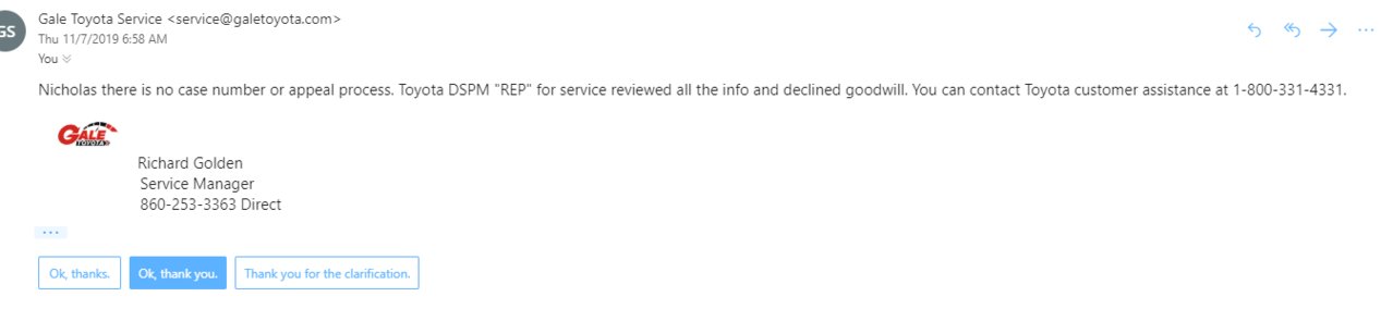

    so i tried going through the dealer first. they came back and said toyota said no. when you contacted toyota directly, did you get any kind of case number/documentation to refer to when going back and forth? i am just curious before calling them since its the same number
  7. Nov 7, 2019 at 5:44 AM
    #167
    roth_nj
    roth_nj Well-Known Member
    Sep 29, 2015
    #165396
    558
    2017 DCLB trd off-road bbp
