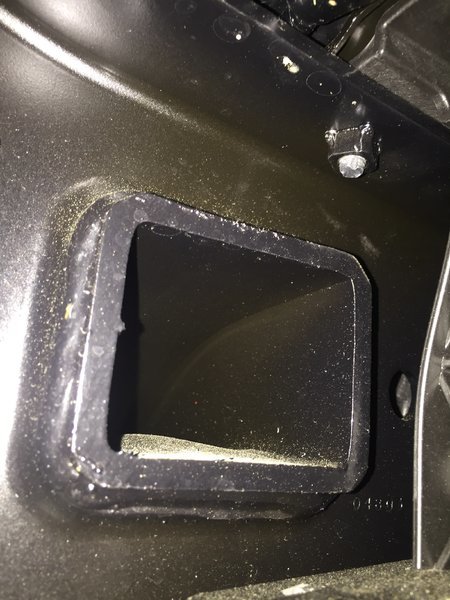

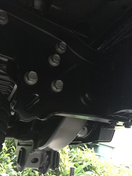

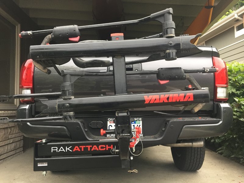

    Thanks. Here is a photo of the rack in the receiver. It is a pretty tight fit and there isn't a lot of play. I have been under the truck and the hitch u-bar has been welded to the bumper attachment brackets. I have an after market Curt receiver on my other vehicle that is bolted on and therefore has some adjustment. There doesn't seem to be a way to adjust this one.

    Id lose sleep over that first pic

    Are you able to push it look straight? Or do you have to fight to get it in?
    Also the hitch is not welded in, it comes in one complete assembly that the bumper reattaches to. The OEM hitch replaces the stock bumper hardware vs some aftermarket hitches go on inside or outside of the stock bumper brackets.
    You may be able to adjust it slightly as the same principles wound apply for adjusting the bumper angle as with the stock brackets

    Psssh. Level AF in Toyota's eyes. LoL Taco lean comes to mind.
    Seriously though that is way out of level.

    TA 4- There is some slight play inserting the rack into the receiver but it does not allow for me to bring it anywhere close to level.
    "You may be able to adjust it slightly as the same principles would apply for adjusting the bumper angle as with the stock brackets". Would you be able to expand on this? I was looking under the vehicle with the Service Manager and he didn't see any way to adjust it either. It looks to me that any adjustment to the tow assembly would affect the bumper alignment as well since the u-shaped tow bracket is welded to the bumper support arm. Thanks for any advice and/or guidance you can provide on this. I am starting to get very frustrated about what should have been a non-problem.

    Do you have something else that you can place in the receiver to measure the levelness? Like a hitch to tow your camper? Install the hitch and place a small level on top of it and check.
    Also, is the bike rack out of level when the rak attach is fully extended and open? Can you check level without the rak attach?

    I have a Yakima Fullswing that I use on my Tacoma. If I just put it in and tighten it, it looks crooked like yours and has a little play even when fully tightened. If I hold it level while I tighten it and wiggle it a little as I tighten the wedge, it sits level and is rock solid with no play.
    I think this has to do with the tightening wedge being in one corner on the Yakima attachment, which pushes it at an angle.

    Dilbert- The Rakattach does not have a wedge tightening system as you describe for the Yakima Fullswing. Do you know of any third party coupler that may act this same way? The Yakima Holdup also does not have this same type of attachment.
    Spindifferent- When I put the Yakima Holdup alone into the receiver, it is still noticeably out of alignment on the Toyota but not on the Subaru.

    Simple test. Park on a level piece of ground/driveway/parking lot. Take measure and get the distance from one side of the reciever, I.E. the driver,s side to the ground, and then the other side to see it the hitch is level with the ground. Also, is it level with the top of the bumper??

    A simple way to test if its level:
    (1) get a small/mini level like a picture hanging level or like the one here: https://www.amazon.com/Camco-25523-...8&qid=1496703570&sr=8-12&keywords=small+level
    (2) park on a level surface
    (3) place the level on top of your tail gate to get a base line (i.e. note/mark where the bubble is) as the level surface from step 2 is likely not 100% level. Also things like tire pressure, suspension sag, etc alll play into levelness so this base line will correct that.
    (4) clean out the hitch receiver of any dirt, etc
    (5) place the level in the hitch receiver.
    ...if the reading in 5 doesn't match that in 3, then you know its the hitch that is off.

    Is there a chance the male part of the Yakima attachment is not welded on square to its vertical member?

    Put the rack on your other vehicle and see if you have the same tilt.... if so, the rack is sub-par.
