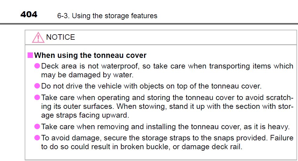

    They decided a disclaimer in the manual was easier.

    That’s terrible. Like “coffee is hot”. Don’t burn yourself. How about just stop making them or fixing them? I guess my A.R.E. Lids always worked (had three on three different Tacoma’s), was because they were single piece, over the rail. If Toyota couldn’t figure out how to do it right, they shouldn’t have done it at all.

    I have the factory OEM tri-fold cover and mine barely leaks. I ended up getting caught in some gnarly rain a few weeks ago -I'm taking torrential downpour and I checked the bed after the fact and it was wet in one spot at the front on the wall of the bed, and a few tiny left over "runs" of water from the corner on one side, but with the amount of water I went through I was very impressed with how well it held up! I know somewhere it says that the cover is water resistant, not proof, so you will get some moisture back there, but mine has impressed me so far. Pro tip, close your tailgate before you close the cover and make sure it clicks on both sides so you get a good seal.
