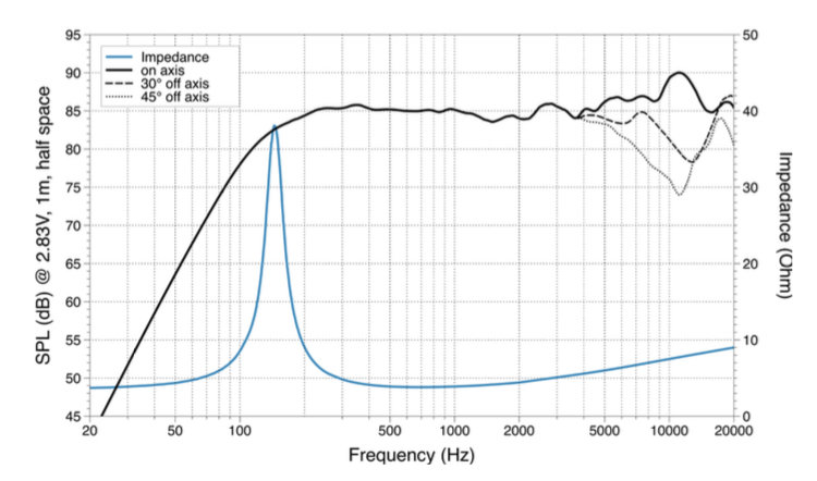

    I chose the AP 2 because it looked like the perfect speaker for this location. There's no physical modification of the space required, the bracket works, and this speaker handles 150Hz to 20kHz. It's like putting the entire sound stage in the dash. My only eh on these is their power handling, 25W RMS - 50W peak, but paired with the AP8.9 Bit, I think they'll do fine. My plan was a lower power SQ system for this truck anyway. If I don't like them, the AP690 goes up to 5000Hz and I've got some Voce tweeters I can toss in.

    Here's the AP 2 compared to the OEM dash speaker.
    I went ahead and soldered in the filter capacitor because for now I'm not bi-amping the front.IMG_5078[1].jpg
    Here it is all wired up with the parallel speaker adapter harness. I used silicone on the back of the mounting screws, as well as a dollop to hold the capacitor in place.
    This is what it looks like all mounted in there. The alignment with the dash cover is perfect.
    Here are some measurements I took after installing the AP 2 speakers in the dash. It looks to me like the Entune system is definitely aligned to the driver's seat based on these results. All the audio balance/fade and High/Mid/Bass controls are set to Null.
    Microphone is on the center console - Stock Dash Speaker
    Microphone is on the center console - AP 2 installed
    Microphone is in the driver's seat - Stock speaker
    Microphone is in the driver's seat - AP 2 installed
    The AP 2 is definitely more sensitive. To listen to music I had to turn the treble down several clicks. Without being able to do any EQ it's hard to say how smooth/flat I can get them, but I will say that they sound much more competent than the OEM dash speaker and I quite like what they sound like so far. It looks to me like they really want to be high pass around 500Hz. I think the filter capacitor is a 6dB Butterworth at 300Hz. I'll know more once I install the Bit and see what it does to de-tune the Entune radio output.

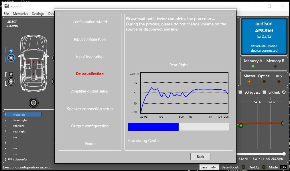

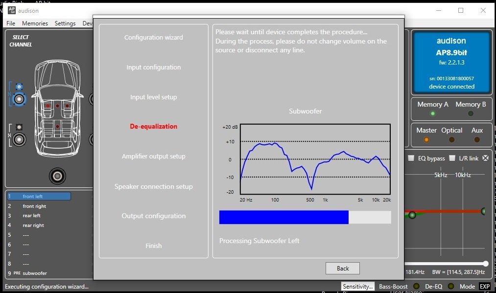

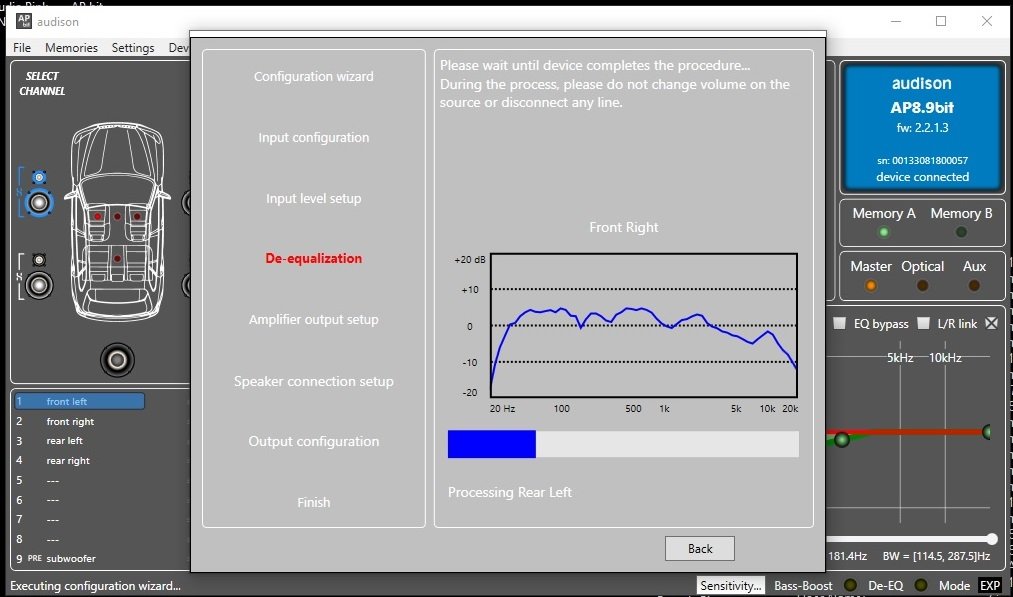

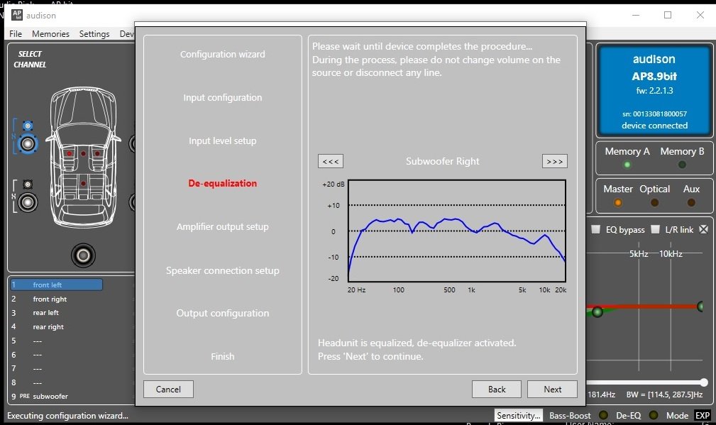

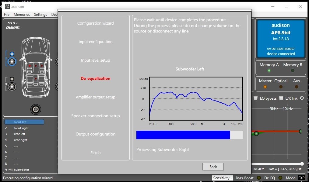

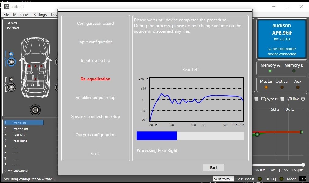

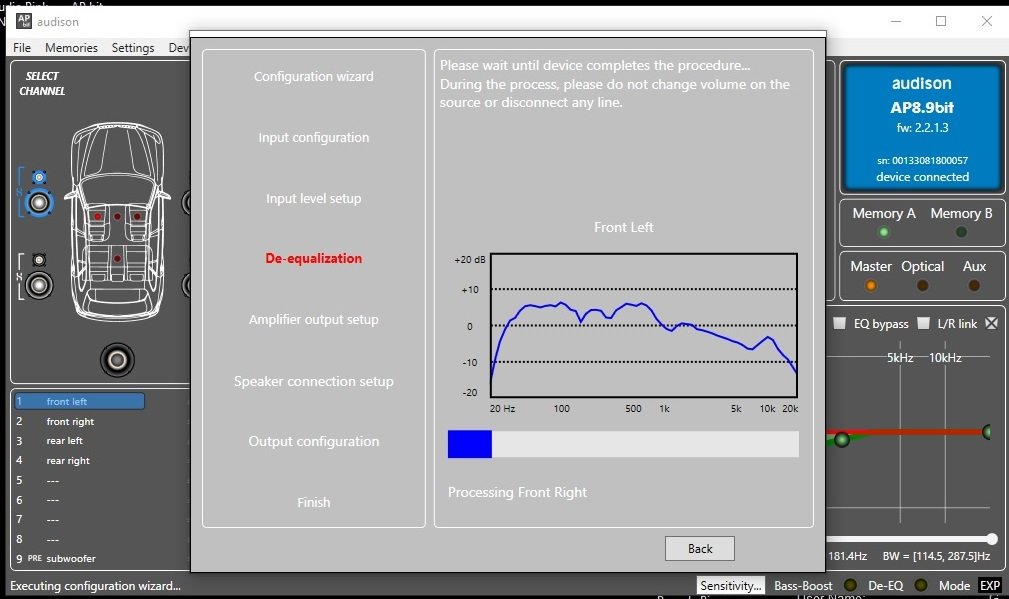

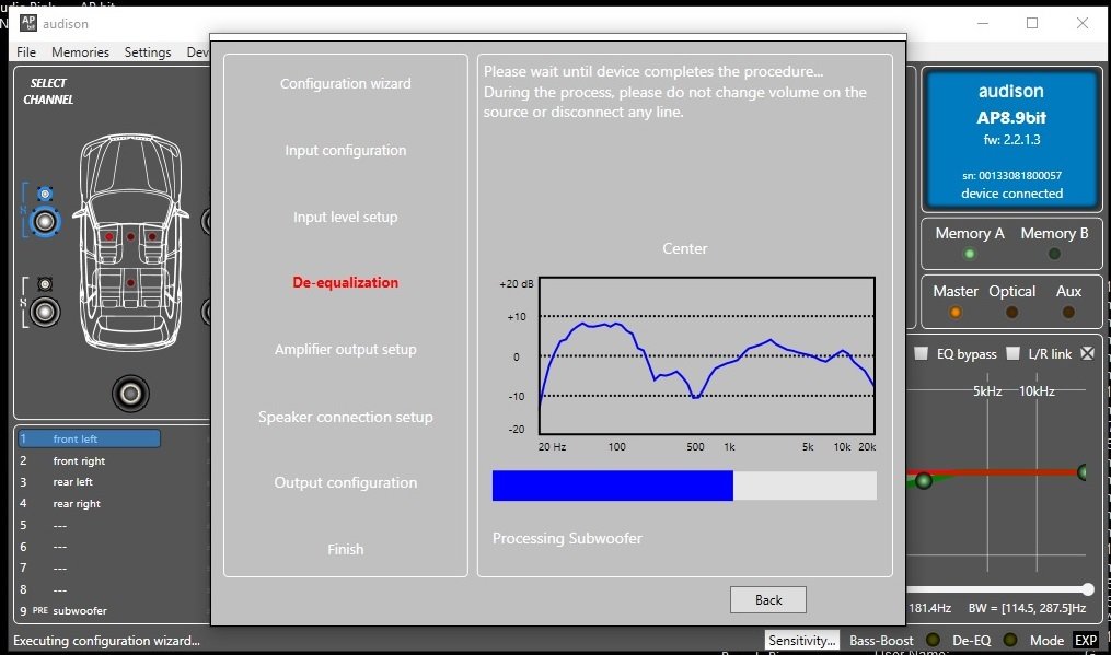

    This is a comparison of the response in the vehicle with and without the deEQ function activated. Based on these results, IMO the deEQ is total shit. I ran through it several times and I just don't understand WTF this piece of shit is trying to do because every time the results were worse than just leaving it disabled. I connected the speakers and took a listen to the Audison test files, the Pink Noise is band limited, which is fairly normal for setting levels, and it uses a Sine Sweep for the de-equalization process. You can only run the deEQ inside the Setup Wizard, and as far as I can tell, if you disable it and disconnect, you have to perform the process over so I don't think it keeps this file on standby in case you wish to enable it again. Annoying.
    Microphone is on the center console - deEQ on
    Microphone is on the center console - deEQ off
    Microphone is in the driver's position - deEQ on
    Microphone is in the driver's position - deEQ off
    Let me just say that personally I believe deEQ is a flawed concept irrelevant to these results. Often, at work when I'm setting up a large sound system there are several components in the signal chain that have the ability to manipulate the signal and I try really hard to only use one device rather than stack anything. This is simply because I think LESS EQ IS MORE, taking an input that has been equalized and then adding more equalization to it runs contrary to my philosophy of "leave it the hell alone if possible" because more EQ is just more potential distortion, more unnatural manipulation of the waveform, and in the case of deEQ, you could very well be turning something down that was turned up in the previous device. IMO this should be called counter-EQ, as that is a more precise description of what's happening.
    The same reasoning applies to crossover filters. When you have crossovers in your stereo and also on your amplifier you have to pick one. When you set a low pass on the head unit, then stack another crossover filter from the amplifier, even if it's the same frequency, all you are doing is skewing the signal's phase even more. Consequently, if you want to time align, you're making larger adjustments.
    Anyway...
    After I decided to leave the input equalization disabled, I ran a quick tune and here's what the result looks like. I left the microphone in the driver's seat for this.

    I think they sound really light and detailed. I agree with the spec sheet that there is definitely more sugar up top around 10K. There is a midrange spike that I tuned out but I don’t know what the source of that is yet, so I can’t say for sure what their response looks like because I can’t see any of the tune in the factory radio outside of the treble/mid/bass controls.
    I will get a lot more time with this system in the next couple of days and I’ll be able to take a lot more measurements, play with the BIT DSP more, and maybe get them bi-amped.
    People all the time are wondering whether to go Audison or Hertz, and while I don’t have a lot of seat time with the Audison stuff yet, they pretty much are what I thought they would be, like two children with different personalities but otherwise very similar. Hertz is the brand with huge balls, adventurous, always wanting more. Audison, at least this Prima stuff, sounds very disciplined and in control with a lot of space and nuance. I love them equally, but for different reasons.
    Im still trying to coax out the lower midrange. Some bass lines sound great, but others sound buried behind the kick. I think I can work it out but I haven’t had time this last week to dig into it.
