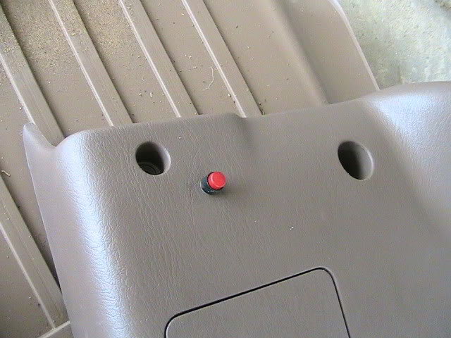

    If the light is also a button then it is the securikey+. Here is a pic of what my button looks like and where it is located. It is just above the fuse panel.

    The red LED light is not a button, just a light but it never is on or blinks.

    Just call your dealer and give them the VIN #. They can tell you if keyless was installed before sale.
    The history on keyless with the tacoma is that there wasn't any. What they did is at the buyers request took a Toyota compatable system from one of their other vehicles and installed it in the tacoma. The model RS3000 keyless/alarm is what was used. Good luck finding one at the dealer.
    Judging by your picture it looks as if you may have an aftermarket alarm. Hopefully it was installed right. That is my pet peeve on buying modified vehicles, people splicing into the stock wire harness and hacking up other parts of the truck. I like always starting stock.
