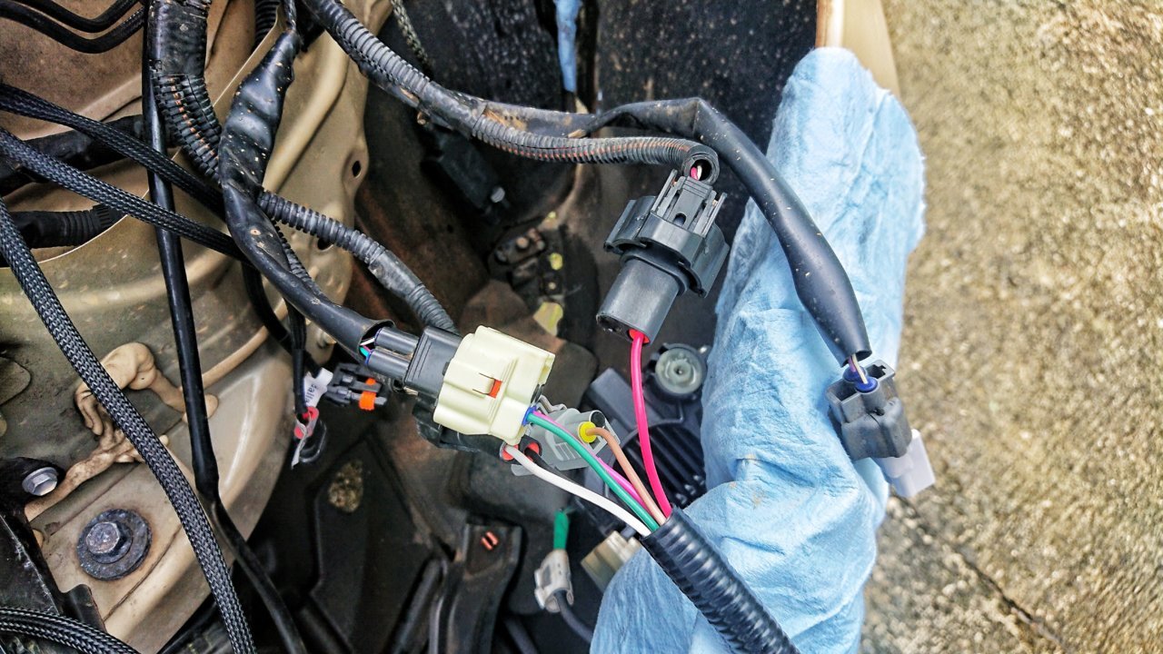

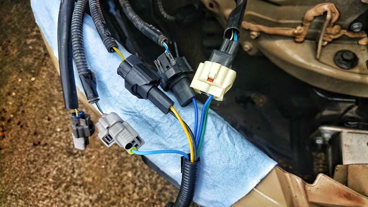

    The harness itself is identical for both sides, so you can technically swap sides. The only difference is each of the individual wires are color coded to match the OEM wiring on their respective side to help prevent user error.
    Notice the wire colors from the aftermarket harness to the OEM harness.
    Passenger side:
    Driver side:

    Dave explained it too...that they are identical on each side.
    I was focused on doing it right which saved me because I did not mark the cables (high/low beam) when I removed them.
    The color codes helped me figure out which wires matched.
