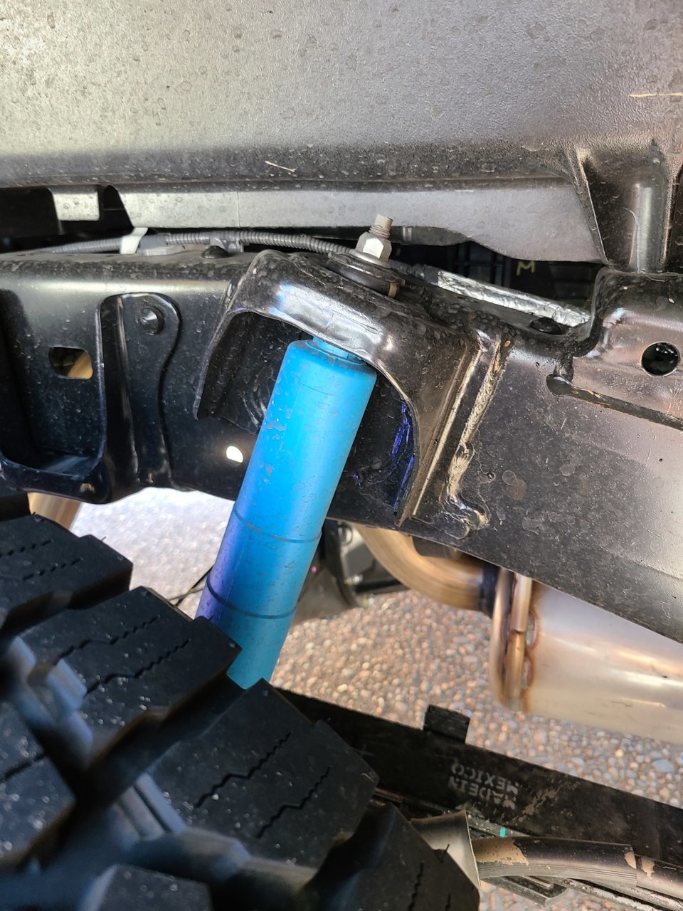

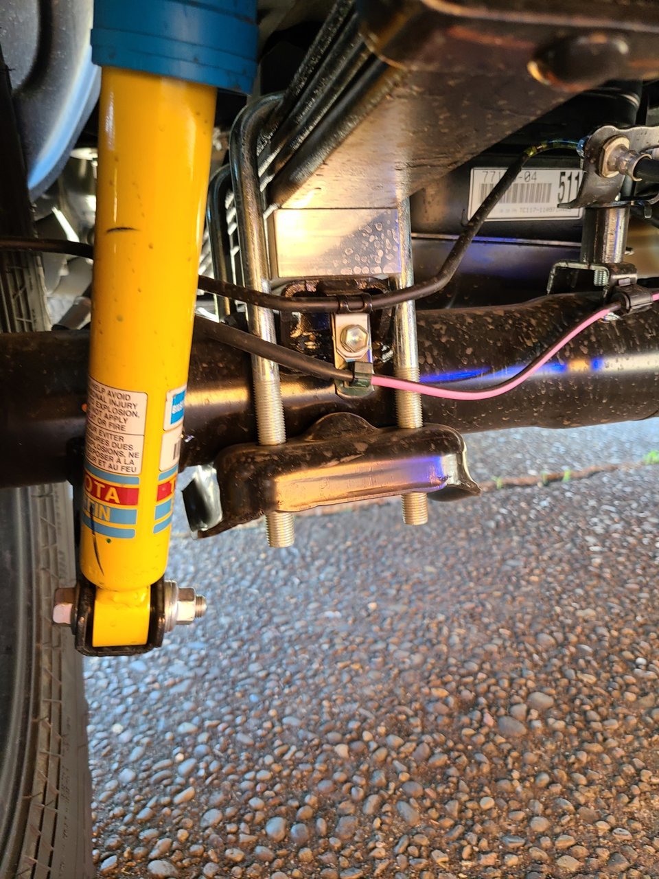

    Hi all,
    I just got a taco from the dealership with 2 inch factory lifted. The lift they put seems to be a Bilstein 4600 blue and yellow finishing. The truck also runs on 285. I thought for any lifting this has to be done on a 5100.
    Any thoughts?

    You have a spacer lift, they use the factory sport Bilstein's that come with the truck, those are OEM not 4600.

    Looks like they put in spacers to give you a lift. If you're just staying on pavement, you're probably ok, but if plan on any serious off-roading, they're probably not a good idea. I'm still just a novice, so I'd see what other more experienced folks have to say.

    Spacer lifts are fine if you're on road 80% of the time or do any mild off-roading. If you start noticing your rear to sag, I'd upgrade your leaf pack from OEM to aftermarket.

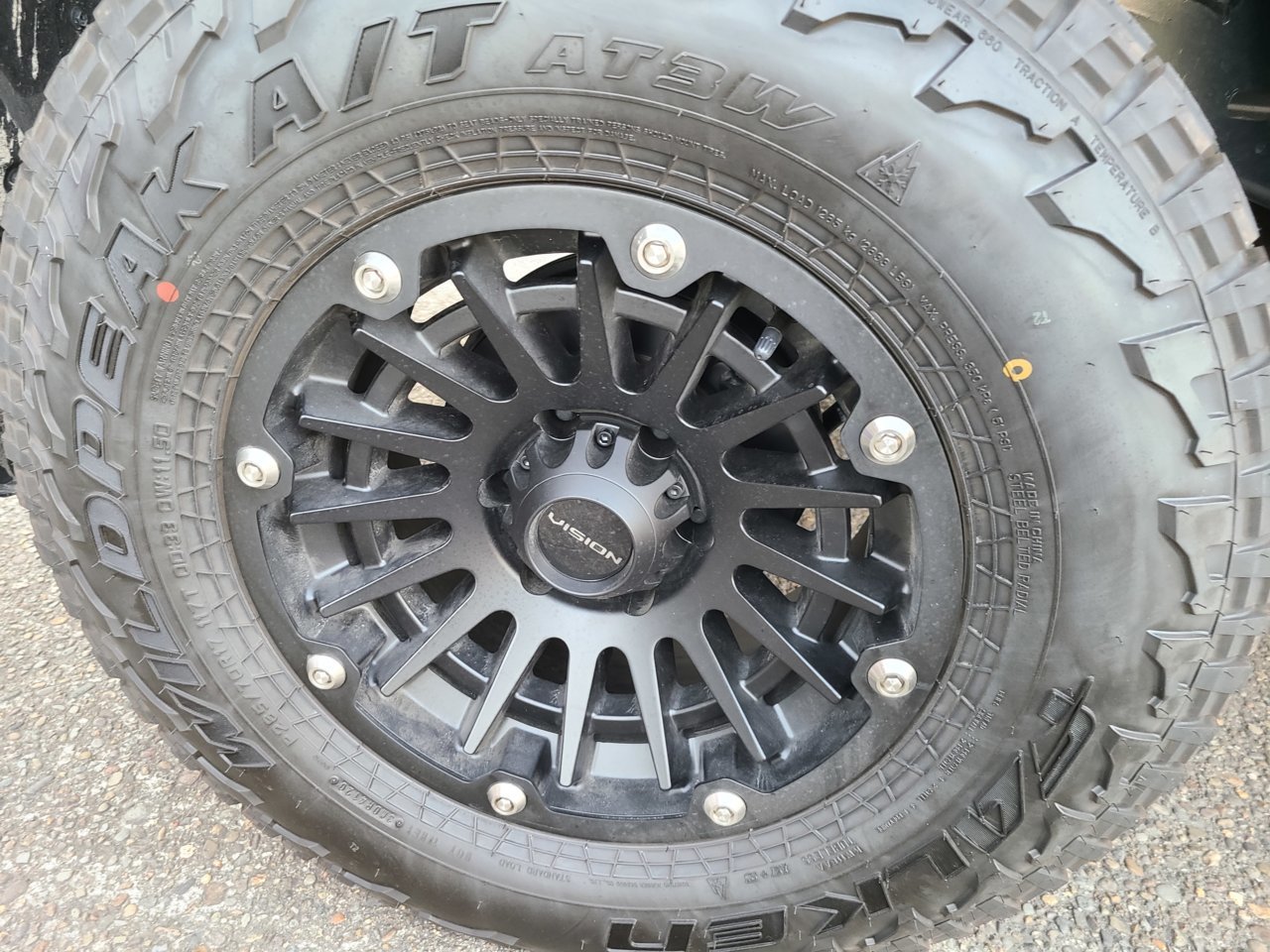

    will spacer lift be the cheapest way to fit 17x8 -10 offset with 275/70/17 with no rubs?

    Simple answer is yes. If u go with KO2, they tend to run smaller than other tires, shouldn't be an issue

    in no way is that a "factory lift". the toyota factory doesn't offer that.
    Looks like you have a dealer add-on spacer lift. Pump up for looks and more $ at sale
    There is a Toyota lift, installed at dealer, but this ain't it. See here:
    Toyota TRD OEM lift kit | Tacoma World
    sorry to deflate your excitement for your new truck

    Yeah , no . Thats not a factory lift. Unless its on a Trd Pro, factory lifts dont really exist.
    The only current Toyota branded option is the port or dealer installed TRD lift kit which includes rebranded Bilstein 5100s on all 4 corners and 1” spacer blocks in the rear.
    What you have may be a poorly worded ‘factory style’ lift, and yes typically that involves replacing the rear shocks with 5100 or equivalent for longer reach when using a block or add a leaf.
    What I see is a very low cost decoration, using the factory Off Road Bilstein rear shocks. Im not trying to be a dick but thats a more accurate description.
    To answer one of your questions, The OR shocks pictured are Bilsteins , similar build to 4600s, while factory Sport shocks are Hitachi and all blue.
    What does it have going on in the front as far as lift?
