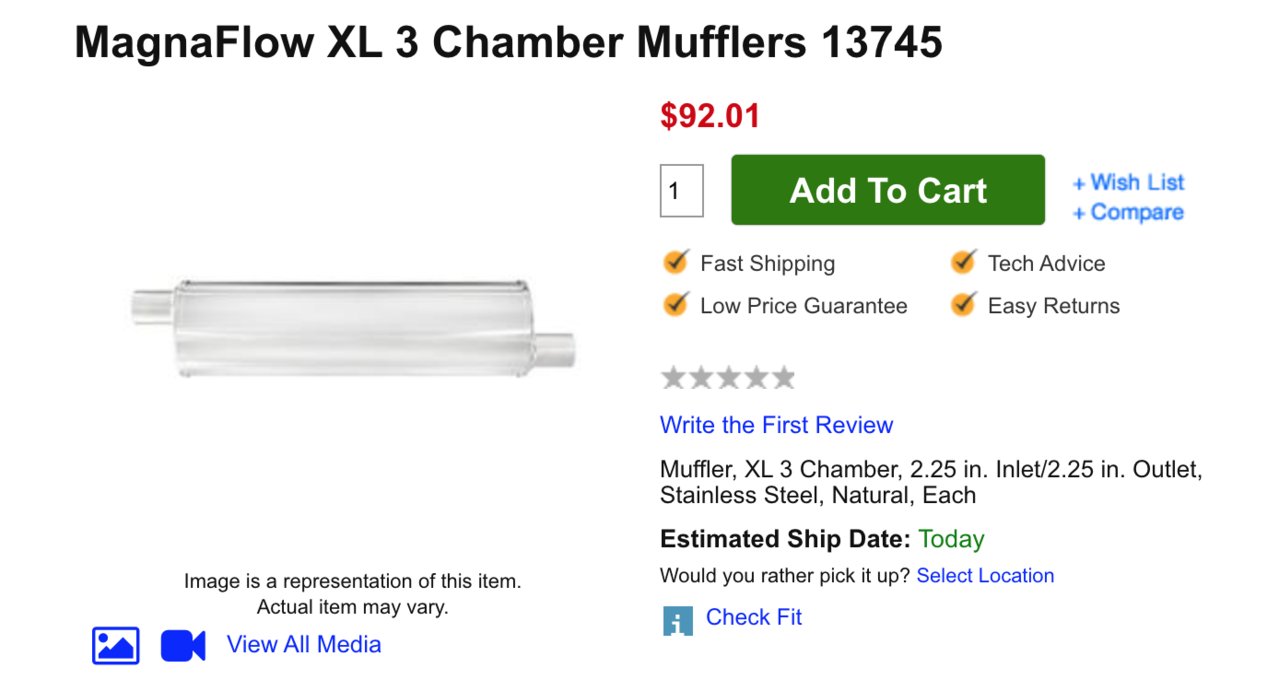

    I researched and ordered this stainless Magnaflow muffler from Summit. I wanted to replace JUST the factory muffler (split right down the center seam). This muffler is the exact length as original, and the in-and-out pipes are staggered like the original. All you have to do is to fashion a hanger (not too hard at all).
    Fits perfectly with the use of a stainless band-clamp. If you have never used Band-clamps, you need to check em out. We used them in the trucking industry all the time, so I was used to spec'ing them. They are permanent and you don't have to weld any pipes together.

    Go for it with the glasspack if that's what turns your crank; I will stick with my stainless steel $92 muffler ;-)
