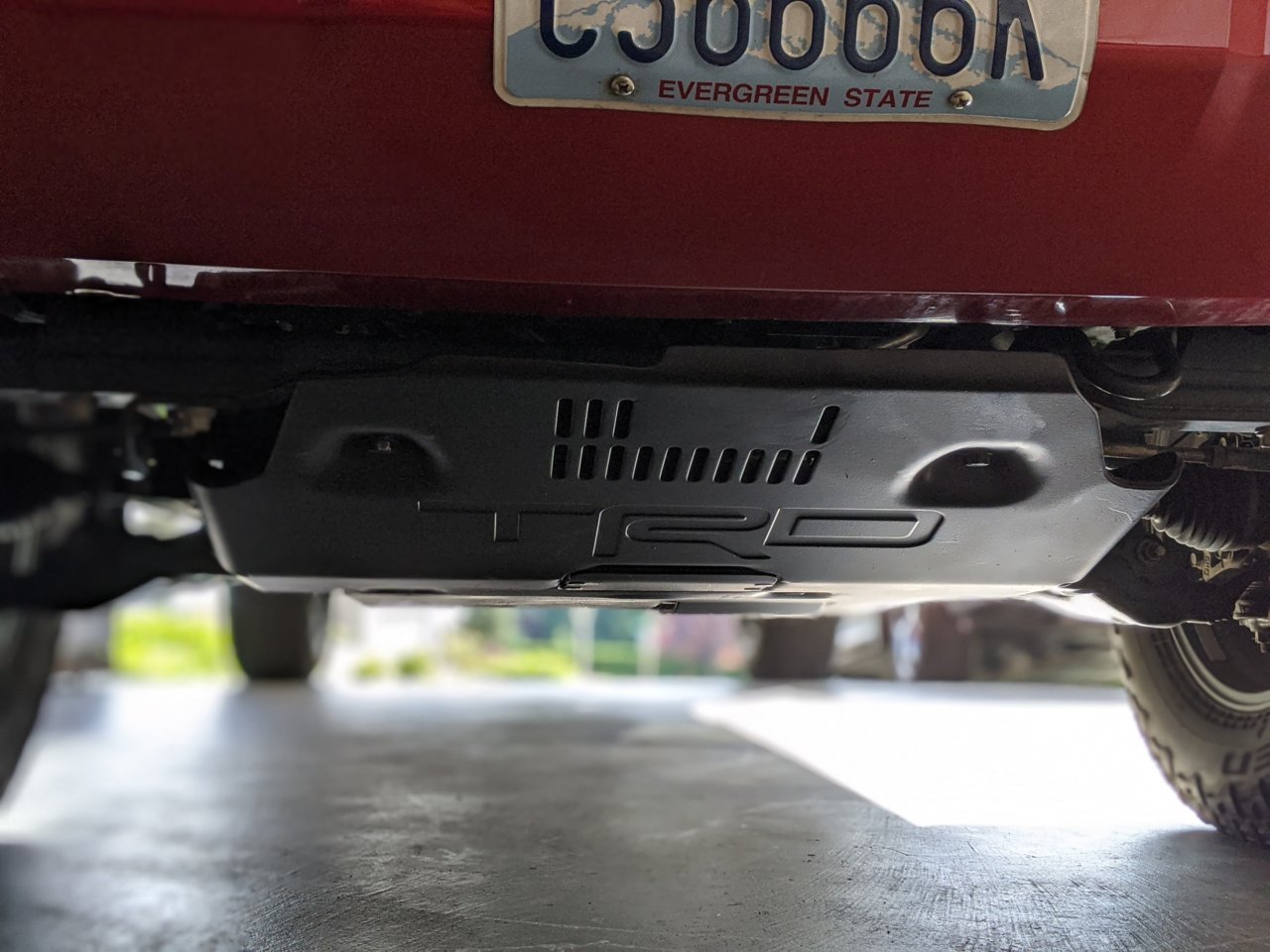

    The stock OR ones are the same as the Sport, just go back to the suspension crossmember. The Pro works on any Taco.
    I couldn't resist painting the used one that I got.
