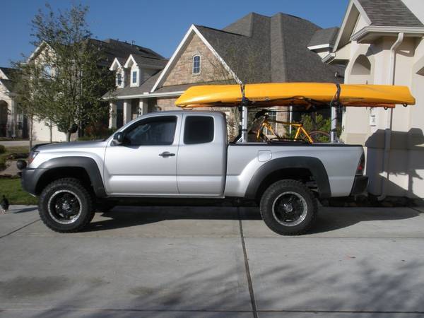

    flatlander, sounds like you're looking at a setup like this...

    Yep Moose, I've noted your set-up before. Looks about right, but I think I'd like two cross bars for the added versatility so I could have the option to use the bed extender or not. I have an undercover tonneau that I'd like to leave on but negates the use of the bed.
    Doesn't sound like anyone has anything bad to say abou the OEM rack so I'll probably go that route. I can always add a Yak cross bar for about $110 if I'm not comfortable with the job it's doing.
