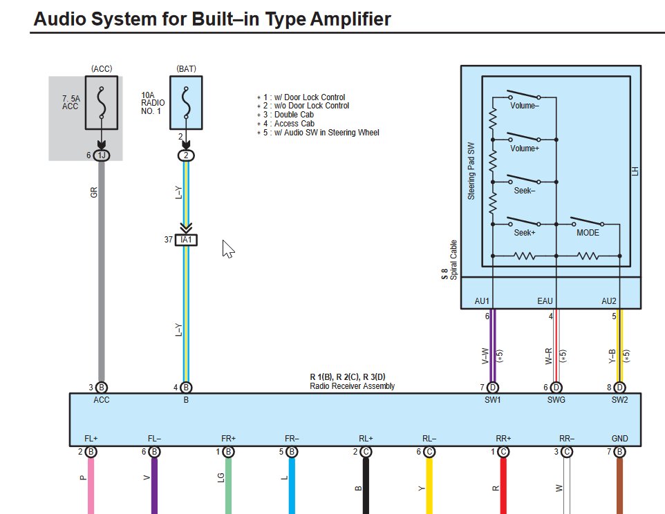

    I just upgraded my entune radio on my 15' PreRunner and forgot to get my CD out. Does anyone know how to get a CD out once the radio is out of the truck? Anyone know the pin that gets power to the unit?

    If you are connecting via a standard adapter. You will want the Red 12 Volt switched power and the ground.
    Or the Factory schematic:
    Once you have power and a ground you can simply eject the CD.

    Thanks Jimmy! That's exactly what I needed. :cheers:
