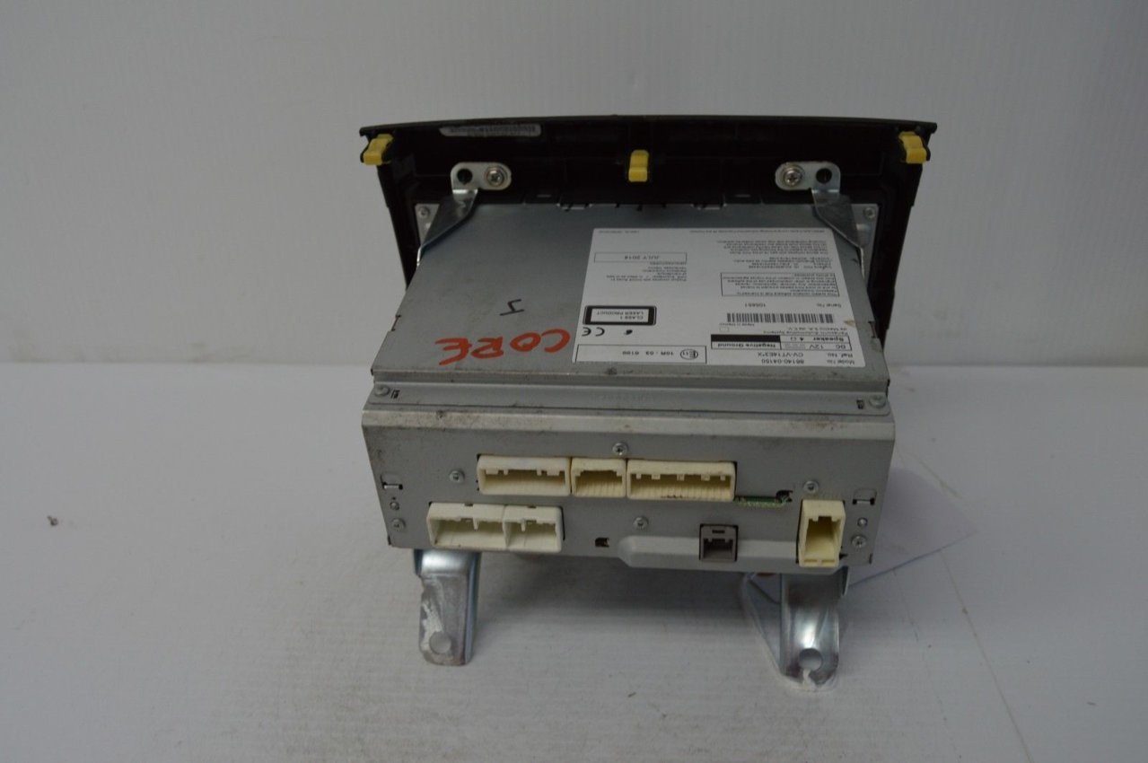

    We have it in my wife's van and i've been spoiled listening to it so now i'm hooked. I have a 70 mile commute every day so it would be nice to have it in my truck.

    I'd be happy to sell the radio, however you can't run an XM module on it...
    The factory programing won't allow it. :annoyed:
