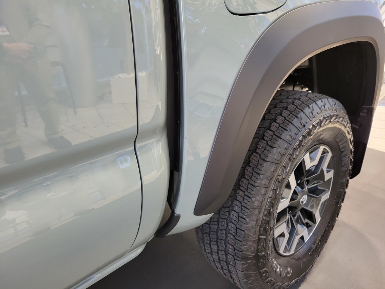

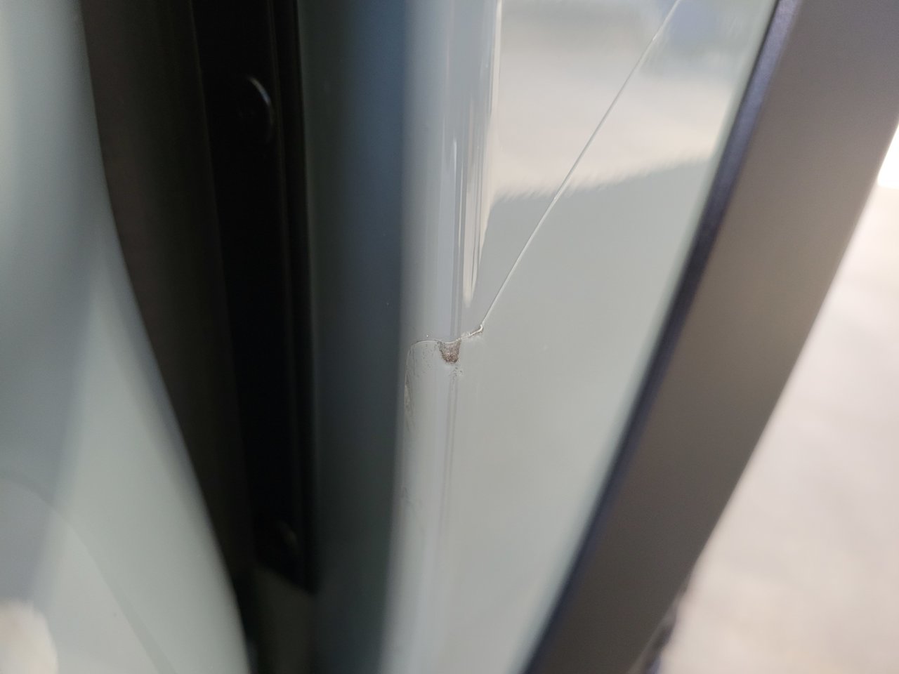

    Hey everyone!
    Just picked up my 2022 TRD OR Premium in Lunar Rock a few weeks ago. When I was taking delivery I noticed the rear vinyl stone guard (on the box infront of the rear flare) hadn't sealed from the factory correctly. It's lifted and dirt is in it, and it's driving me nuts as it's a light colour.
    Any ideas on if/how it can be lifted, cleaned, and re applied in that little section or is a full replacement needed? Not too keen on sending a truck with 35 km's on it off to an unknown body shop and having the front plastic piece on the corner, the rear flare gasket, and the rear flare taken off for full access to remove the entire stone guard. Tried searching but by the looks of it I'm one of the unlucky ones as I wasn't able to find anyone else with this issue.
    Hopefully the photos show up!

    Trimming that small section off is definitely an option, any tips on doing that without damaging the paint underneath?
    Dealer said they'd sent it off to a body shop as they're not sure how to fix it properly. I've had pretty bad luck letting anyone else work on my stuff so I tend to fix things myself. Unsure of the part number on the rear flare gasket/ couldn't find one and the front corner plastic piece.

    I would go bye the dealership, show them, have them order the clear rock guard and call me when it comes in. It can't take but about 30 minutes to heat the old one up, remove it and attach the new one. Its very simple or take a fine marker and trace off the bad spot,be neat and trim it off with a trim razor blade. No reason for the dealer to keep he vehicle over night. If it were mine I would fix it on my own and the part can't be anymore than $25 which is less aggravation than dealing with the dealership.

    Its just feel and being careful. Relace the whole thing by heating it up with a hair drier, clean off the old glue, wipe it down with grease and glue remover and attach the new one. Make sure the surface is clean and not cold. Doing it on a nice 80 deg. day is perfect.

    I would peel up the corner, cut it when it’s not touching the paint, then press it down after heating it up a little with a heat gun. If it doesn’t stick, I’d add a drop of adhesive.

    Trim around the dirt section with a very sharp knife lightly. Don’t go all the way down to the paint. Then peel it off…wwwola…. OR take it to a body shop as the dealer suggested. It’s a very easy and minor work. They could not be screwing this up.

    The dealer ended up paying for a shop to take care of it. Apparently the guard was applied slightly crooked from the factory, which explains the gap.
    The fender flare and front corner piece had to come off, new decal and clips, back to looking how it should have! Some scratches on the fender flare now but I'll take that over paint/ vinyl problems.
