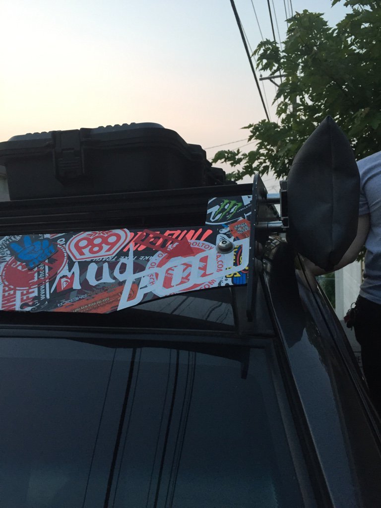

    How does your rack handle the shark fin?
