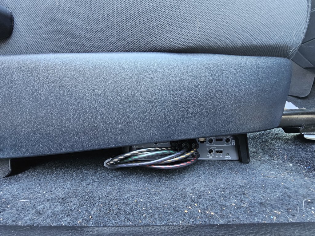

    i have the gm-dx975 powering 2ohm kappa speakers (the 100w rating is 2ohm only but has been proven to actually put out well over rated power). and yes i replaced all the wires with 14g ofc wire. oem audio plus recommends upgrading wiring over 75watts rms so thats what i did.
    when you say 9 wire do you mean your running the amp off the high level inputs?

    no, its just speaker wire plugged into the wire harness then to the amp. My rcas are sending the signal to the amp then the 9 wire back to the speakers
    man running the power, amp turn on, rcas, and 9 wire was already a huge pain in the ass. Dont even know how to go about running new speaker wire

    i ran through center console. amp under the seat. was fairly easy.
