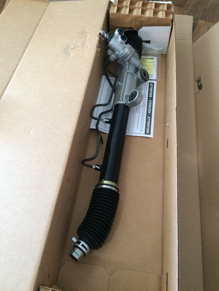

    I bought and just rec'd this brand new steering rack...
    partsgeek.com A1 Cardone New Tacoma Steering Rack
    Since I am replacing the inner tie rods, I also ordered new Moog outer tie rod ends, also from partsgeek.com.
    This, combined with two EMPI CV axles was $586.00 delivered to California.
    It took 7 days from order placement to receipt.
