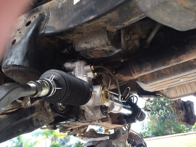

    Just installing it as we speak...so I will let you know any issues....

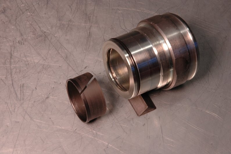

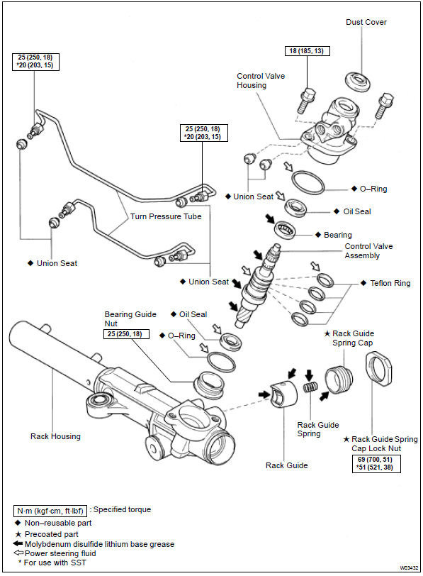

    For just the guide this is pretty good. It is really just a matter of unscrewing the cap or "adjuster", plucking out to old guide with a magnet and sticking the new style back in. Of course there is some cleaning involved plus the final adjustment of the preload.
    There could be some confusion with the term "bushing". There are 3 rubber rack mount bushings holding the rack to the frame that are commonly replaced, lots of talk about that. Inside the rack is a single plastic bushing that serves as the bearing for the passenger side of the rack shaft. It's inside the rack "end stopper"
    that also secures the passenger side seal. You just pluck it out and slip in the new one.

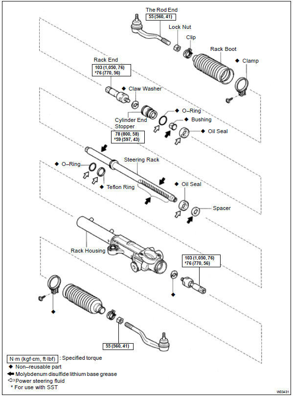

    Rack "end stopper" and bushing.
    The 2 rack shaft seals are not very tight and can easily be removed/installed with the motive force of a hammer instead of a press, even just a rubber hammer. Just be careful and tape up what ever you use as a driver to prevent scratching the inside of the rack body. It's all in the write up.
    Also nice to see is the factory service manual "exploded view". Handy for the order of the seals spacers and o-rings inside. I'll put that up a bit later, it's happy hour now. ;)
    Here she be.
