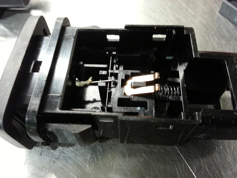

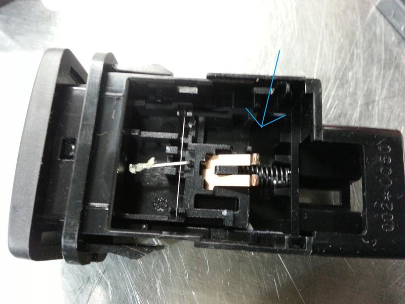

    Sorry for taking a bit to respond, I will try to give you some insight on what to do.
    So to get the switch apart just use a small screwdriver and pry out the small rectangular back part. it will slide out and then you will see what i have pictured
    These pics are of a fog light switch, so this is how a fully functional latching switch will look. There are only 3 small differences between the switches that latch and the ones that are momentary.
    First is where the blue arrow is pointing in the first pic (should be there, it was a while ago). On a momentary switch there is a white plastic plug thing. It keeps the switch from being pressed completely down, so that will need to be removed. it literally just pops out if you use a pick or screwdriver.

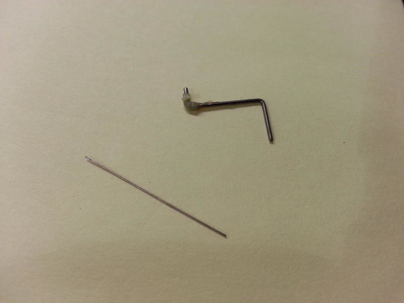

    Next are the 2 small metal pieces. This is what does the actual latching. If you look at the piece of the switch that you removed earlier (sorry don't have a pic of it) you can see the actual track that this metal piece slides into. as you push the button it moves in the track and eventually gets stuck by design which keeps the switch depressed. when you push it again, it moves further and comes back out. The tricky part about doing this is that you need to make these metal pieces... I believe i used a single staple, or possibly unwound a small spring i had and used that. either way you can see it is very small diameter metal. The one with the bends also has to be pretty precise. if it isn't the right shape then it won't work. it took me a few tries to get it right
    So the hardest part is getting that angled piece perfect. if it's not, you will know because it won't feel smooth and in my case it would latch, but then get stuck and not unlatch, so you have to take some time to get it right. I don't know how much sense this makes to you right now, but it will help to take apart one of your other latching switches so you can make sense of it. Also makes it way easier to try and duplicate those small pieces. Let me know if you have any other questions and i will do my best to answer them. Let me know how it goes.
