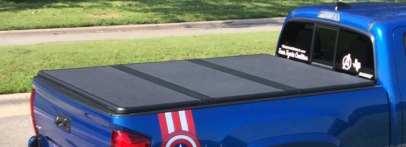

    If you're already getting the Extang Solid-Fold for $520, you got a great deal on it. It's a strong cover and holds up extremely well.
    Be happy with that.
    This is how the 6' sits. Flush to the bed. Doesn't leak where it touches (water gets in around the tailgate, something the OEM doesn't stop either, hence the MaxSeal).

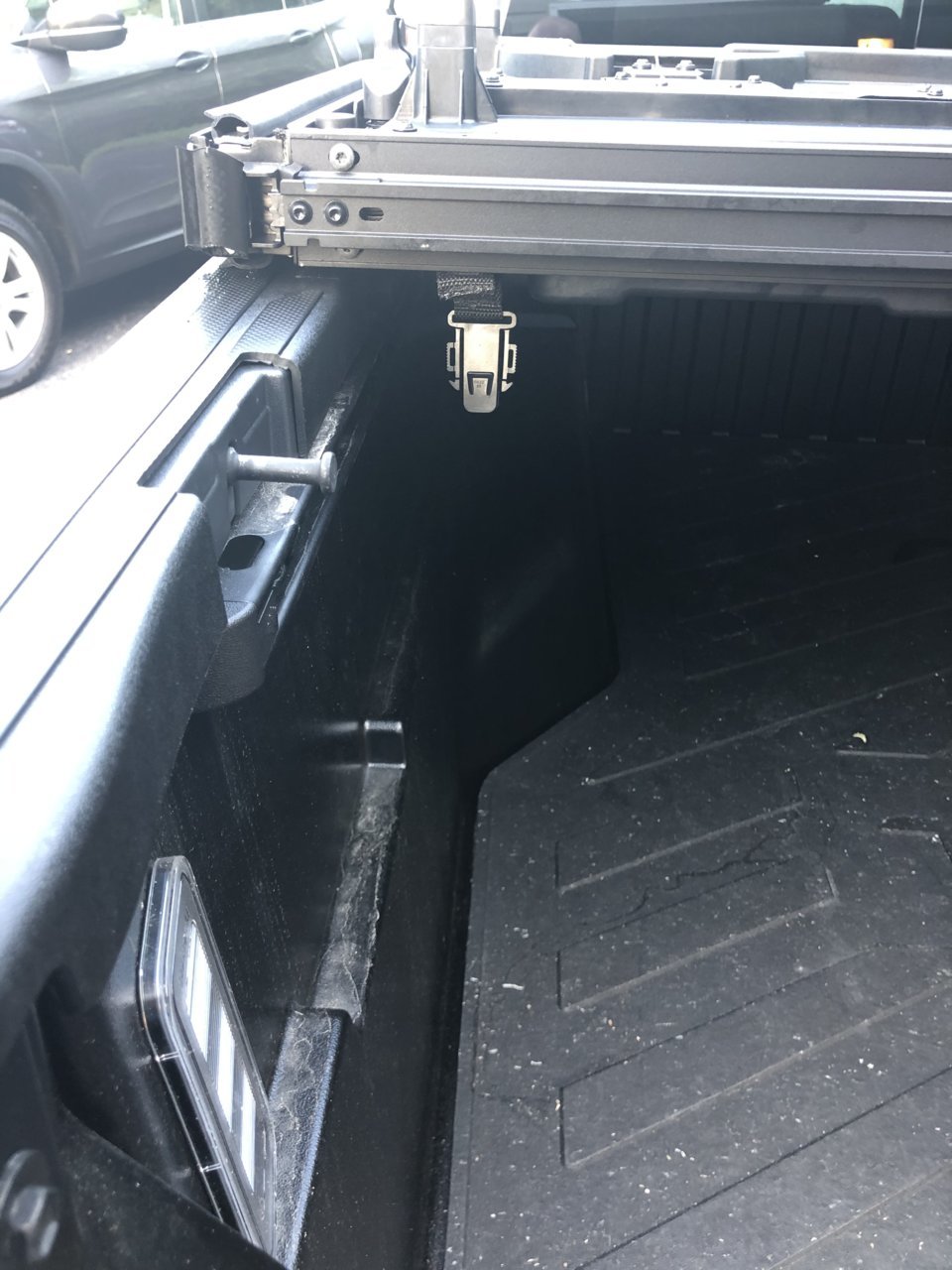

    You swap the bedrail caps as well. It’s exceptionally common. (I have both sets cut and uncut from my swap). Also the bedrail caps have identical part# Printed in the plastic as well, so they simply cut them at the factory.
    EDIT Also you can actually buy them from the dealer, but each piece is priced individually and not as a kit, so it works out to be $1800 in parts for a full cover.
    here is a video of the swap, it literally takes 10 minutes.
    https://youtu.be/5NABLyBTseI

    I've never seen up close how the OEM latches, but the pins or what not look way more secure than the kind that use wires.
    I realized I could break in there in 10 seconds using a coat hanger, but that does not seem likely on the OEM.

    You close the tailgate on the OEM, then close the tonneau and it’s supposed to latch and lock when slammed down. It’s holding at the latch pins.
    With the Extang and several others, there are large internal latches that can’t be pried up. You lock the tonneau first, then close the tailgate. My experience is with the Extang and it’s been extremely secure.

    OEM you can do either way, I actually prefer to close / latch it, then close the tailgate.
    If you know how they work, you can break into any of them with a “slim Jim”. Simply because of where the latch is on the OEM (Tucked up out the way of cargo) would make it a lot fiddler, but none are secure to anyone who can use a slim Jim on a door.
