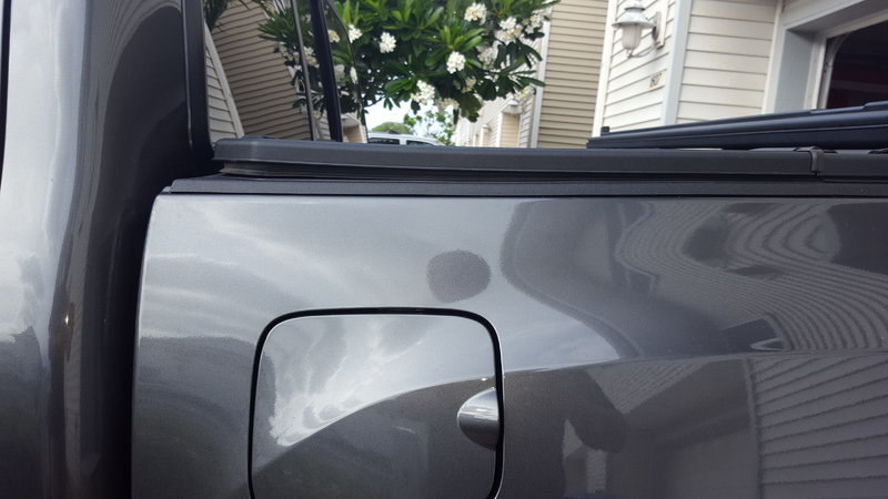

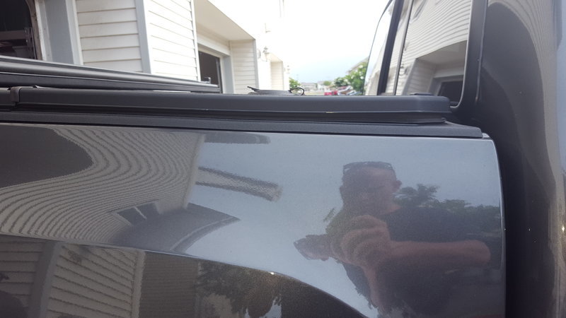

    Yeah still no joy.. I got two clicks on it and still have the bow..

    My bolt side has the same bow.

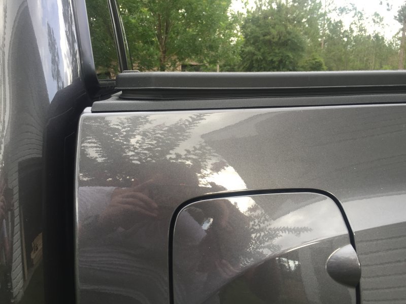

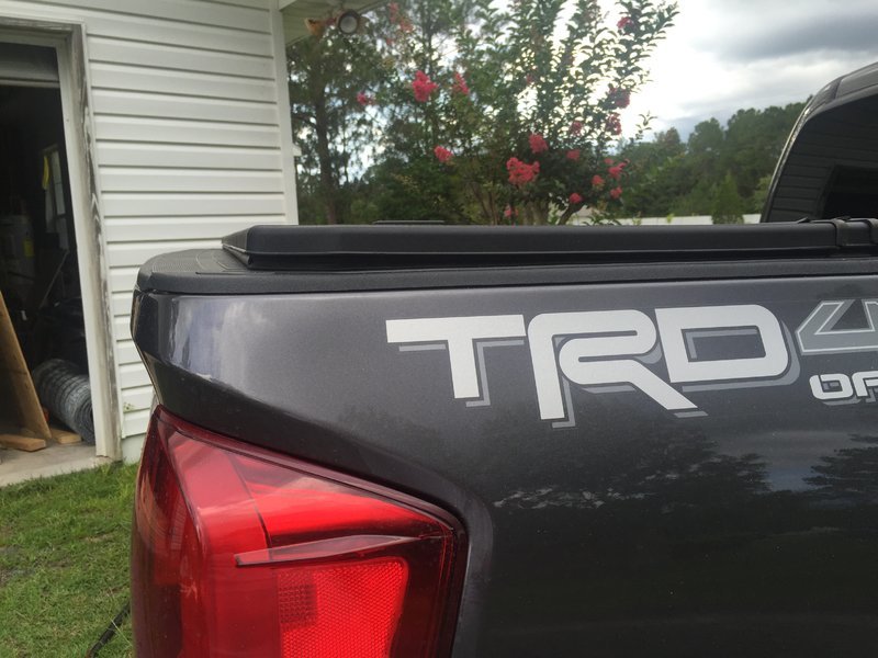

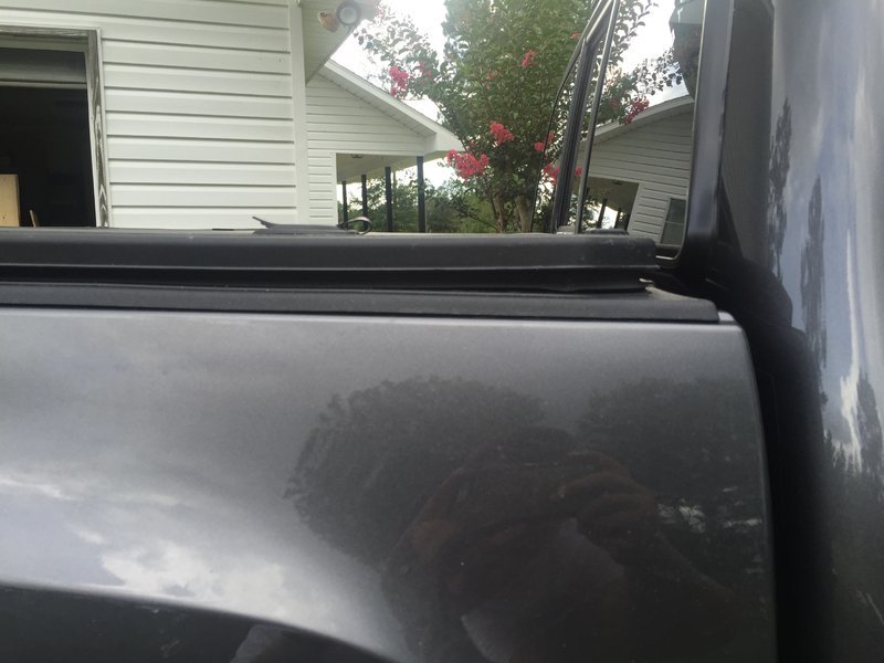

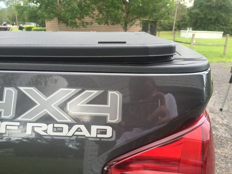

    Thanks bud. I'm not sure but that's worth looking into. Mine has the slightest bow too on bolt corner, but the others are looking pretty good. At least its pretty much bone dry when it rains.
