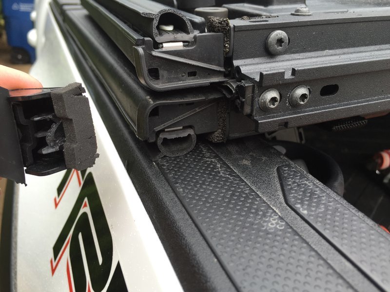

    i flipped open my tonneau cover today and a piece broke off.
    It is a small 1" hinge sealer piece.
    What part # is this?
    Is it covered under warranty? (Have only 1700miles)
    Is it even orderable?
    Please see pictures.
    Im thinking the factory overtightened and weakened the plastic neck. It seems that the 2 screws hold it in place and i would guess it be a replaceable piece

    It was installed from the factory so it should have a warranty. I am not sure how long accessories are covered, but should be at least one year. It should outline it in your paperwork somewhere. The trouble may be in getting that piece due to availability issues, parts guy not knowing exactly how to order it, etc. I sure a few phone calls and a couple days of work they could get one for you though.

    Same thing happened to me - same color truck too! I'm taking mine in for service today. What did they end up doing for you at the dealership?

    The same piece broke on mine at about 400 miles. It was replaced under warranty. It took the dealership a while to figure out the right part (had to re-order twice due to wrong part coming in), but eventually they got it. The broken piece will still work. Just insert it as you are closing the cover. The cover will hold it in place. Work order shows this PN: 6491804010 and the nomenclature is "cap".

    thanks, i gorilla glue'd it for now
