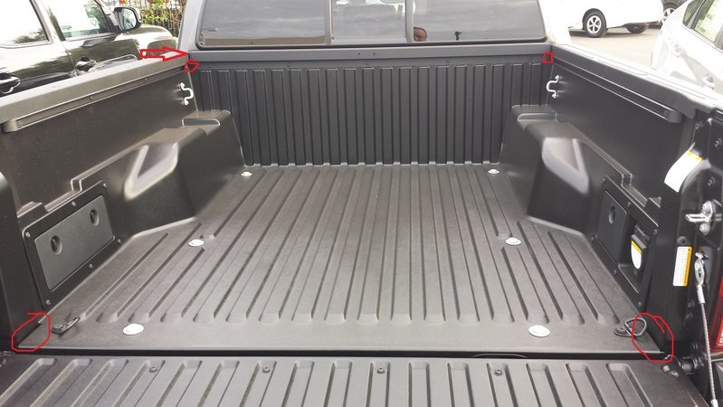

    What I did on mine was during a sunny day, I looked inside to see where I could see light and applied black caulking to seal most of the "cracks". It improved a lot.
    Be careful not to make a mess though! I knew what I was doing so for the average Joe, you can't see where I did it.

    I did double check the cleats and they are out of the way. I am a bit confused about the caulk. Where did you put it? If I caulk around the cover, I will not be able to lift it. I must be misunderstanding something here.o_O

    I did the same caulking process and it remediated all water drips at the front of the bed. I basically pulled a Houdini by getting inside the bed on a sunny day with the tonneau and tailgate closed and then used a black silicon caulk to seal any small opening that had light illuminating thru it. I did not caulk the area where the cover and the bed meet. I then parked the truck at a different angle in order to get the sun shining into the bed from a different angle. My wife was kind enough to open the tailgate and let me out when I completed the caulking.

    Yeah I agree my post was vague! I did not put some around the cover!
    Mostly where I indicated in the picture.
    Where the arrow is, is where the little foam things are installed that came with my Extang Solid Fold 2.0 to seal the opening between the top rail near the cab and the side rails. It's a big opening and water comes in easily in this spot.
    It's a cover that is identical to the Toyota one.
