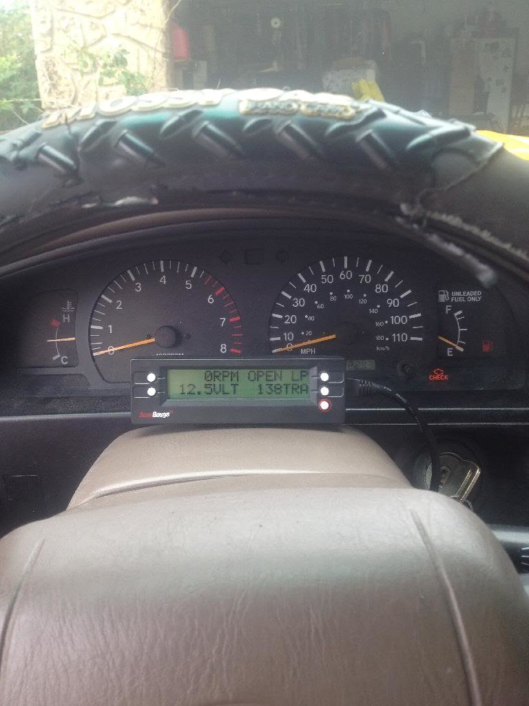

    Not a problem. Just personal preference, but I also have a Scanguage II to monitor my trans temp

    A9C5ED9E-38D4-4661-8111-26044A9EA200_zps_3488484b2cb43f14eda90f374b02c0db05642786.jpg
    If I'm not mistaken, there is a code for your year truck. Scanguage didn't have the x-code for my truck, but somebody figured it out
