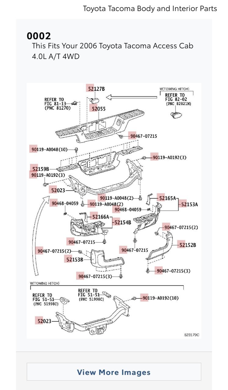

    I have called multiple dealerships and none of them seem to be able to find the towing package hitch. The attached image shows the hitch at the bottom, part of the part number is there but not all of it. When I click on the part number it does not bring it up, like something is wrong with the website. EFC3B4F5-430A-4986-BE96-04089917590E.jpg

    that looks like the third gen hitch.
    the 2nd gen is straighter.

    2nd.

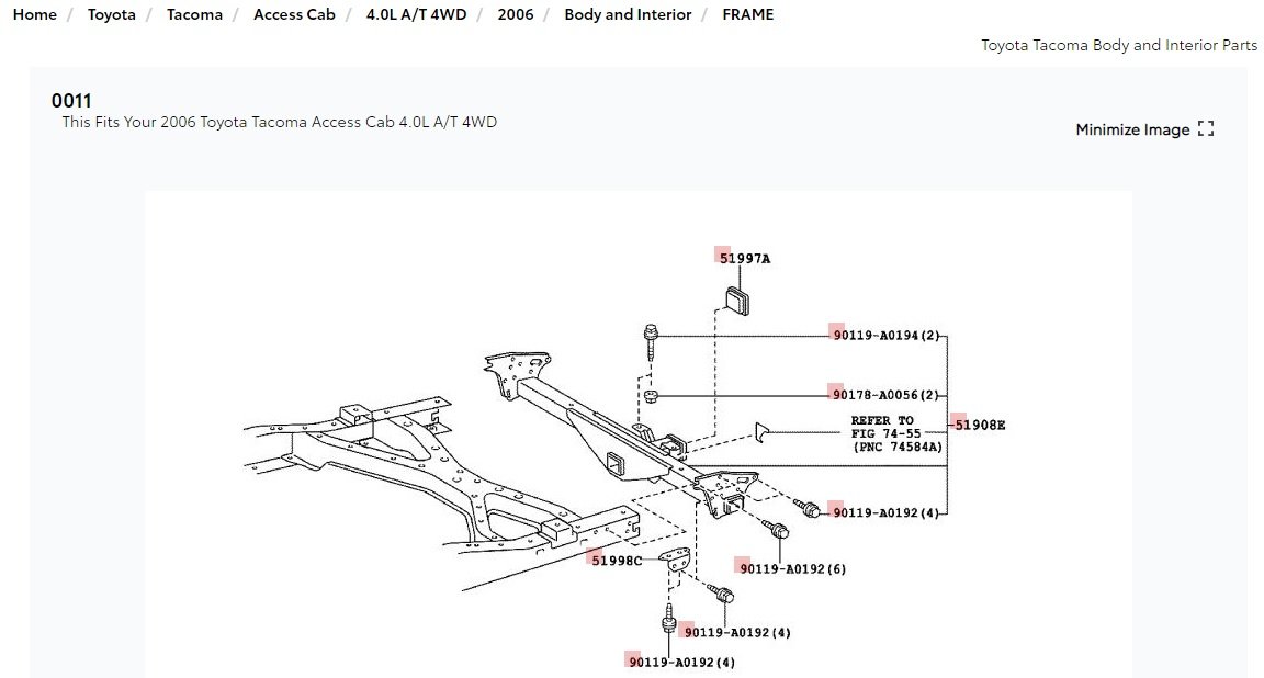

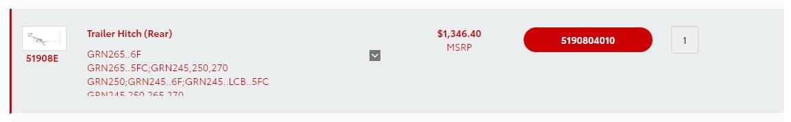

    The one you show there in your attached screenshot is not the correct one. Here is the class IV one you're looking for and unfortunately it's not cheap if purchasing new.
