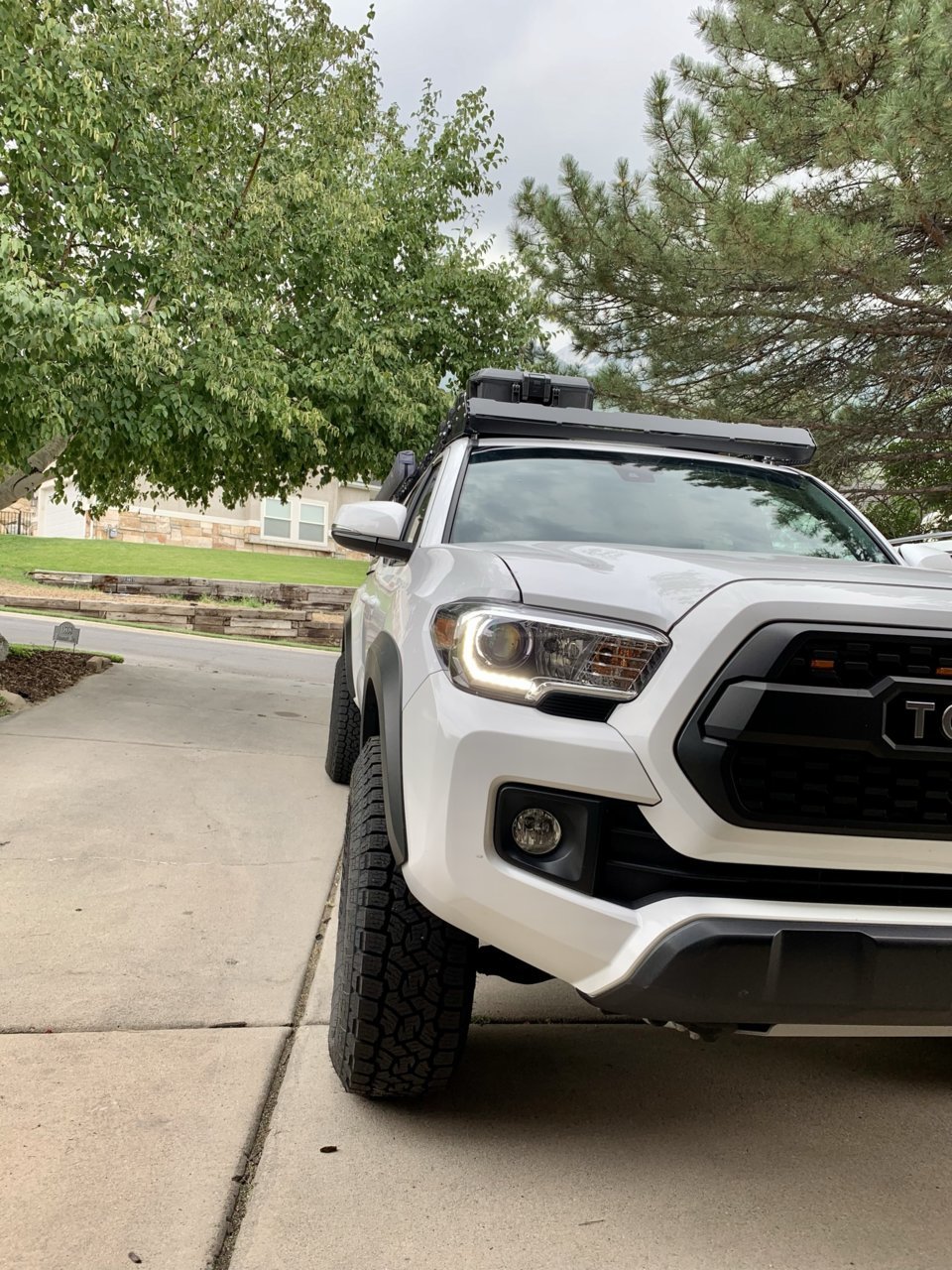

    They probably mean less positive offset. I don’t know about 2014 Tacoma but my 2018 had +25 offset. By going less positive (or going negative in my case) the wheel sticks out more.
