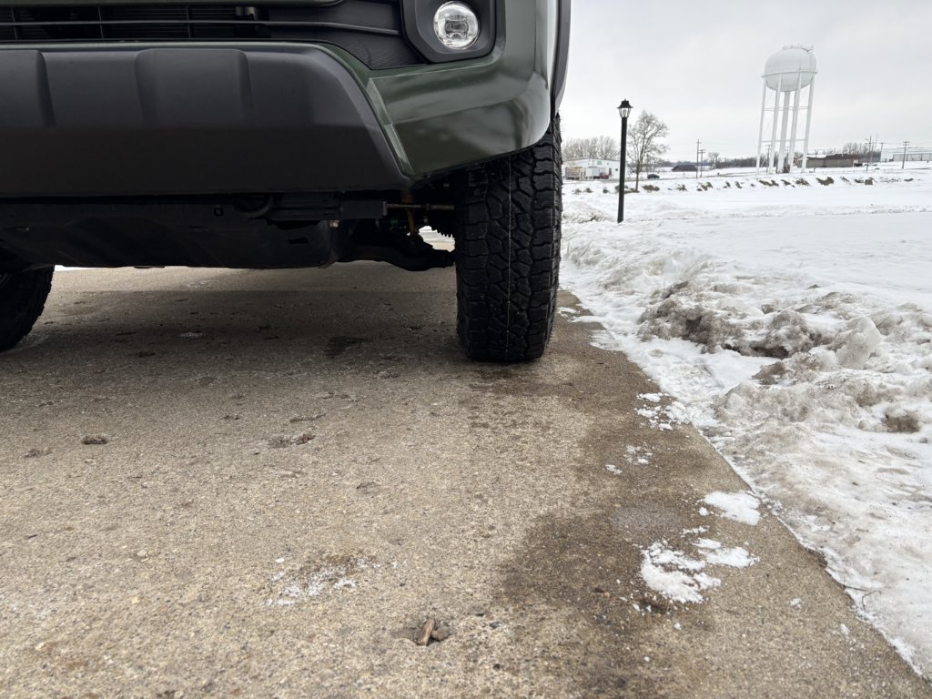

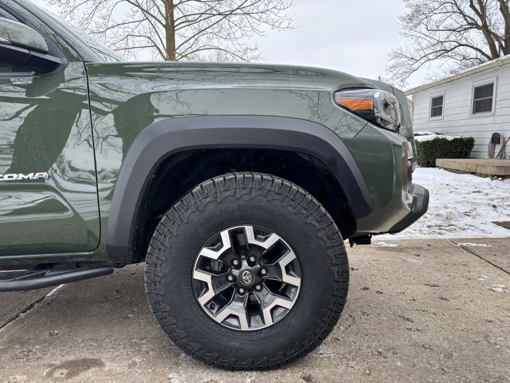

    Less than 5k so nothing but small things like console tray and such
