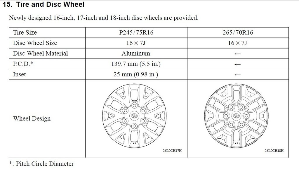

    Alright Fellas: Hopefully someone can figure this one out. So i have a 2016 Tacoma 4 door long bed TRD. Came with 265/7016 Tires. Dealer told me the wheel is a 16x7 (LesSchwab said 16x10...morons). I'm hoping someone can verify the width of the wheel, the offset and backspacing.
    I'm wanting to go with an 18" wheel, and throw on some Duratracs that measure close to the factory tire specs. Probably a 265/60r18.
    Cheers TW

    0, offset/4.5 backspacing, I'm about 90% sure on this.

    Well snap that's 90% closer than the toyota dealership could get me haha
    thanks for the reply.

    Thank you very much for the specs!!
